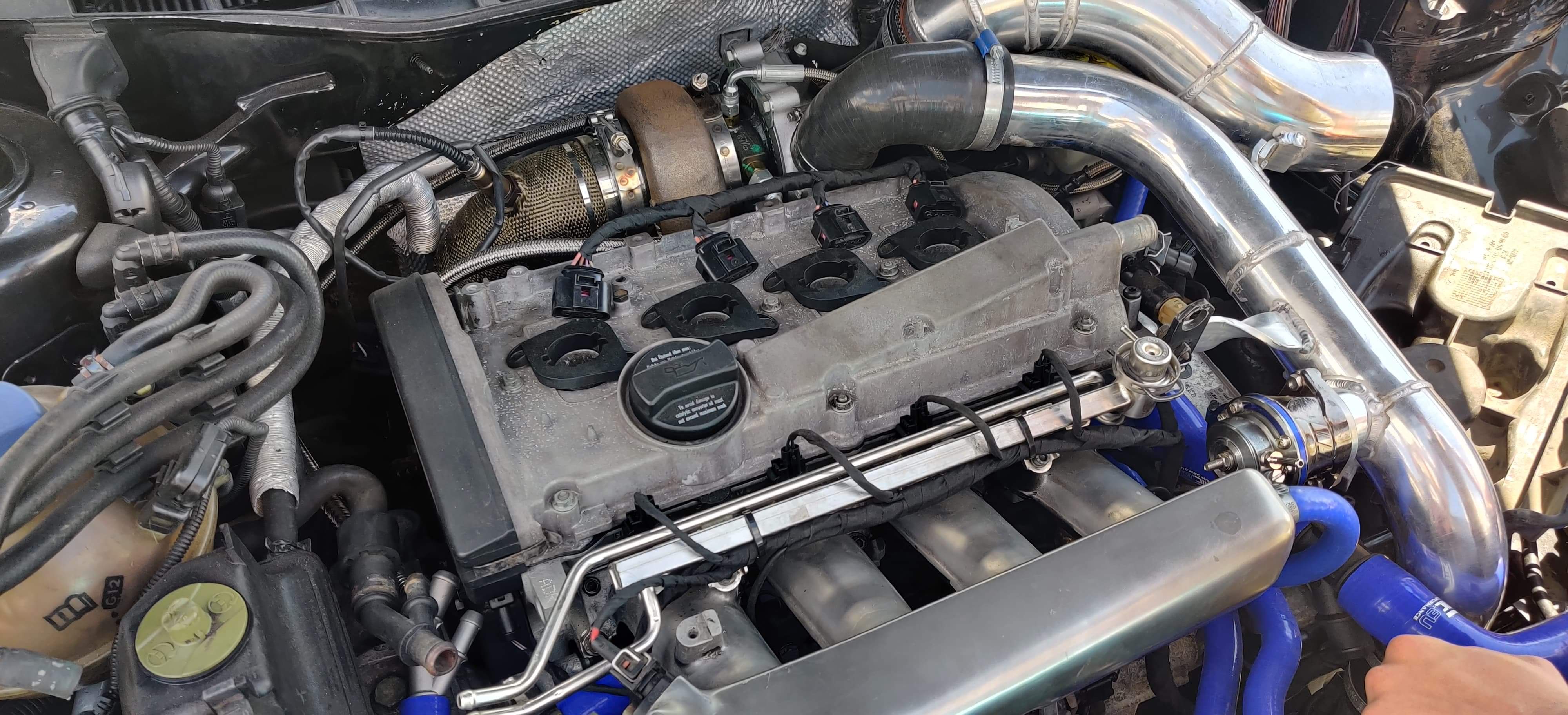

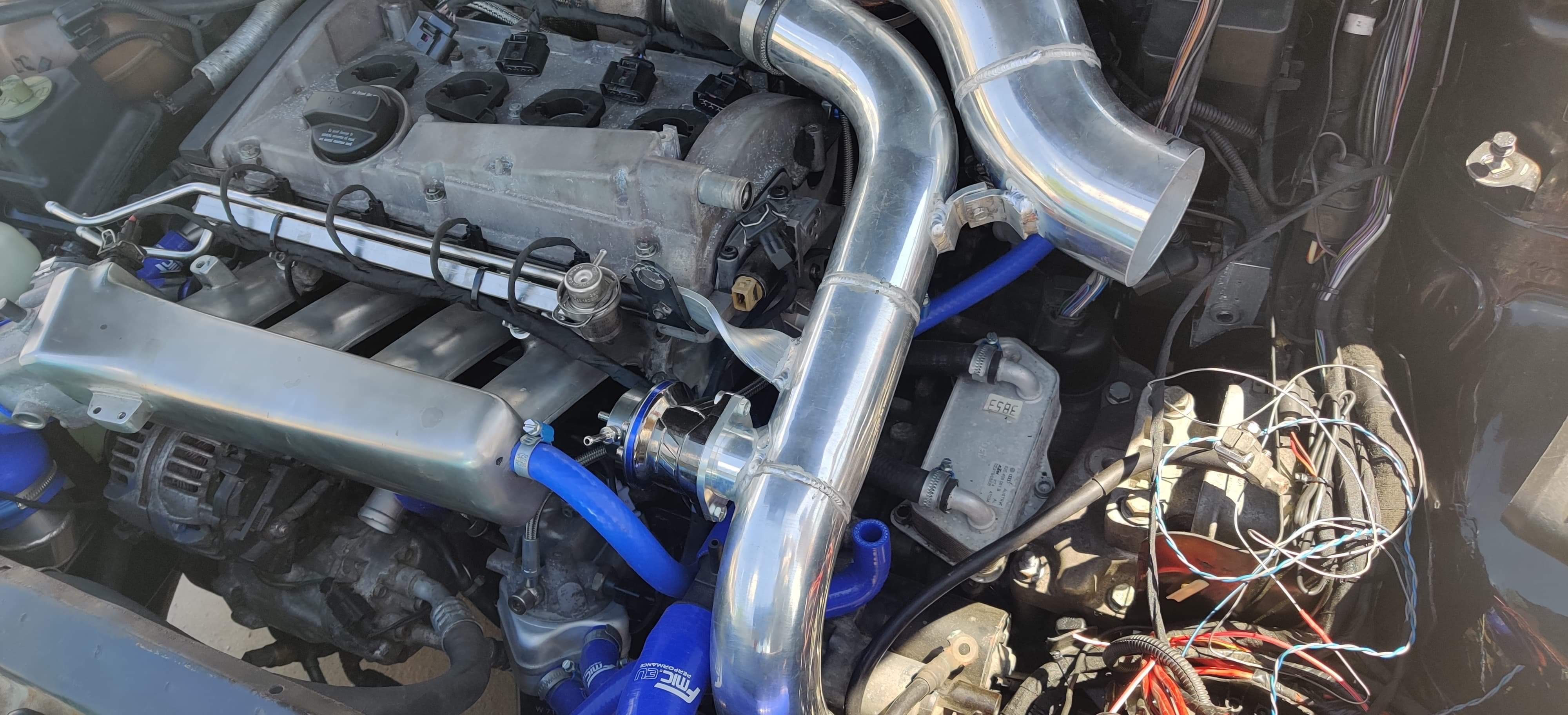

Silicone water hoses
SWIRL POT 1,3L WITH SINGLE PUMP SLOT
Round muffler Fmic Pro 350mm 76/76mm
V-BAND Racespec 76mm (3") KIT
Blow off Greddy FV style
Lambda oxygen sensor mounting bush

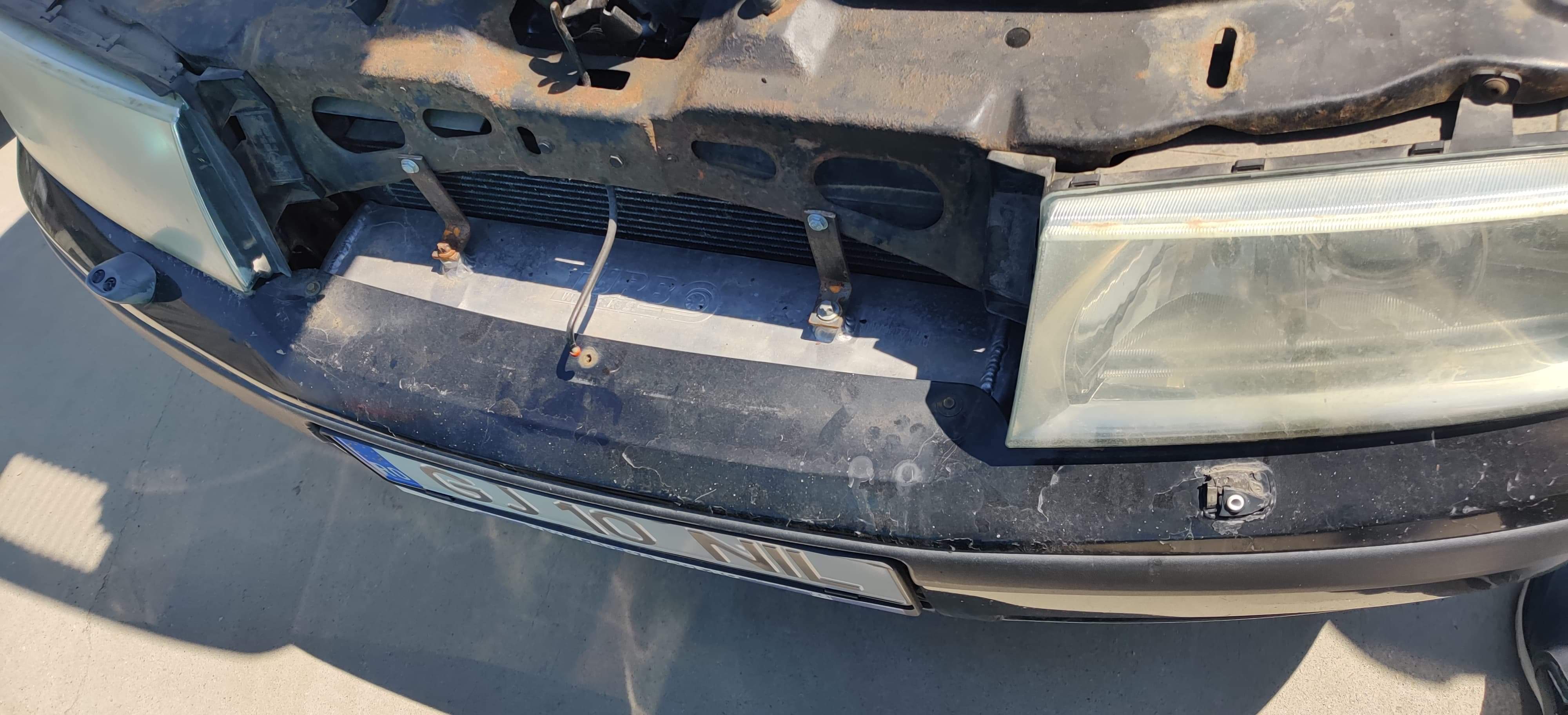

Intercooler universal 600x300x100 100mm - in and out
MAC Valve for boost control
Turbo Garrett G25-550, 0.92 AR
DSG Gearbox DQ250 4x4
Supertech - Vale springs and retainers
Supertech intake valves
Supertech Exhaust valves inconel
Pistoane Wiseco, CR 8.5:1, 82mm bore +  Arias Pistons Rods
IGNITRON ECU STANDALONE
ID1050X Injectors
Bigport head and intake manifold with turbo cams
Mid and Final muffler FMIC.EU with full stainless exhaust
ARP everywhere needed :D
Turbosmart wastegate
Bosch 044 fuel pump in the swirlpot
