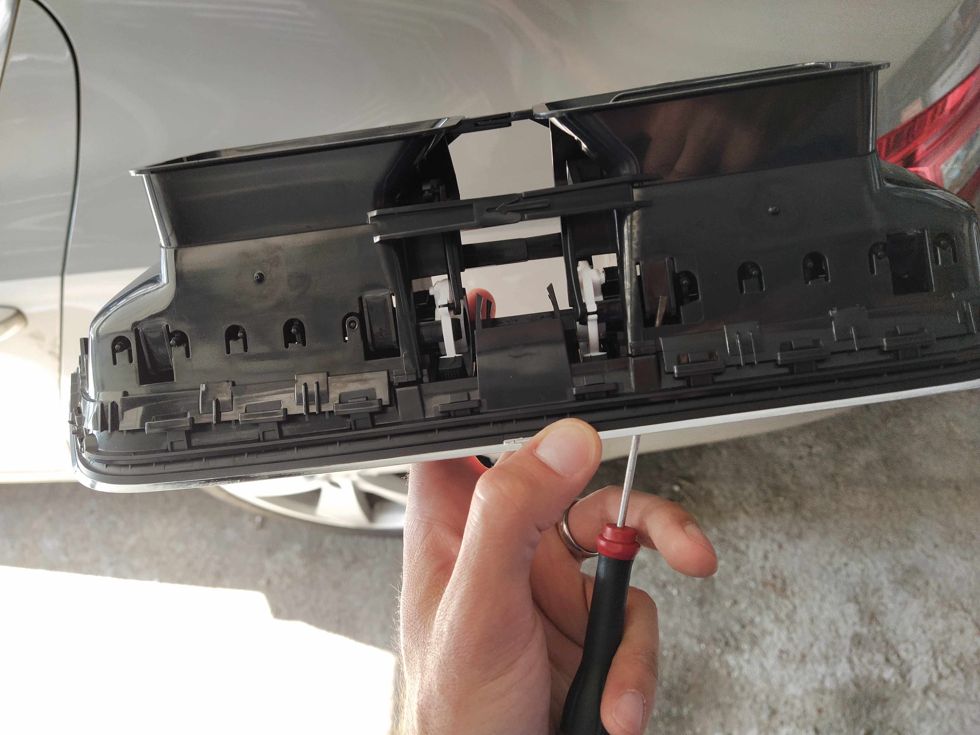

Has anyone replaced the chrome trim around this vent or does the whole vent need to be replaced. Of course no one has done it but its damaged anyway. If the vent has to be removed any ideas on removing it

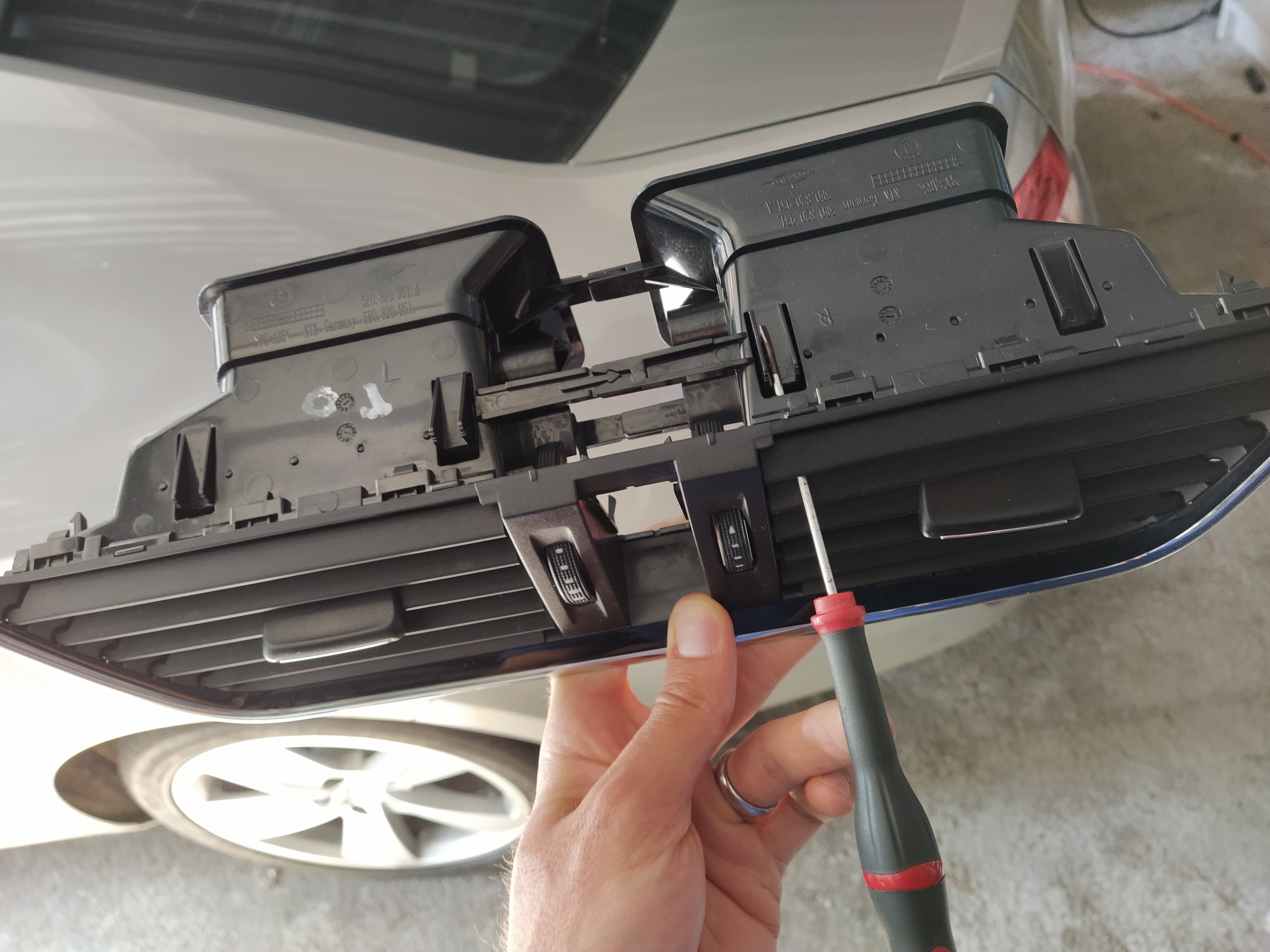

The whole vent has to be removed. I did it. There are 8 tabs (4 top / 4 bottom) you have to pry from the vent and then just pull.
Thanks Woland really ueful information much appreciated
