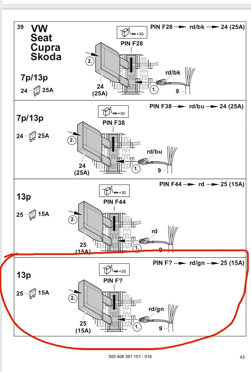

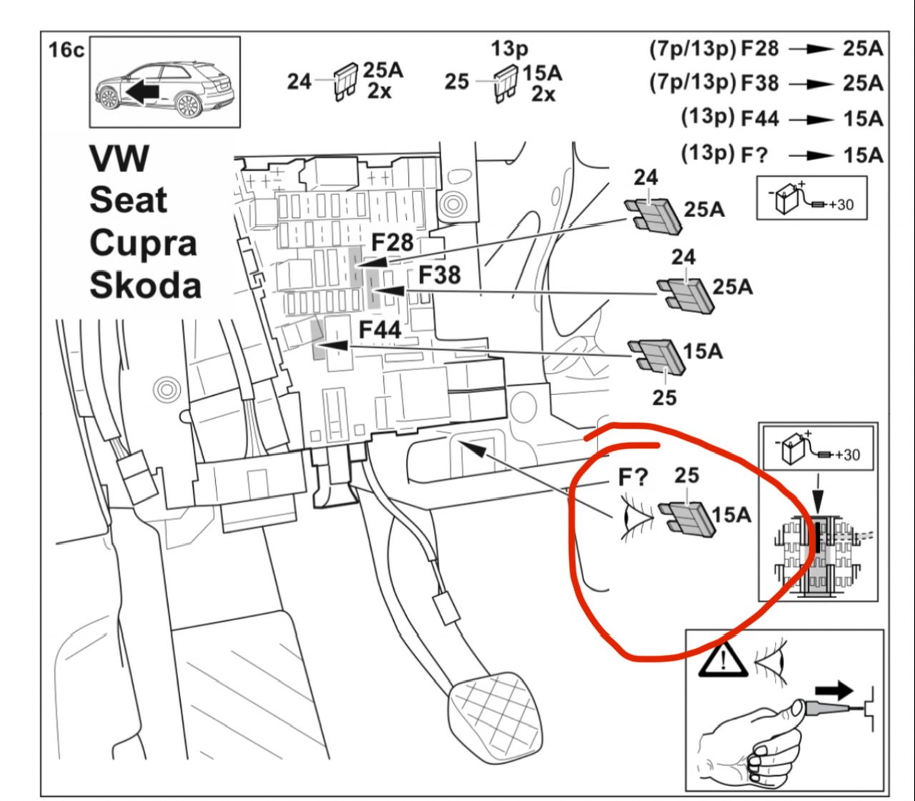

Hi, i have fitted a westfalia tow bar with dedicated wiring kit (305 408 300 113) on my Octavia rs 2017. Without prep.
Connected to the bcm. At the fuse box, im abit confused. Where do i connect F marked with a questionmark? From my understanding its continuous plus.
Thanks!

In a place where you don,t have a fuse - which have fabric wire behind + yours rd/gn
Ok, thank you.
Manual says +30. Is that terminal 30 live feed?
Do i need to measure with a multimeter so i dont connect it to a terminal 15 switched?
Im new to all this, and really appreciate the help!
