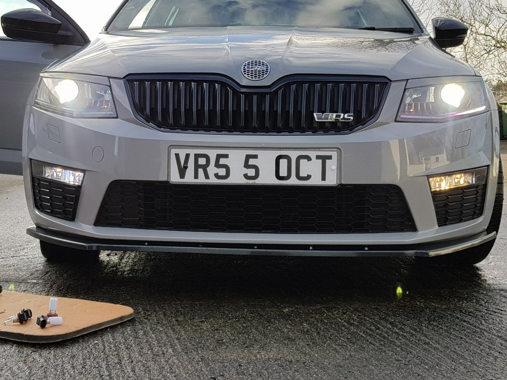

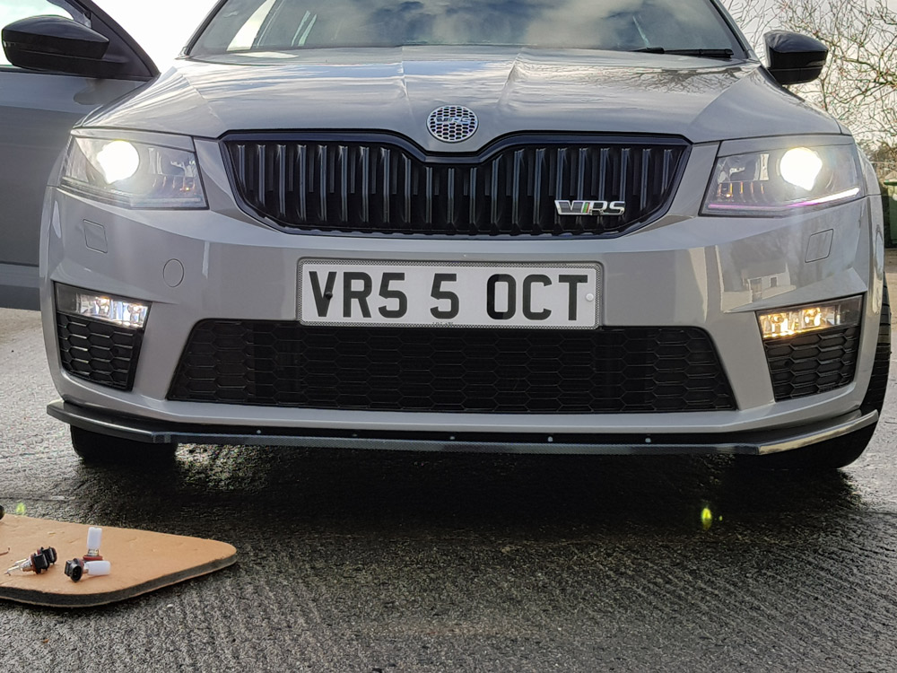

this was a 15 min job to replace the yellow standard fogs. Ive got big hands and it was not difficult at all. I bought some H8s and dremelled the larger tab down to the same size as the H16s and they fit like a glove. also replaced the side lights with canbus friendly leds. in this pic you can see the xenons on the left. and stock on the right.
