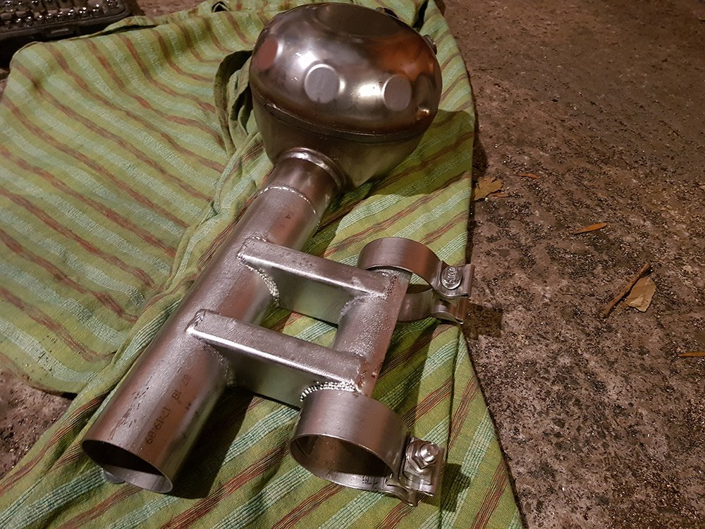

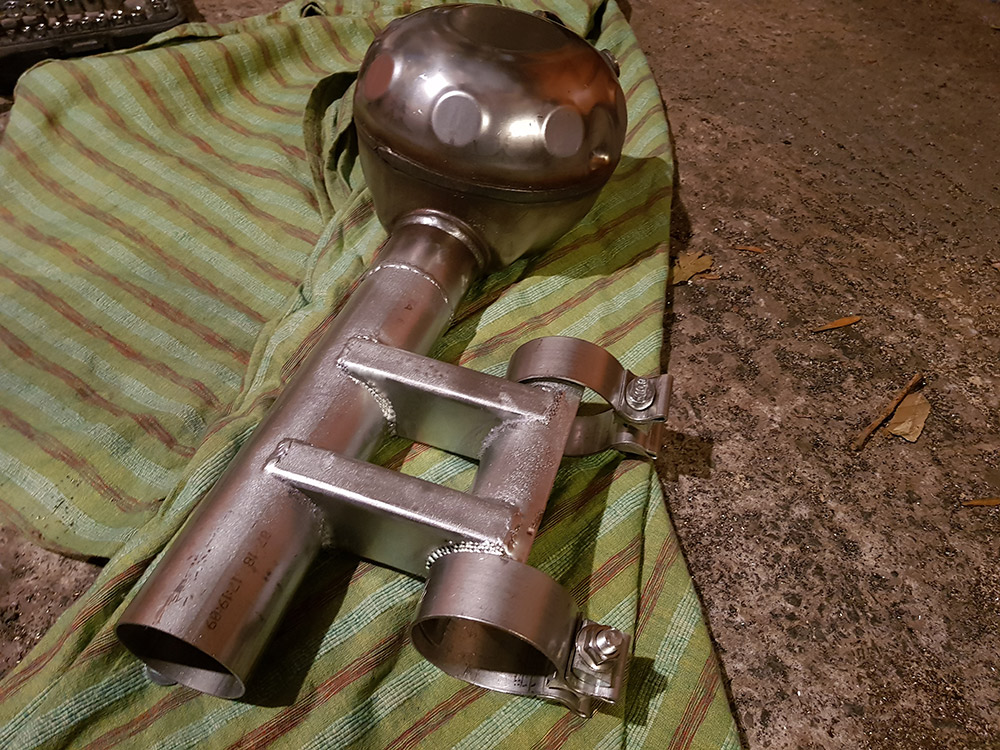

eberspacher active sound unit with fabricated bracket
I broke out the chop saw and welder to fabricate some hanger brackets for the Eberspacher active sound, it's just a couple of pieces of 3mm 1 x 2 and welded to cuts from the old exhaust. It'll will be held on to the main section of the exhaust before the back boxes with heavy duty band clamps and a new hanger welded to the chassis. The unit weighs 7 KGs so will need more support
