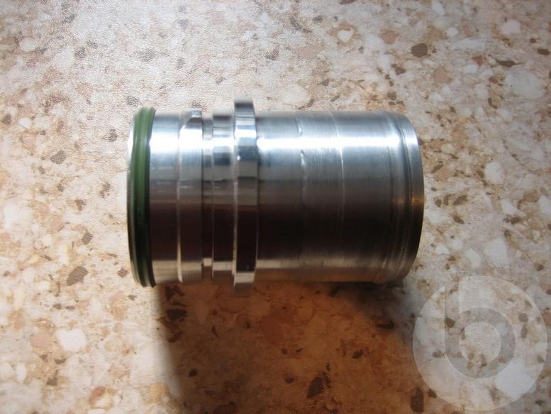

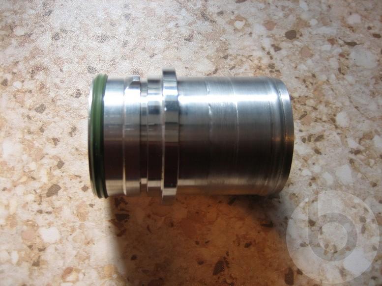

SFS don't actually make their bayonet fittings long enough to accept Mikalor clamps with a 20mm width. Also I feel that by making the bayonet fitting longer you add some extra support to the silicone bend you attach. Above is the original fitting re-worked.
