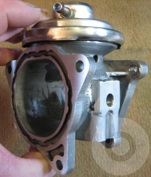

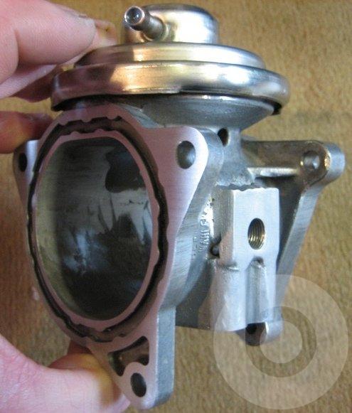

I got all the welding on the EGR carried out by a really good metal fabricator. Please be aware that cast aluminium uses the poorest quality of metal, and when welded oozes out all sorts of rubbish, leaving you with a poor quality pitted finish. I used "JB Weld" to cover all the pitted areas, and block up the vacuum inlet nozzle. Finally a bit more wet and dry sanding left me with a reasonably good finish.
