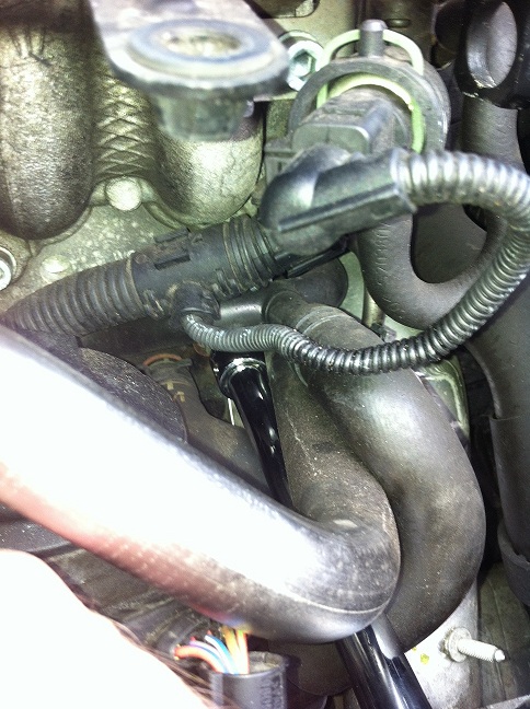

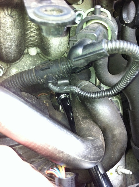

Location of bolt mentioned earlier, use a good socket set!!
Its a pain in the arse to get this back in so be sure you are confident doing this in the first place, i found packing the socket out with tissue and then a bit of green tape to hold the bolt in place worked well.
