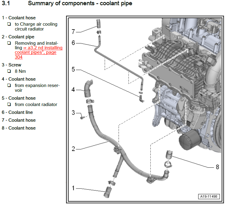

  2. WilliamB replied to WilliamB's topic in Skoda Yeti
    Thanks Urrell, that really helpful, although I confess that I could not identify the part from the schematics you linked to. In the end we got the part number from the part itself (I should have thought to remove the broken bit sooner, oh well 😏). For anyone interested the part number taken from the unit is: VW 04E121064E >PPS< TEKLAS BG TE9
  3. WilliamB posted a topic in Skoda Yeti
    Hi All Please help me identiy a par number of where I can buy this part for a Skoda Yeti 2016 DSG 1.2. I need to identify the coolant line 6 in this image. Many thanks
