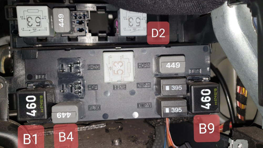

Quick update. No further forward I'm afraid. Charged battery and refitted. Removed lower dash panel to expose relays: Onboard power supply control unit (lower relays) Additional relay holder (upper relays) Rechecked every fuse (with and without voltage applied) and all still seem to be fine with each having a good connection. Attempted to check what I believe are the main relays hosted in the lower power supply control unit. B1 (KL15) Terminal 15 voltage supply relay B4 (KL30) Terminal 30 voltage supply relay B9 (KL75) X contact relief relay The upper relays D2 Terminal 50 voltage supply relay Need to determine what this powers. The switched terminals of this relay didn't measure battery voltage (12.7v) Instead measured < 1 volt. To do check where the source of the supply voltage for this relay Suspect B4 (KL30) relay Each relay has been removed and tested (relay operates) and each can be felt to actuate when the ignition key is in the first position. Additionally done a scan with VCDS which shows (perhaps unsurprisingly) malfunction in almost all modules (extract attached). Main points from the scan are that comms with the immobiliser has failed. 25-Immobilizer -- Status: Cannot be reached 1100 Which I presume then leads on to the engine module reporting that the engine was prevented from starting by the immobiliser. Any thoughts on where I can go from here? 005488 - Engine Start Blocked by Immobilizer P1570 - 000 - - MIL ON Freeze Frame: Fault Status: 11110000 Fault Priority: 1 Fault Frequency: 1 Reset counter: 255 Mileage: 0 km Time Indication: 0 Freeze Frame: RPM: 966 /min Speed: 0.0 km/h Load: 0.0 % Voltage: 11.63 V Bin. Bits: 11101100 Bin. Bits: 11000000 (no units): 33.0 Seems like the issue is power related or perhaps it's the instrument panel itself (given that the LCD was initially showing a strange pattern). ..or perhaps a poor connection or a bad earth? I've attached a copy of the VCDS scan log if someone wouldn't mind casting a eye over it in case there is something to be gleaned from it. There is mention of Terminal 30 low voltage. VCDS-ScanLog-2024-02-27.txt -

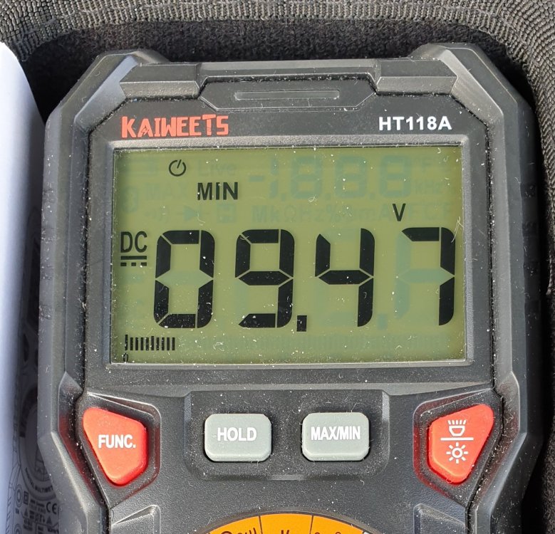

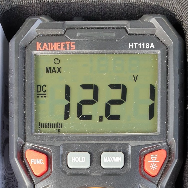

Thanks again for the replies. Just been out to the car. First thing was to check the initial battery voltage which read 12.21v (which seems low). Attempted to start the car (started and stopped) and recorded the lowest cranking voltage which was 09.47v. Battery is not that old (<2 years) but will put it on charge (CTEK) to see if it makes any difference or is that not worth persuing? -

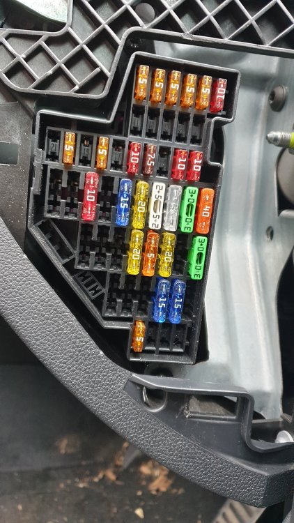

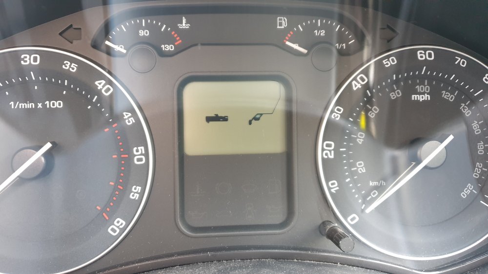

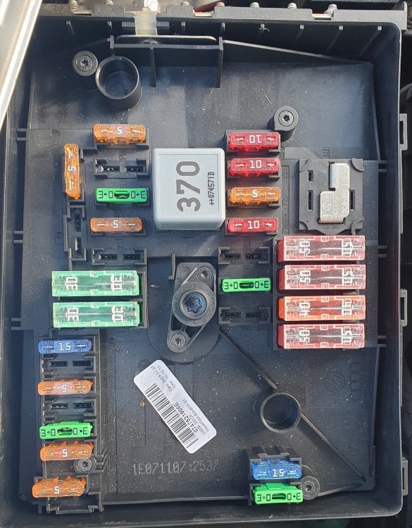

Needed to add the under bonnet fuse box photo separately... Also once the battery was reconnected the LCD display is now blank. -
Afternoon Hoping for some advice. Skoda Octavia Mk2 Scout TDi 2008. Drove the car yesterday evening. Parked on the drive as usual. Went to the car this afternoon and no dashboard lights. Car will start briefly then stops. Can hear the fuel pump just before turning the key. Checked all fuses in the dash and under the bonnet and all good. Disconnected the battery and left 10 minutes. Reconnected and still the same. Attached photo of the LCD display before disconnecting the battery and photo of the fuse boxes. Any further advice on what additional checks I can make to diagnose the issue? Cheers
