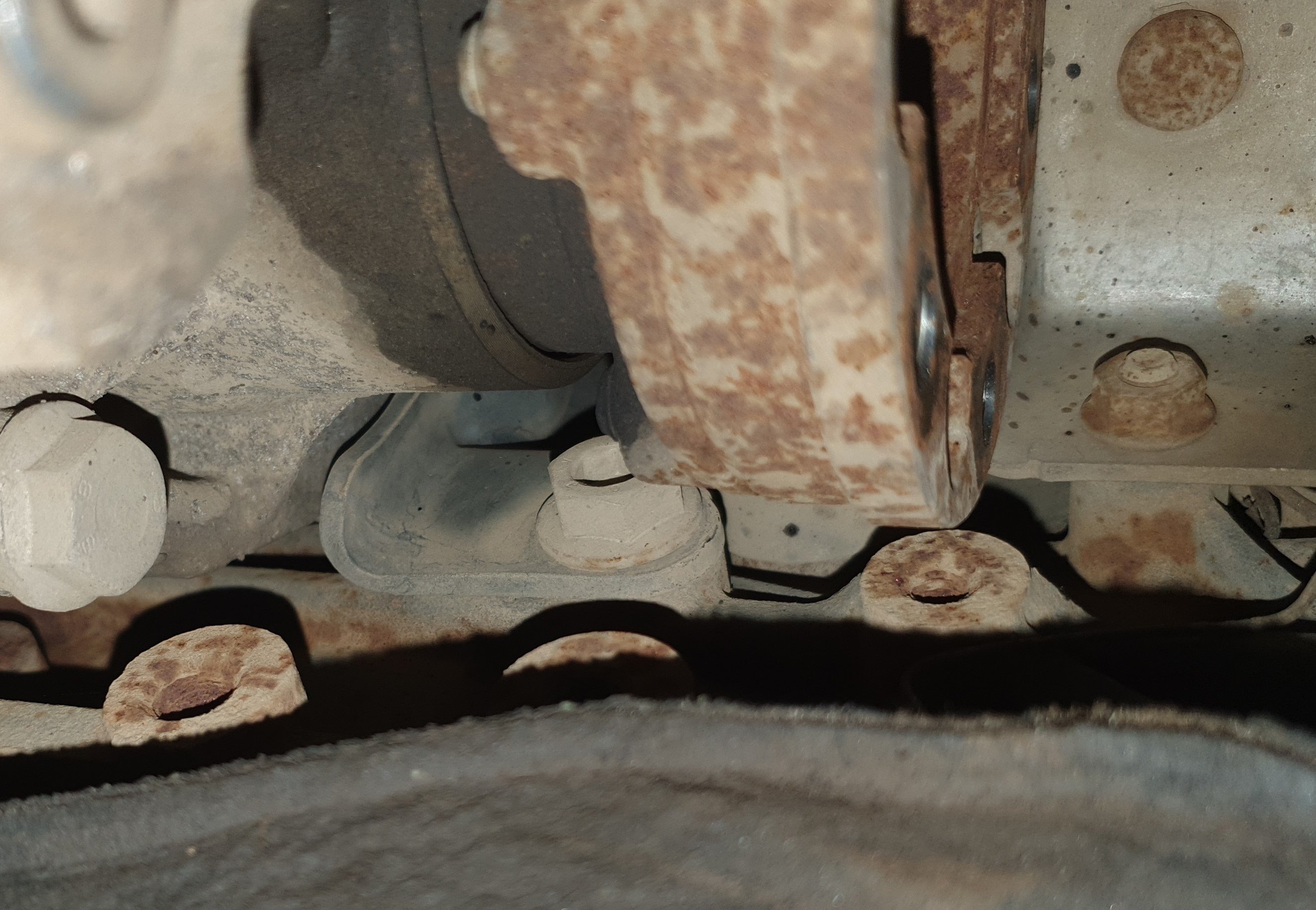

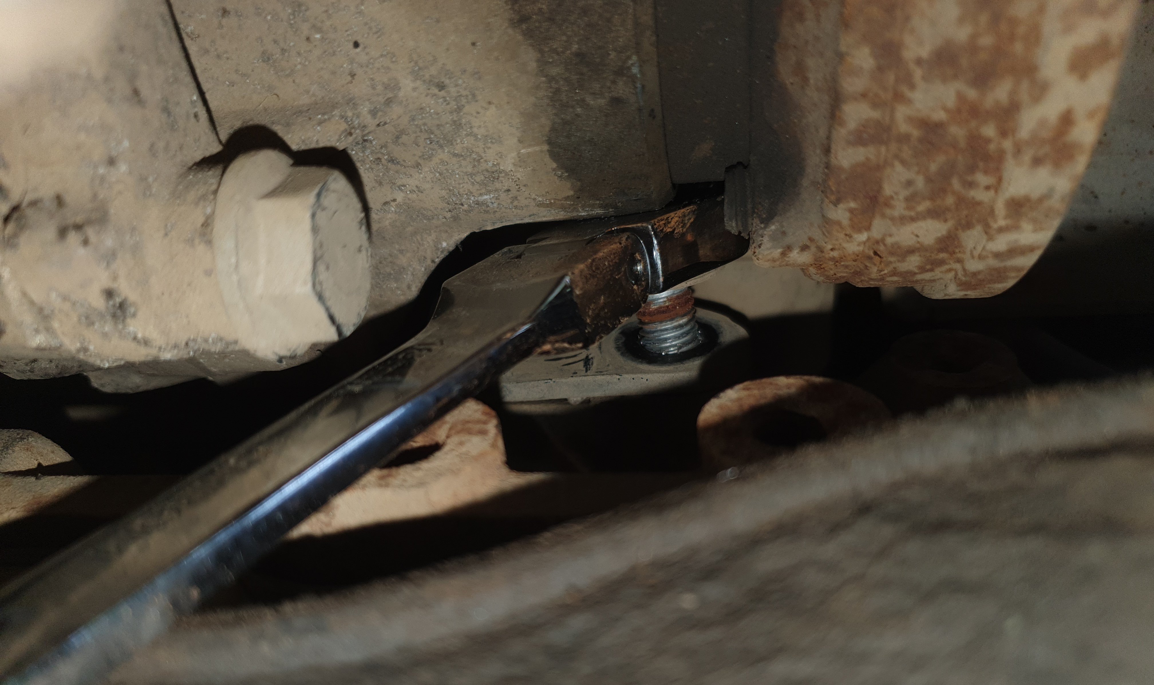

  9. I only managed to get back under the car today. And only for an hour or so, but it was productive. After some more levering I decided there was definitely something I had not undone. I got an 8mm hex and took off the surround sheet of metal above the flange (picture 1). I hadn't tried it yet as it appeared to only be attached to the transfer box. Once off it revealed a super secret bracket. 2x 16mm bolts (pic 2) later and the gearbox is swinging with ease, ready to drop. Then the alarm went off to get the kid from school and my time had run out. I'll get that gearbox dropped at the weekend and start on the actual flywheel. Then I'll try and remember how it all goes back together. I'll watch some videos on alignment before I do the final tighten on the sub frame bolts, and see if I can get ahead of any alignment issues. I'll also look in to those prop shaft couplers while I'm at it. Is there anything else that is worth looking over while I'm £1k of labour deep on this thing?

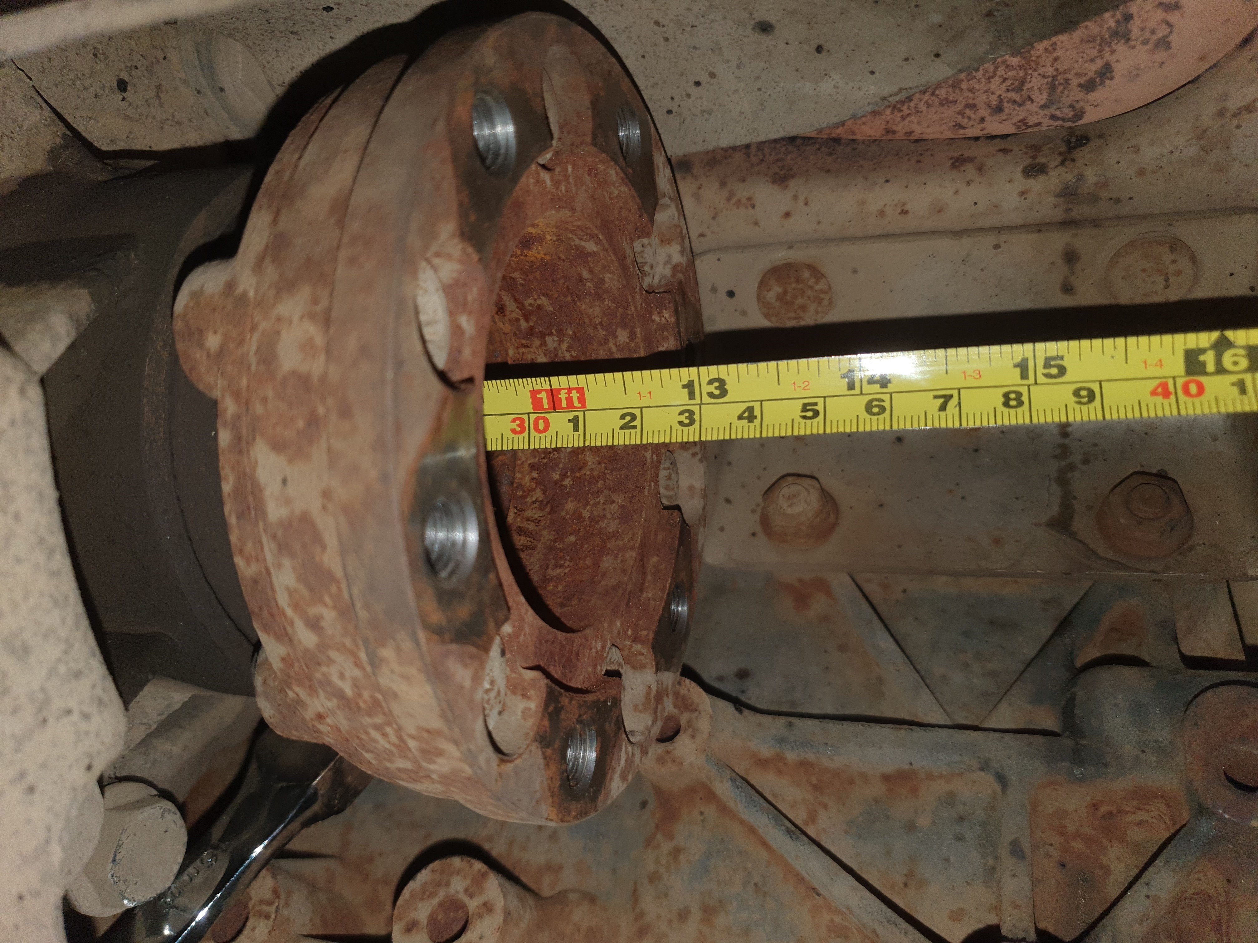

  13. So I think I found the bolt. I'd just bought a flexible head ratchet spanner set, so I thought I had just the tool for the job. It started undoing fairly easily but was longer than I had expected. I then realised I'd backed my self in to a corner, in that I cant get the spanner off, and I cant reverse the ratchet as it's only one way and I seem to have undone it as far as the space allows. I thought to remove the flange to get more room. The whole in the middle though is over 30cm and seems to go right through to the gearbox. I don't own anything remotely long enough to get down there, if that's even how you get the flange off. I've got some pictures. Any further advice? I think my next step would be to try and cut the bolt if the flange isn't easily removed. I suspect I've damaged the thread anyway.
