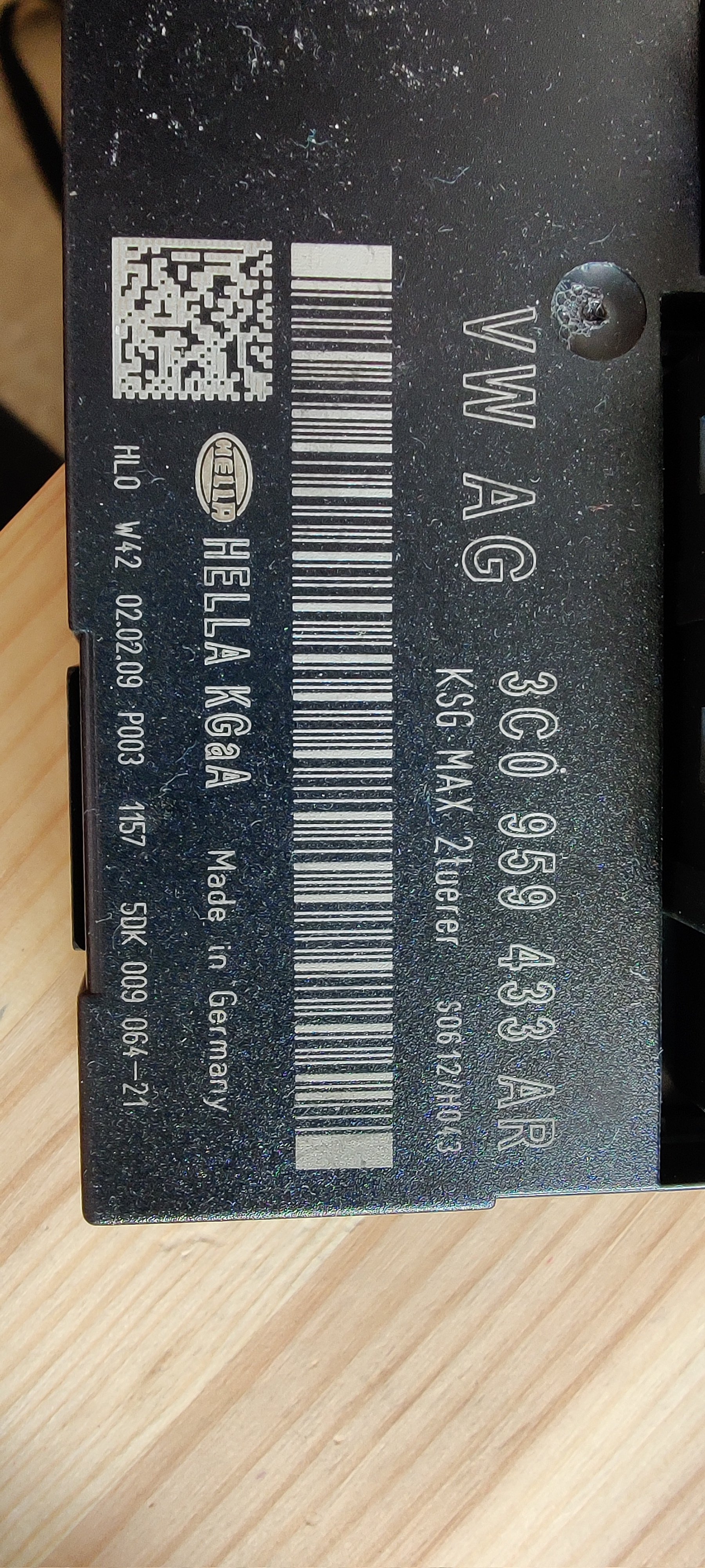

Over the weekend I've tried to replace my midline/lowline 1K0 959 433 AK Comfort module with one a Highline one, 3C0959433AR. My Octy is the semi-poverty Ambiente spec, so I am upgrading mainly at the moment to get the addition menus in the maxidot EddieNL has retrofitted for me. But this will be the backbone for some more retrofits I could do, like front fogs etc etc. I'm using ODBeleven to change the coding of the modules.
I had fitted in the module after disconnecting the battery. Once connected, everything seems fine. It was only when I tried to sync the remote key back up that I had an issue. I tried using the Adaption method and the method mentioned in the manual, but both didn't sync my key. I also noticed, that despite coding the module to be a 4 door, it didn't lock the rear 2 doors or show them as being open on the maxidot. I tried a different coding for a 2006MY estate from a thread on here, but this produced a similar result. It may well be a coding issue, but do the module come in a 2 door and 4 door varieties, and have I unknowingly bought a 2 door module?
