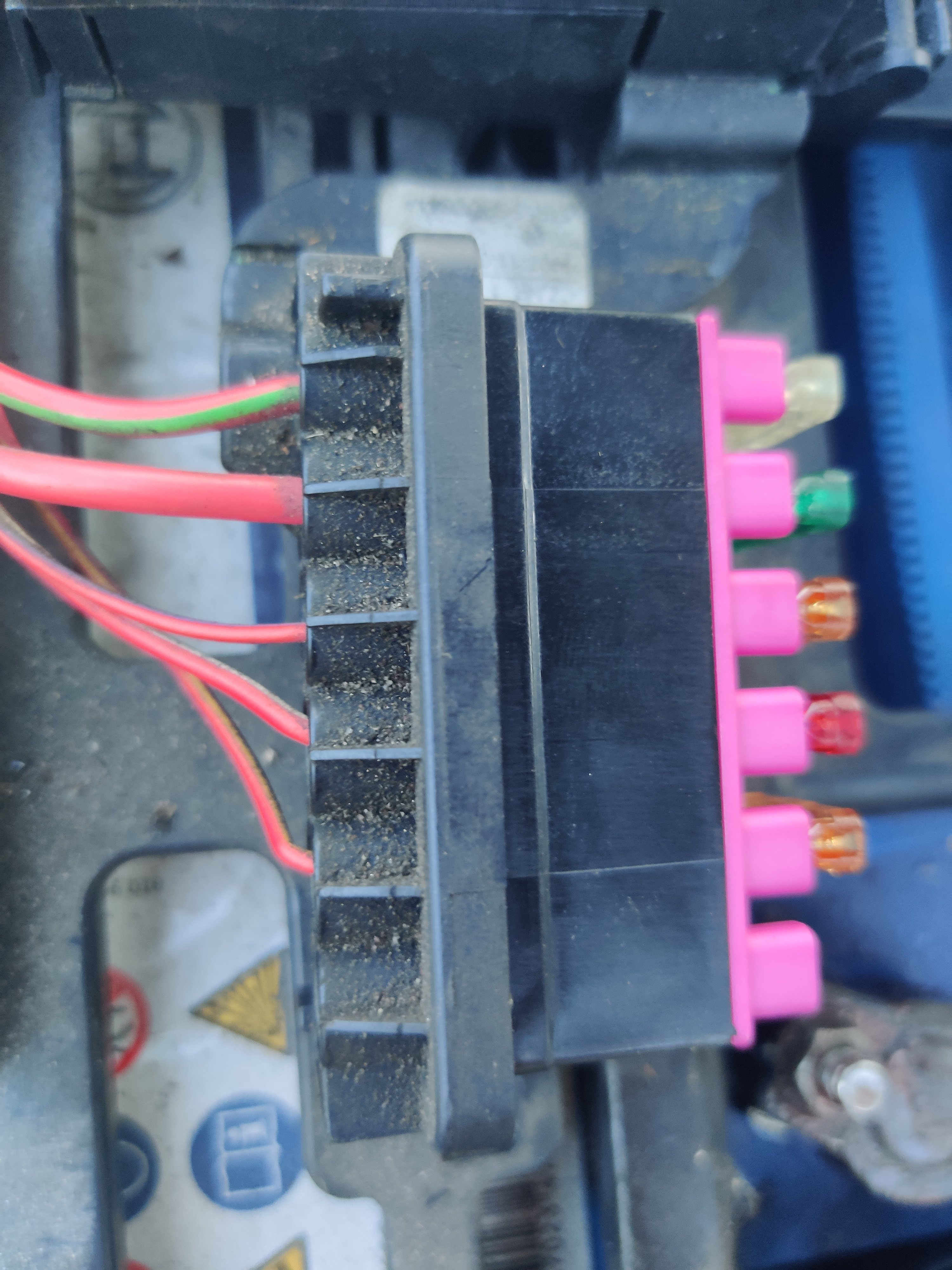

I switched the broken fuse with a 40A from Halfords, warning lights are still on, so I guess another trip to the friendly VCDS person is in order? The product code for the Halfords part was FUSE 298, which is apparently the same as FUSE 133. They are in the process of changing product codes. FYI -

Rain has interfered with plans today, but I managed to get out during a break and loosened the nuts on that strip fuse. It is definitely in two parts! Will any VW 40A strip fuse work as a replacement? -

Maybe the strip on the one with the red and green does have a crack in it. I'll have to check in the morning. -

This is the one in position 6 on the battery. Are there any more that should be checked. @TMB HatBoyHarvey on YT makes it look easy, but maybe he's already replaced the rivets on his door. -

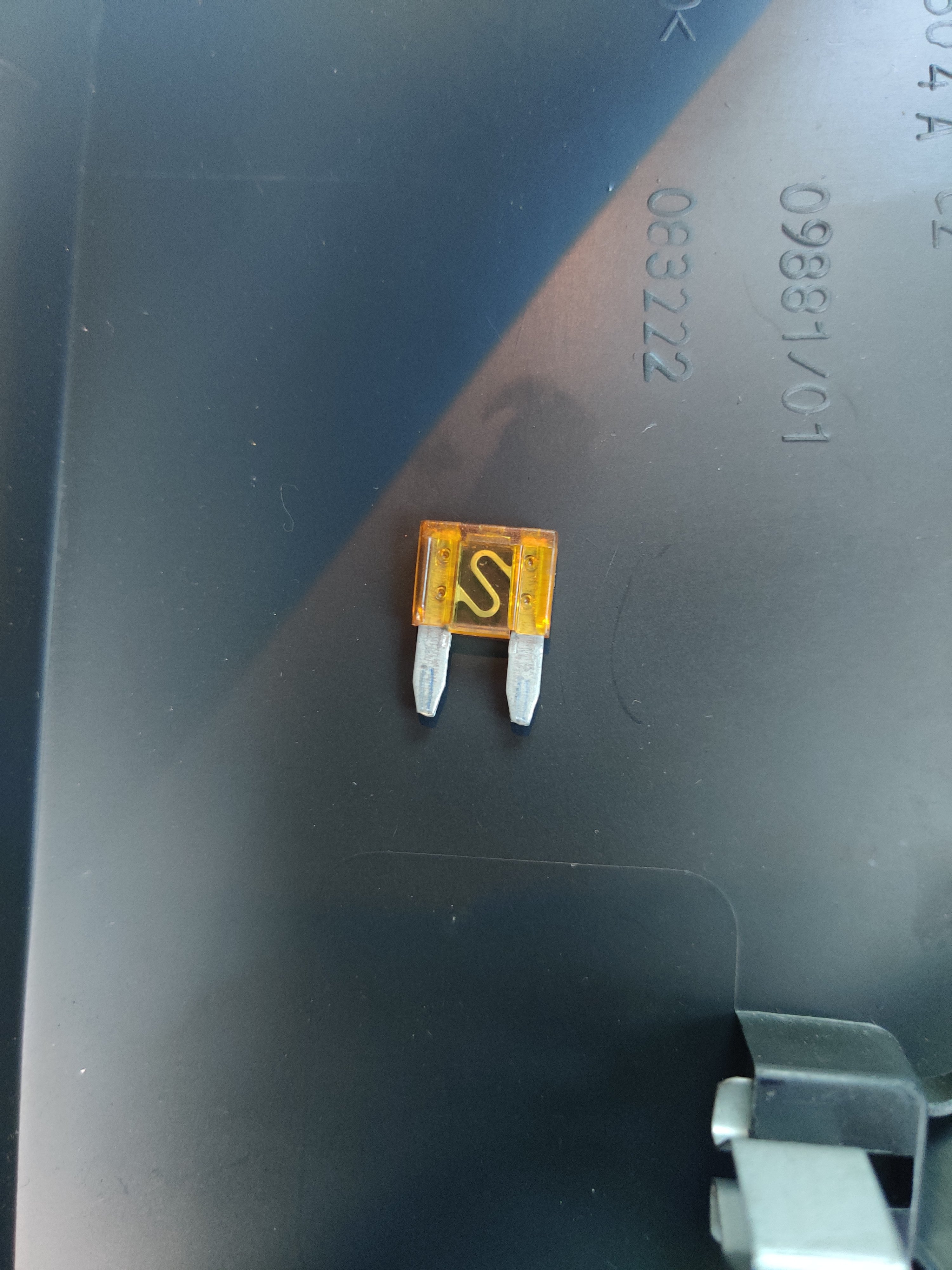

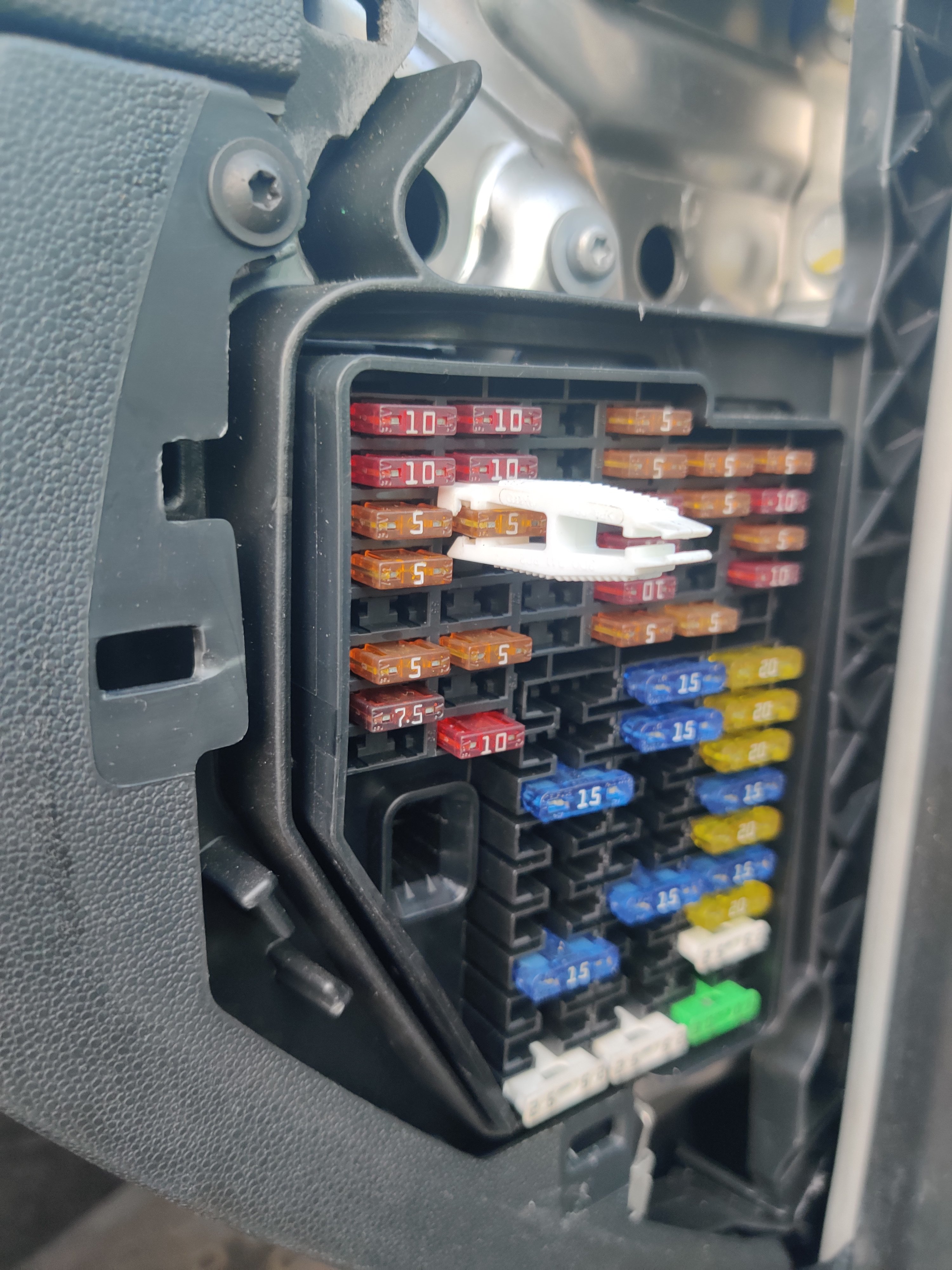

@Breezy_Pete Thanks for helping with this. Sorry, 'Oil light flashing' was an autocorrect typo. It's a red flashing exclamation mark, supposedly telling me there's a problem with the brake fluid, but all seems good on that front. All brakes seem fine. We checked the fuses when I got the VCDS reading, but I have got them out again to photograph. Fuse in cabin below, and the wiring to the ones on the battery. I'll do a post below with the rest. -

Sorry, I didn't think to ask for the old fuse. If there are 61A going through it I imagine it probably does get quite warm!
I took it to a car electrics place who have the VCDS etc. It was the fuse for the power steering! There was no visible damage, so it would be unlikely that I would have worked that out myself. Luckily they carry them as a stock item. It wasn't a cheap visit because of labour and the diagnostics, but the part was only £6! It needed recoding after fitting to get the PAS to work, apparently. Another thing to check before spending money!
