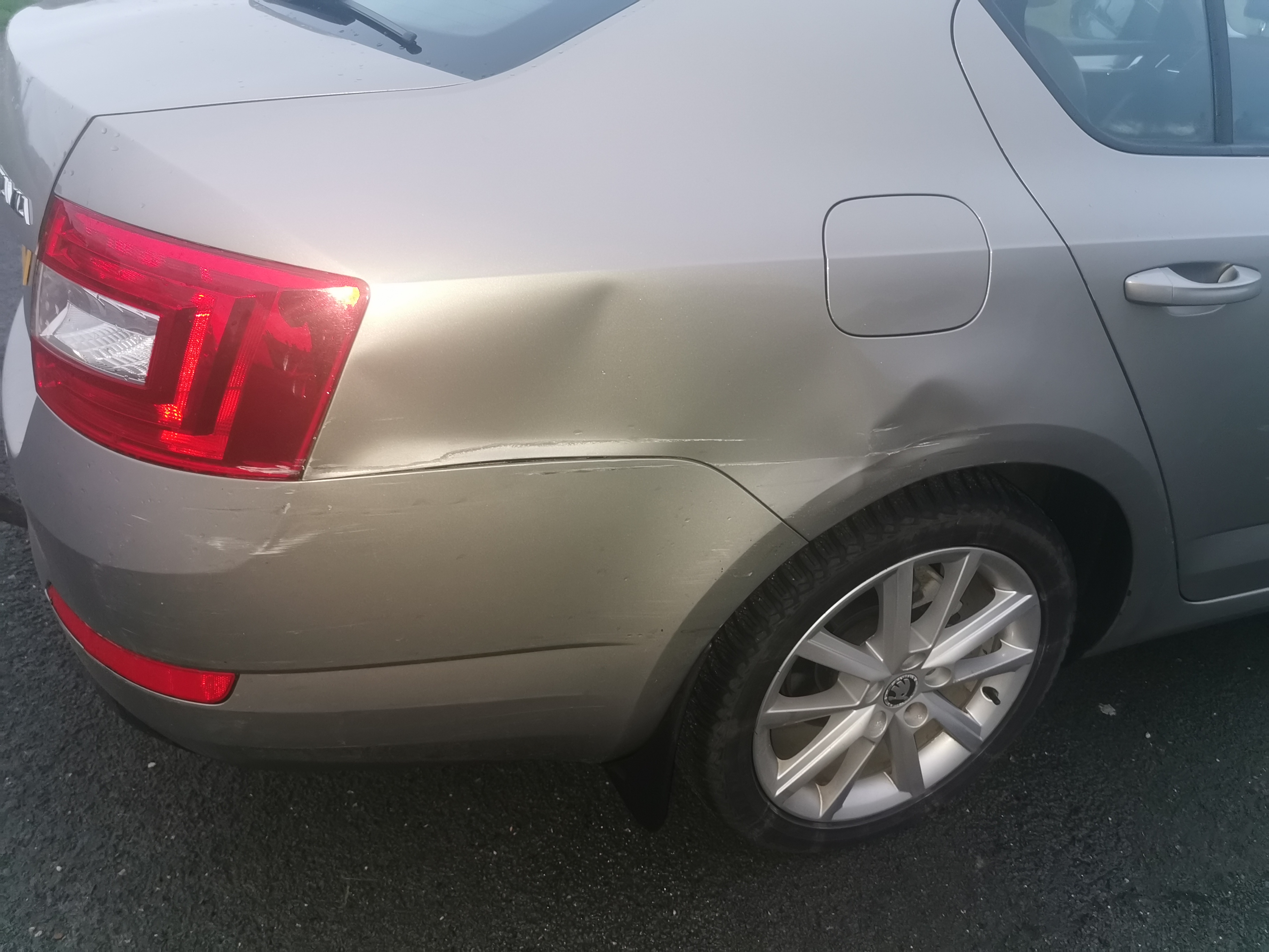

  1. Hi thanks for your prompt reply. There was no apparent damage to the door and two bodyshops have both concluded that they do not believe that the water ingress is related to the damaged quarter panel. I'm not sure where the drain holes are or how to check they are clear yet - I'll investigate that further. No water sloshing around in the door, but in fairness, it hasn't rained heavily here in the last 24 hrs, so that could be a red herring. Spare wheel well is bone dry.
  2. Hi all, I have recently purchased a 2014 Octavia 2.0 TDI DSG and was loving the experience when compared to my previous Fabia. However, having owned the car for only 3 weeks, someone pulled out on me and damaged the offside rear quarter panel and bumper. Sine this time, I have noted water accumulating in the rear footwell and also, to a lesser extent in the front offside also. My insurance company has agreed to replace the rear quarter panel and repair the rear bumper, but do not believe the water ingress is related to the accident. This may well be the case, as I had not encountered much rain prior to the accident. At present, the offside rear footwell is like a swimming pool and the front offside is also very wet. I do not have a sunroof. Any suggestions on where to start would be much appreciated. Thanks in advance.
