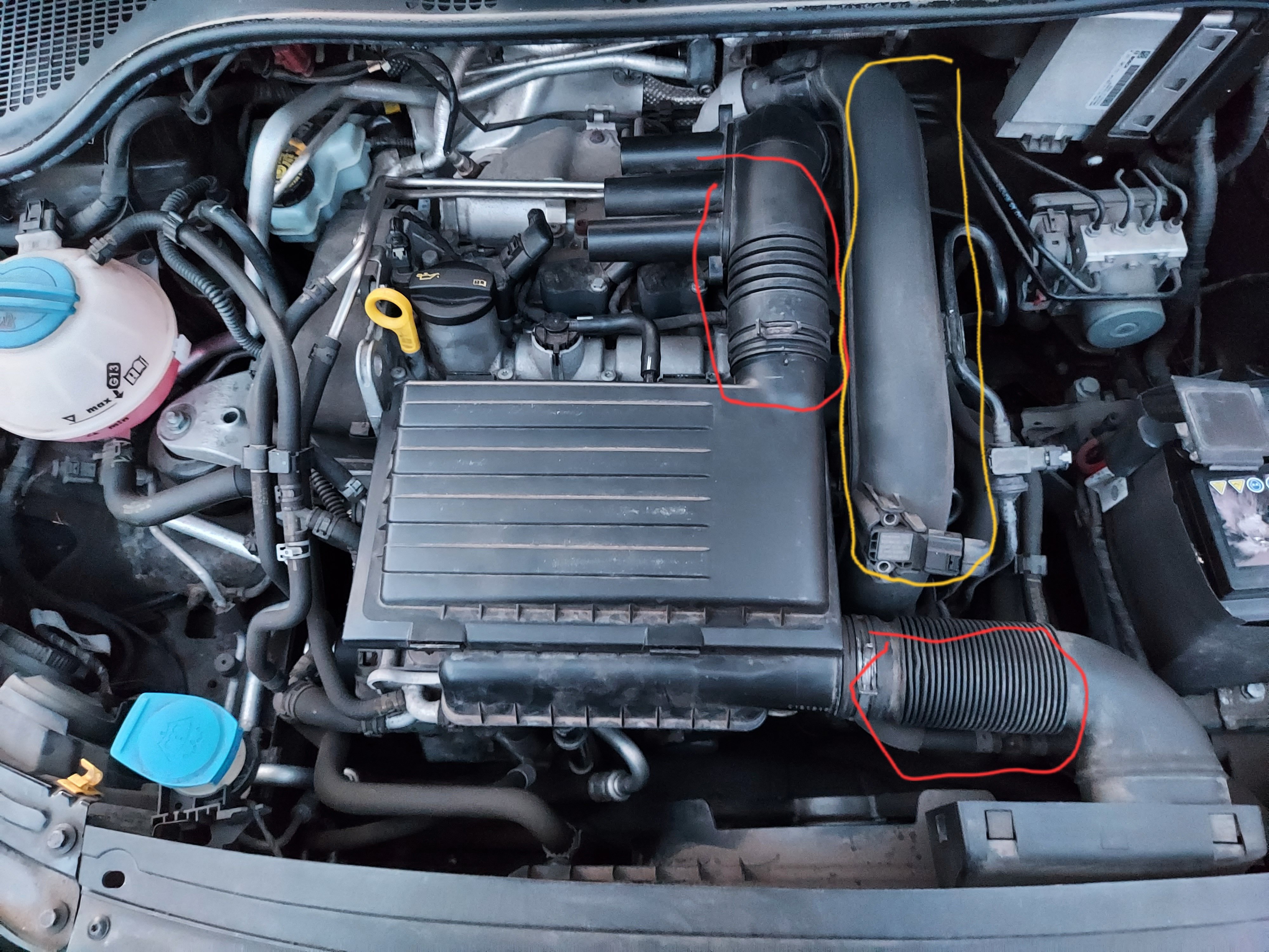

Thanks again rum4mo for the reply. Ok, so I've included a picture of my engine for avoidance of doubt. The 2 circled in red are the 2 I removed to get the box out. The bottom is the air feed from outside to the box, and the top red circled pipe was the one I had a bit of trouble getting out and back this time (spring clips!) I've since re-seated this properly after getting a decent set of spring clip pliers! Am I right in thinking the yellow circled pipe is the boost pipe you speak of? On the older engine guides the one way valve is under this but can't see any, and as we've now figured, mine is the later belt driven 1.2tsi rather than the early chain driven in the guides. After re seating the pipe mentioned above it has improved it slightly but it seems to be at a stand when the issue re occurs 🙄. Thanks for the continued help, think the next step is to get it all off again and re-check the plugs etc - but it's running fine 🤔 Thanks again Nick
