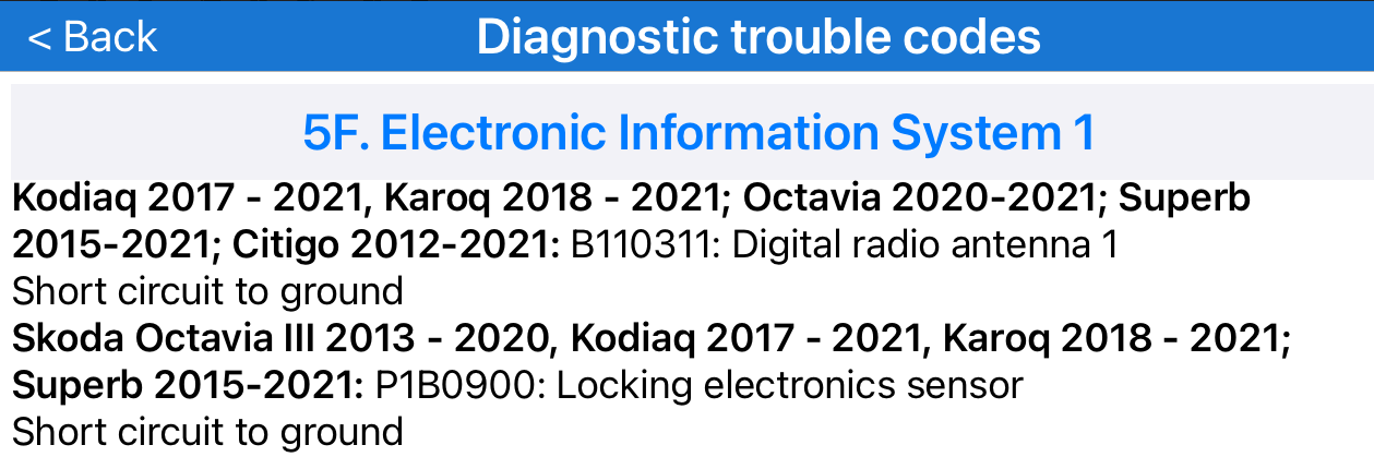

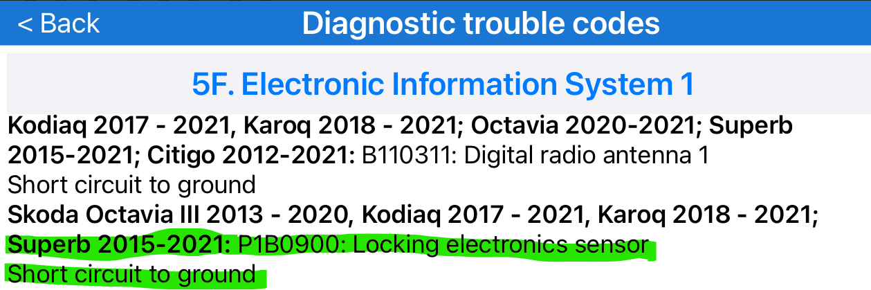

Hi, all. I've just done a quick OBD2 scan on my 2017 Superb estate and it's come up with this. Everything seems fine. The battery has been going flat, but the car's hardly been used for the last few months, so I assumed it was that. Any thoughts on where to look? It had a door replaced under warranty 18 months ago and previous scans haven't shown any issues.
