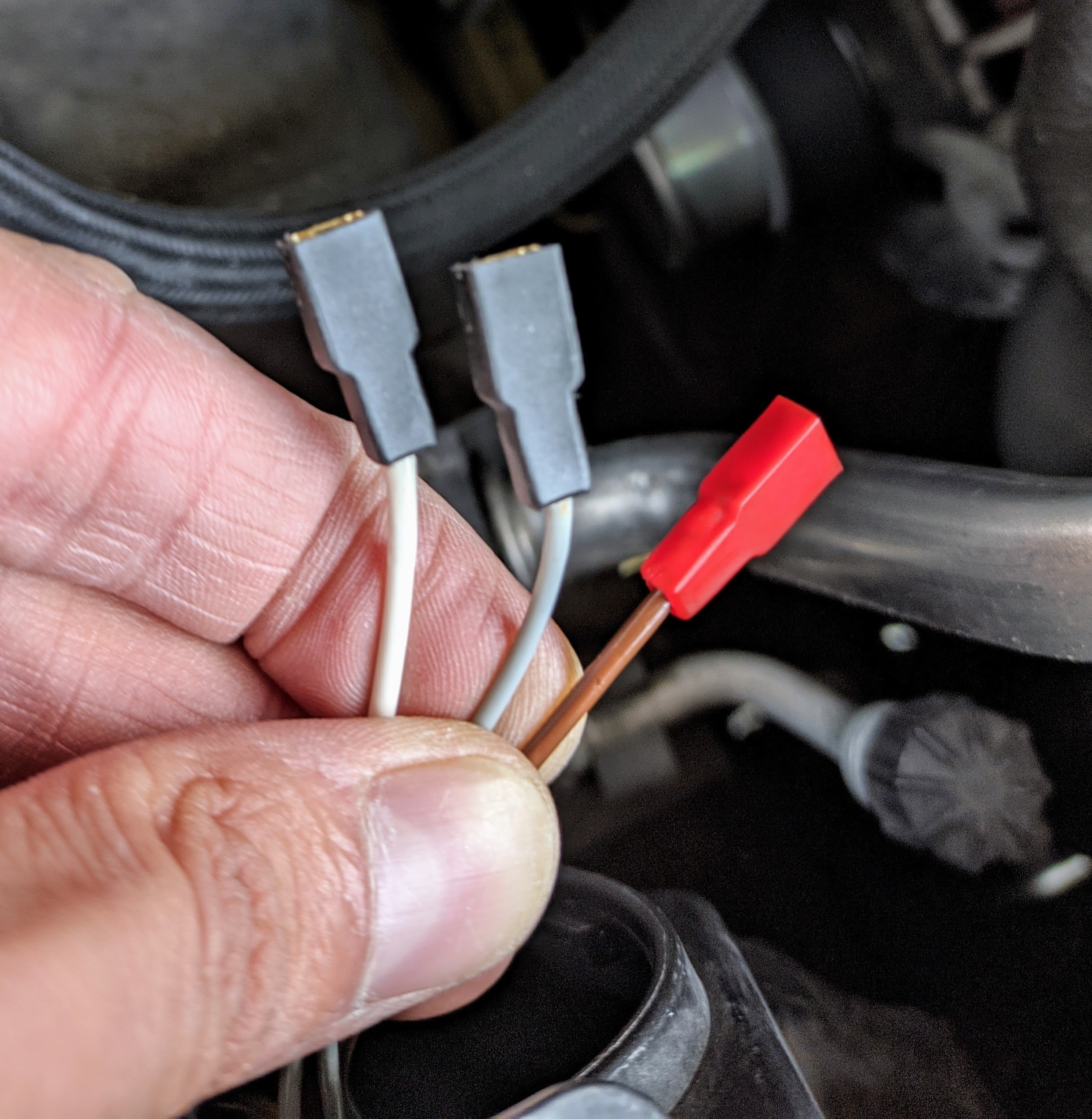

  1. Well ... Original connector and spades was broken... I've buied new universal connectors and now my headlight work perfectly. Not perfect, but Fixed. Thanks all!
  2. Are you sure ? Where can I find good quality spade connectors? I hate tape ... what do you think about epoxy ? First step: remove the headlight Second step: remove H15 connector Third step: make magic and good luck ....

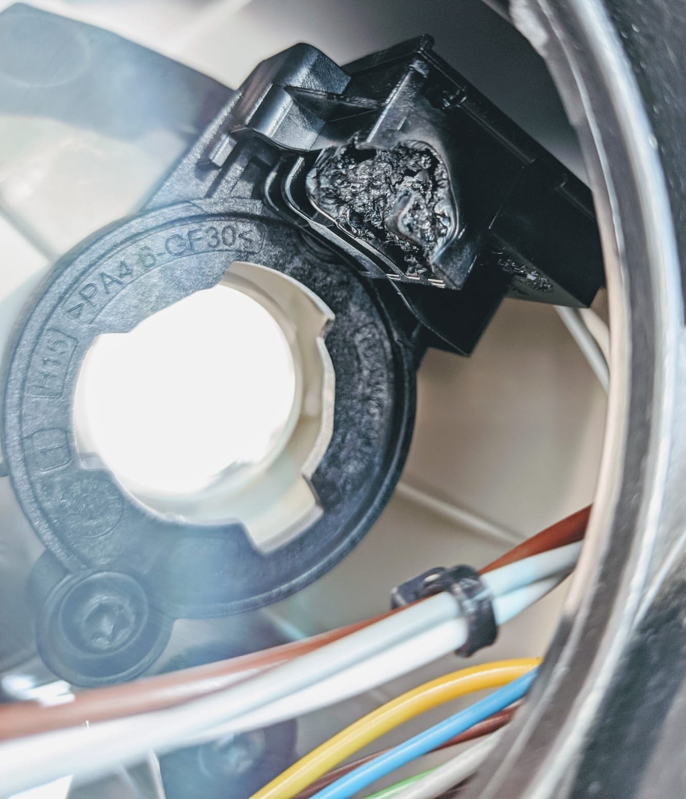

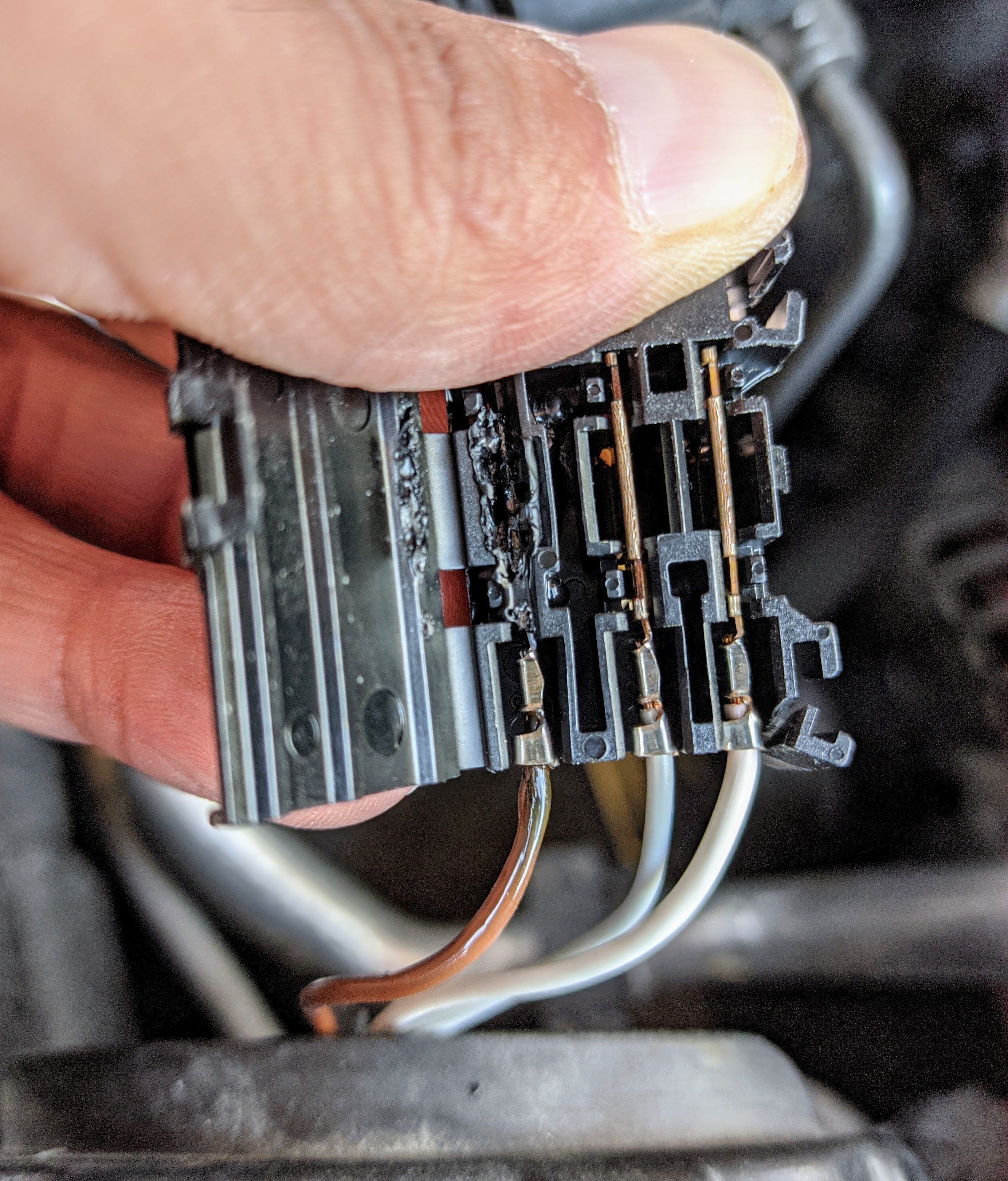

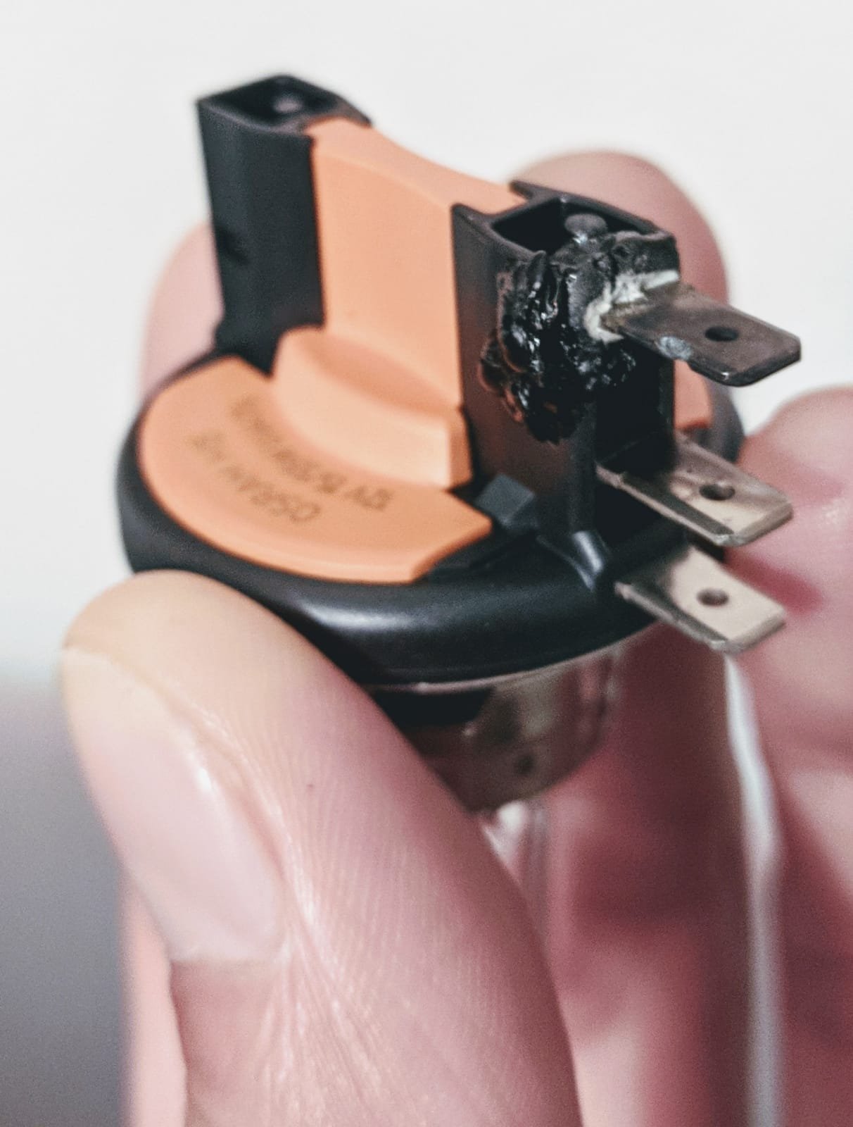

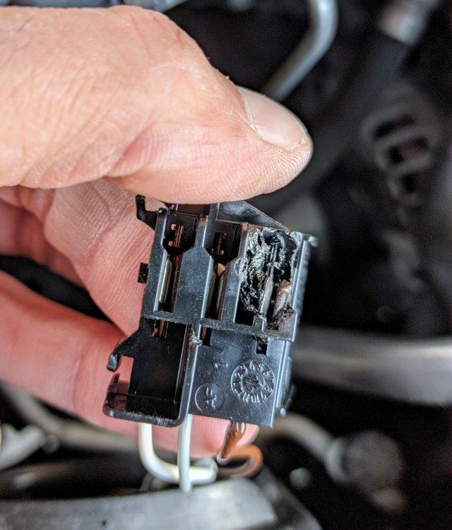

  7. Hi all! I have a big problem about H15 connector inside the right headlight of my Skoda Octavia III Combi 5E5 my16. The electrical connector and the bulb base are melted. In Skoda say: "you must to buy a complete new headlight" , but it's very expensive. Is possible to fix it or change only the connector ?? Please help me!
