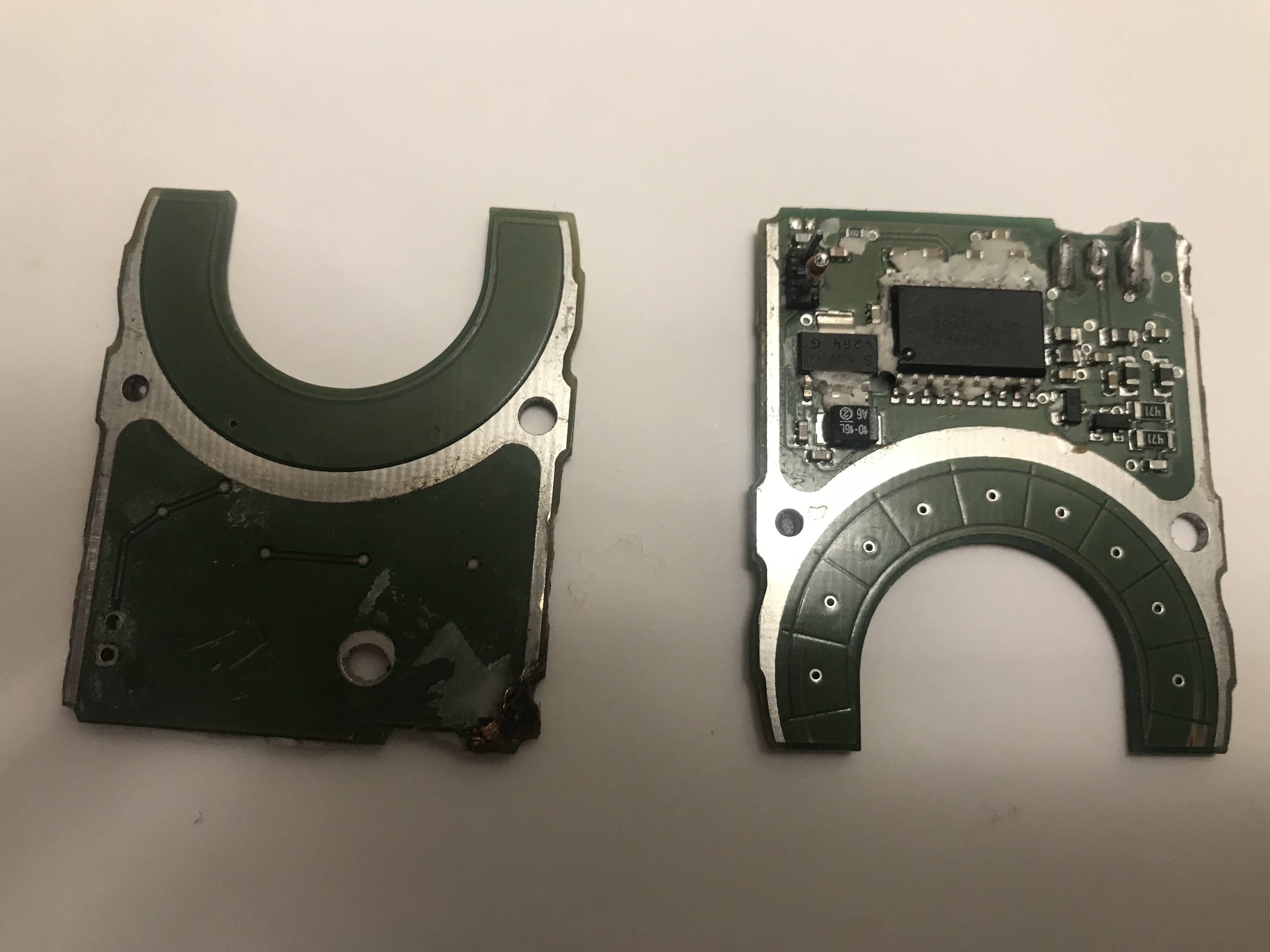

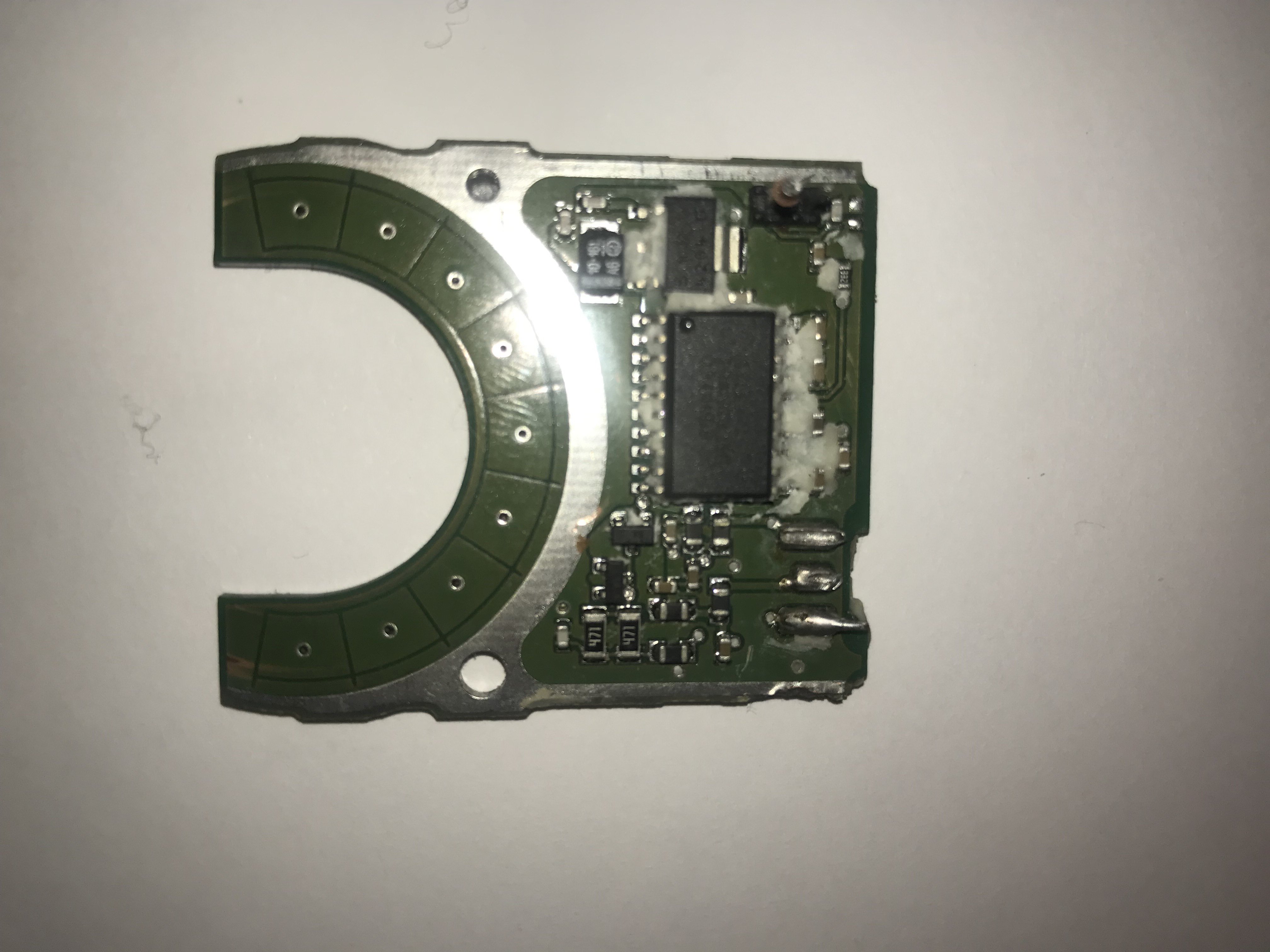

  7. thanks for the replies everyone , the first one failed after the housing filled with water due to a previous rack change and someone had not installed the rubber bush that sits between the rack and bulkhead correctly ,so i sorted this and replaced sensor but then rack failed a while after so replaced rack then after a couple years wrack failed again - oil coming out through gaitors, and into the angle sensor housing but luckily the sensor survived and i replaced rack again ! and all was ok for few years but now sensor has failed ,and some oil getting into sensor housing again so whether it has caused the problem i dont know tried cleaning up connectors several times in hope this would work but no luck sadly the one ordered appeared identical visually but they said it wouldnt work it was Reference OE/OEM Number 6Q1 423 291 A, 6Q1 423 291 E, 6Q1423291H ive seen some on ebay that are 6Q1423291D but ive no idea what the difference is ? i will check the recommended sites and breakers i actually dismantled one of the sensors hoping to make 1 good one out of the two bad ones so ill add a picture of the internals ,might be of some interest to someone i wasn't expecting there to be chips in it and was hoping to find a dry solder joint , the white fluffy stuff around the chip is the sealant they inject to seal the sensor up
