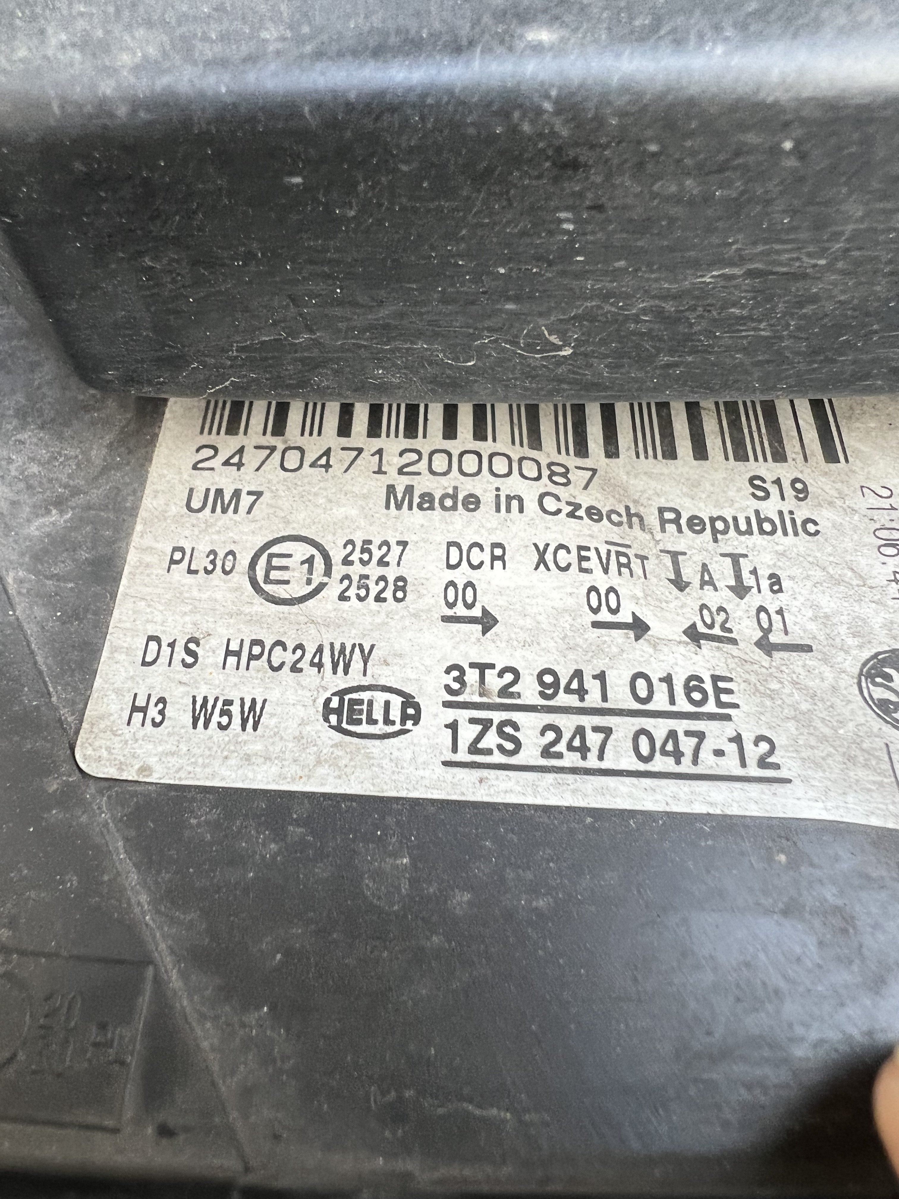

  11. Hi softscoop, attached a picture of the label on the headlight. Yes, the superb is RHD Xenon with the washer unit and the adjustment for driving on the right hand site on the Continent. The car has done 108000 miles and has been good to me! Regards, Walter
  12. Hi softscoop, we must have identical models! Thank you for your assistance! Walter
  13. Hi softscoop, bought the car new and first registered 26.01.2012 so it is pre-facelift! The part number on the headlight is 3T2 941 016E and the manufacturing date on the unit is 17.12.2011! Much obliged! Walter
  14. Hello, had an accident in Germany and damaged front right headlight. I have difficulty sourcing this part in Germany! Part No. 3T2 941 016E Who can help please to source this part in UK? Many thanks in advance for any comment! Regards, Walter
