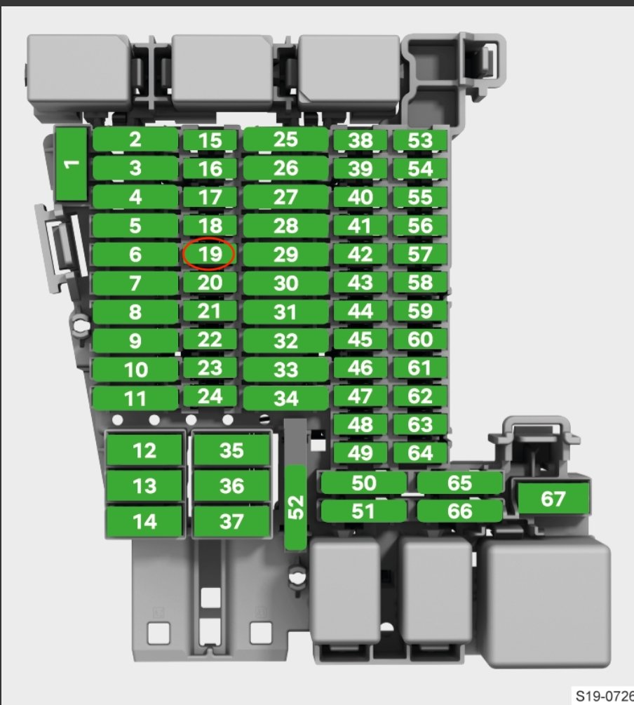

  4. Hi Deleuiuly, Unfortunately, my problem returned shortly after, on the same day. However, on November 27th, the car went to the workshop and they updated it to version 1989. It worked well for a few days. On December 3rd, it stopped working again. The little world showed a red X. I contacted Skoda again and have a workshop appointment scheduled for December 15th. They told me that the factory sent them some kind of procedure. Meanwhile, the connection came back online on December 5th without any intervention from me or the workshop. My biggest concern is what will happen when the warranty expires? Will I have to pay to resolve these problems, which may or may not be the result of buggy updates? The Connect service is paid annually, at least here in Portugal it is; will I have to pay to resolve a problem that prevents me from using a prepaid service? Regarding the fuse, an image from the manual is attached. Note that it may not be the same in your car; mine has left-hand drive. Look in the manual for online service or something similar. Good luck!
  5. Problem solved following this post: https://www.briskoda.net/forums/topic/495900-apponline-portal-not-updating/ The fuse to pull out in my case was the fuse 19 (refers to online services). After pull out and put it in again the online service comes online.
