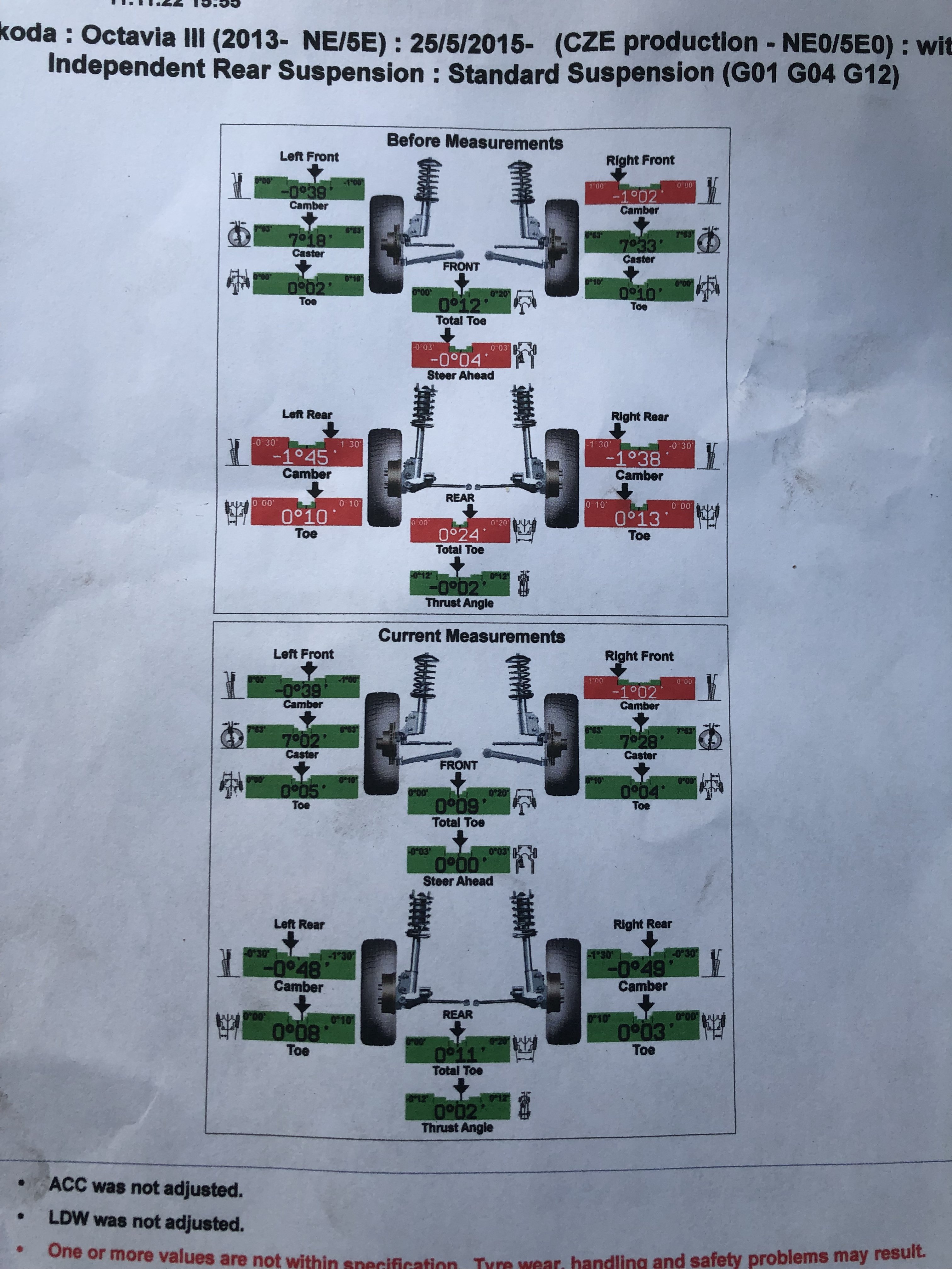

  1. Hi guys,very slightly curbed the drivers side front wheel on my 2019 Octavia vrs petrol manual.Put two new Michelin p-sports on recently and went to get the wheel alignment checked.They couldn’t get the camber right on that side.Spoke to a former Skoda service manager who now works for a different brand and he thinks the front subframe may be out of alignment.Is this a common problem that can be easily rectified and if so any members in west of Ireland recommend someone,thanks in advance
