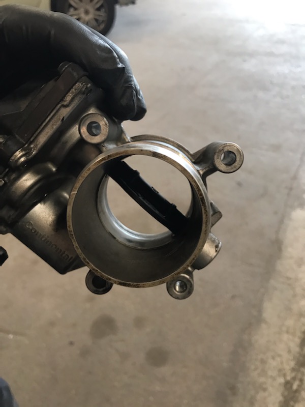

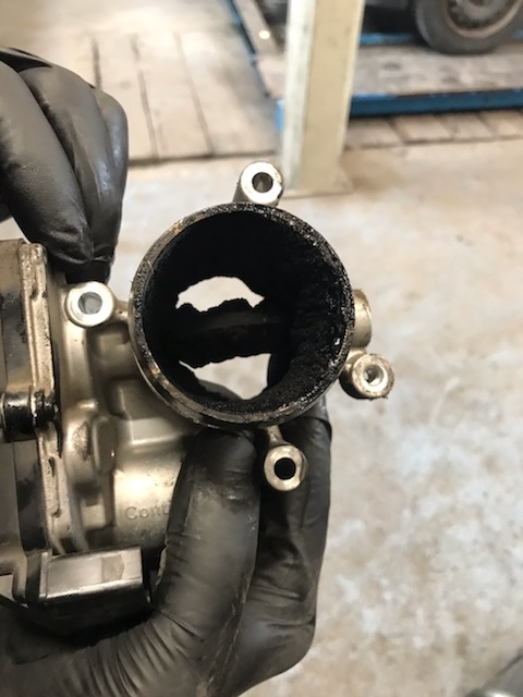

  1. I sure have and here are the pictures! What I'm trying to get a cross is that after I have everything cleaned out the Emissions Control System Warning Light comes back on 24 hours later. The exhaust continues to smell terrible, the intermittent smoke out of the exhaust returns and within 4 to 6 months I need everything cleaned again...It can't be normal that the soot and carbon is building up that quickly.
  2. I very much appreciate the reply Schtum but cleaning everything up doesn't really address the problem at all... yes, I can and do get the soot and carbon cleaned out periodically, but the rate at which it is building up is way beyond what is normal. My garage will do the clean but 24 hours later the warning light is back on and the smelly and smoky exhaust continues I think that something is wrong with the EMS and the car is burning way too much fuel too quickly and creating much more soot etc than a correctly regulated engine would.
  3. Okay the error codes are 5286 P0121100 (throttle sensor) To be clear my mechanic has (as recommended) cleaned the system more than once but the error code never goes away (24 hours maybe but no more)

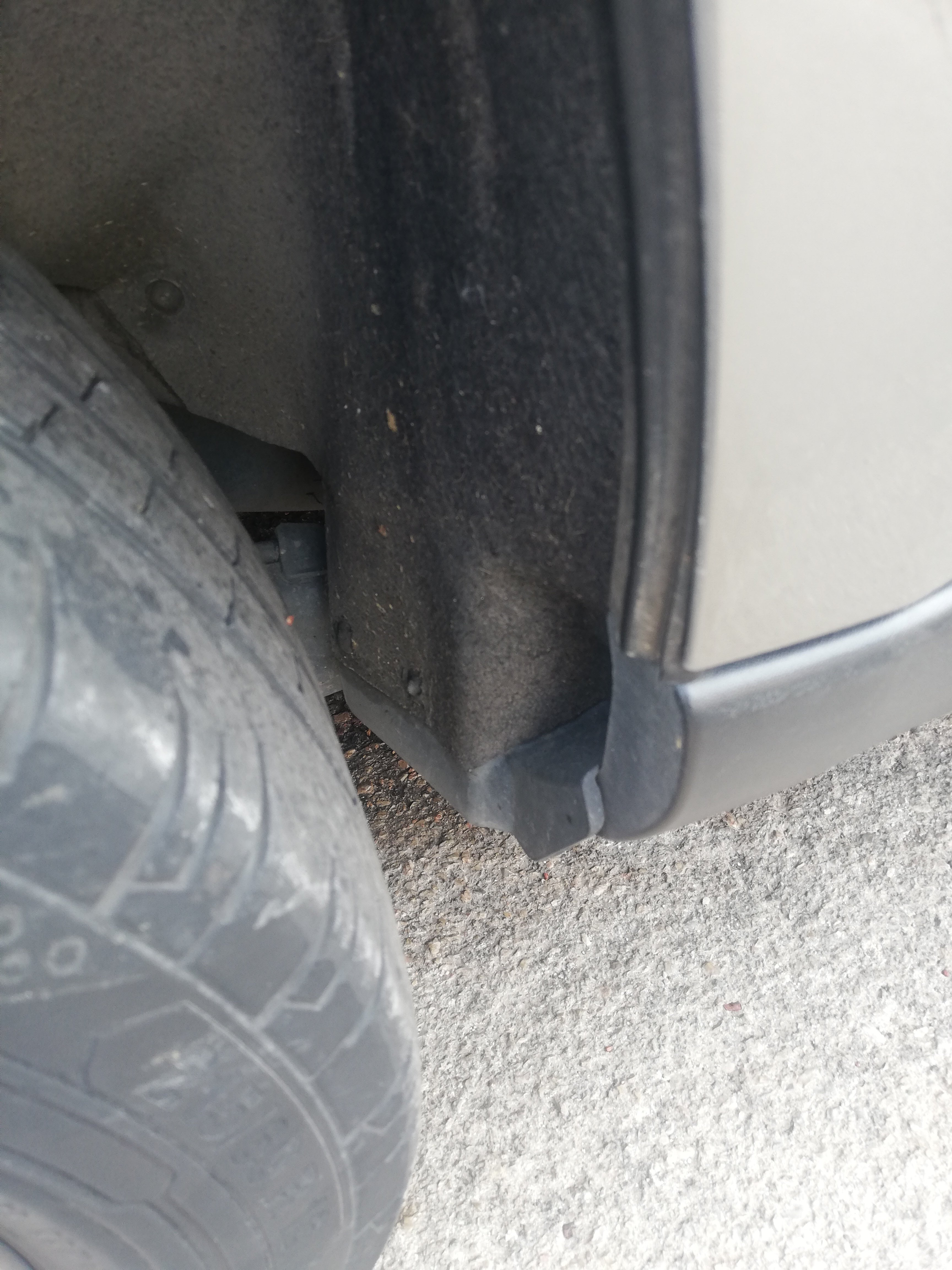

  8. Thank you for all the great replies! I just took a closer look at the notes from my most recent MOT and although he car passed there was a note about wear to the silent block and the need for a wheel balance...so that could well be it...the car is booked in to have this check out.
  9. Yes, oil is good...actually the coolant looks a little low but it's there. tell me more about these rubbers? Do you mean here?
