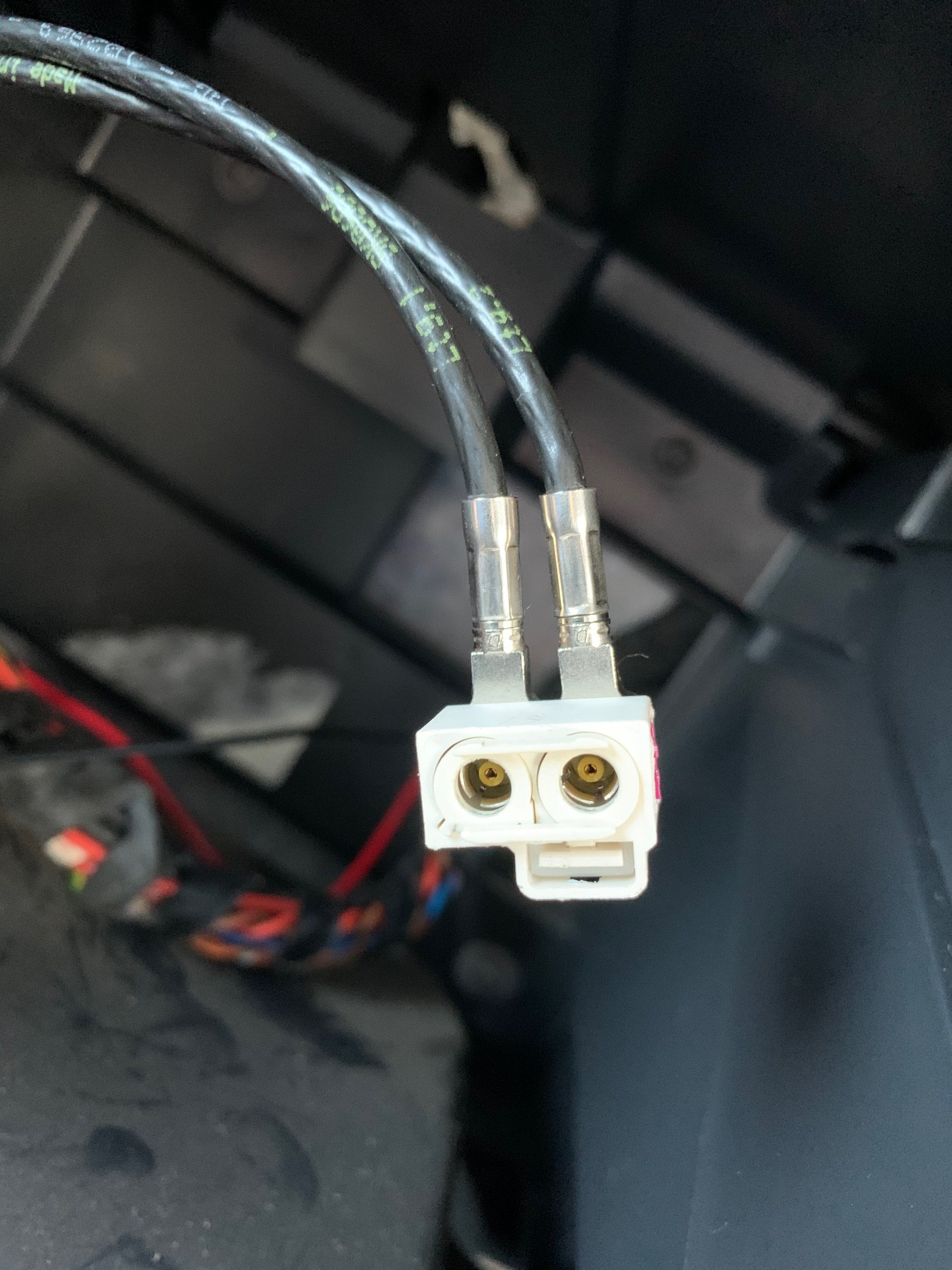

  1. Thanks but I dont think that would fit, I have tried two that look very similar to that and the separation isnt correct and they did not fit the aerial in the pic above. I have resolved it as I said by removing the green sleeve of it and inserting each silver connector individually but they arent clipped in. Mine needs amplification in it anyway. I also do not have edit under those 3 dots, all I have there is report or share????
  2. Sorry that title should read "Double", cant see how to edit the original post
  3. Hi All, I am trying to fit an after market DAB radio to my Skoda Fabia 2013 1.6tdi mk2. I have fitted the Kenwood DAB head unit successfully, all working including the DAB. However, I live in Cornwall and DAB reception can be patchy so I want the use of the FM/AM aerial when in such areas. Problem I am having is finding the correct double Fakra connector (see pic) to convert to single DIN aerial. I bought a double but the separation on the blue Fakra plug was too wide so had to remove the sleeve to give enough room to push each connector in individually. It works sort of but the plugs without the plastic sleeve tend to work their way loose and I have not used amplified connector so reception is weak. I could just tape them in to hold them but would prefer a plug that snap connected and cannot find the proper plug anywhere. Can anyone help please???
