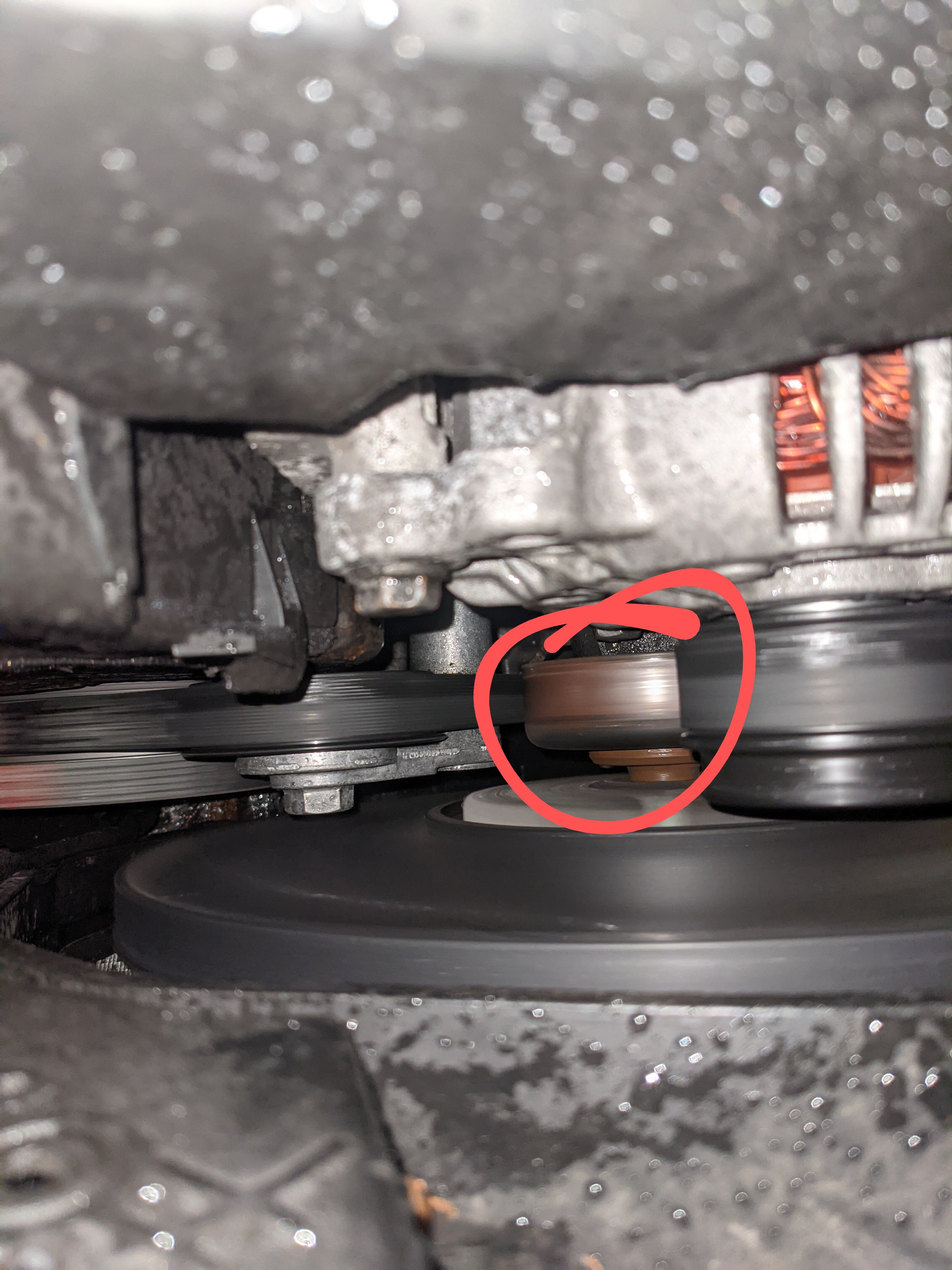

  2. After further investigation, I think you're correct. It's pointing to the alternator pulley being at fault, although as the whole alternator was changed in May 21 (less than 2.5k ago also) I ruled it out.
  3. Found it - it's a Viscous clutch pulley that I require. Although finding one in the UK is hard work!
  4. Afternoon all, after replacing my belt and pulleys and tensioner earlier this year (approx 3k ago) I've developed a squeaking serpentine belt. The culprit is this guy circled in red, but for the life of me, I can't find it's official name - is it a pulley, roller, or something else? Ignore the wet belt, I used water to identify whether its was the belt or something else. You can see "half" of the belt is dry, i.e. making contact or slipping - hence why I think it's that guy who's failed. Engine is a 1.9 PD130 AWX. If you can help please do. If you can link a part also, even better! Cheers!
