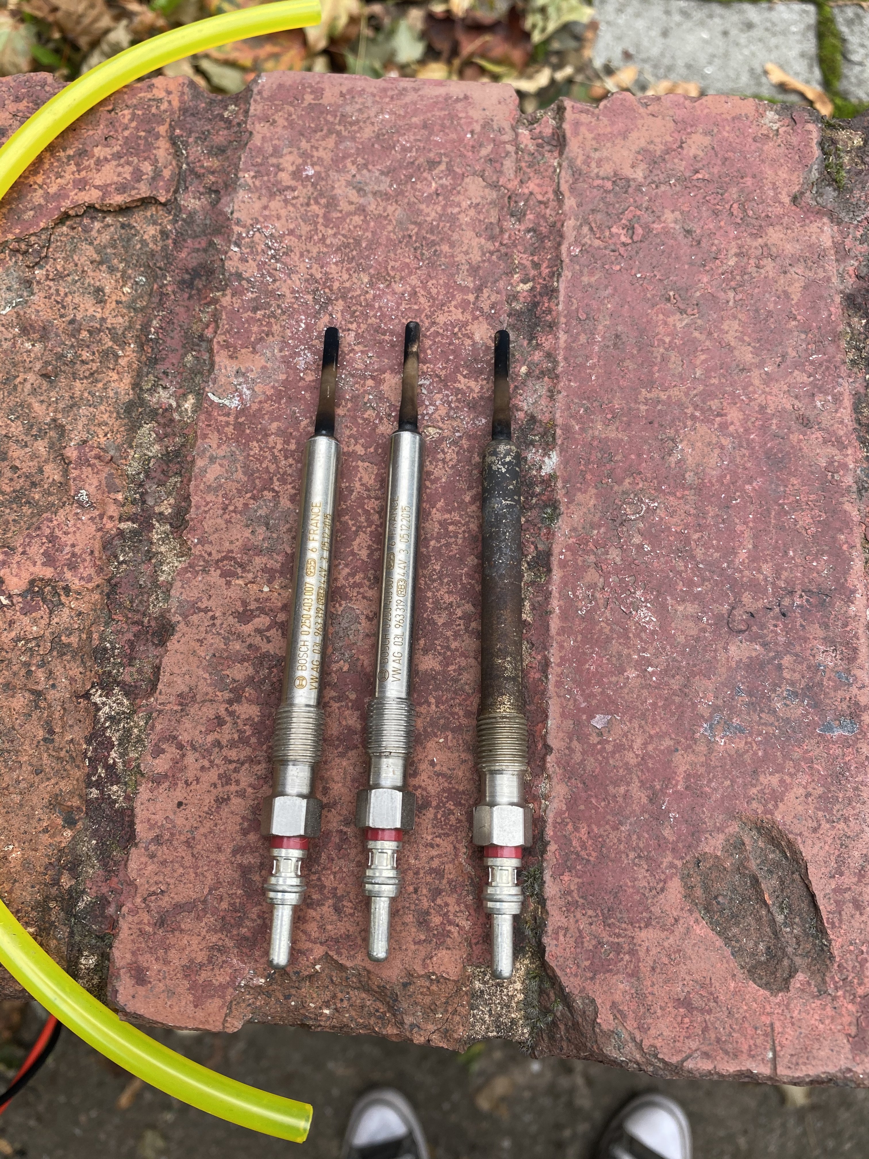

  1. And another update, I purchased 3 glow plugs at £12 each. I did not change the one with a sensor fitted as Skoda wanted £127 for it. But what was interesting is the state of cylinder no 4's Glow Plug. What do we think is happening... its the dirty one LOL .

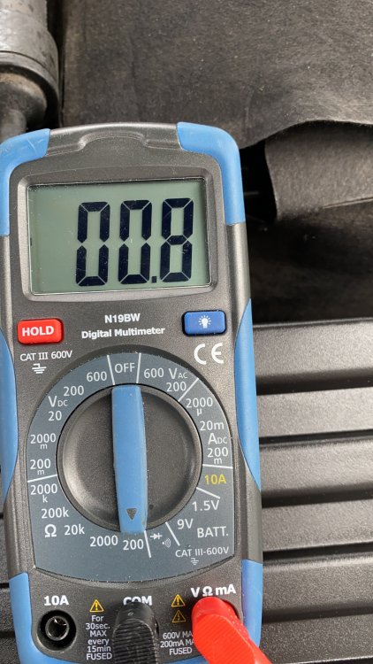

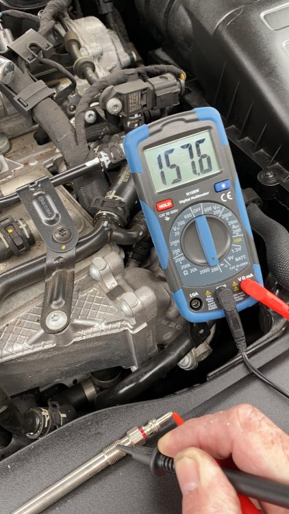

  2. Well I got one and this is what it come up with ....Just a very quick question the caps on the glow plugs are very stiff is there a tool to remove them ?? the 157.6 is number 2 and the 00.8 number 4

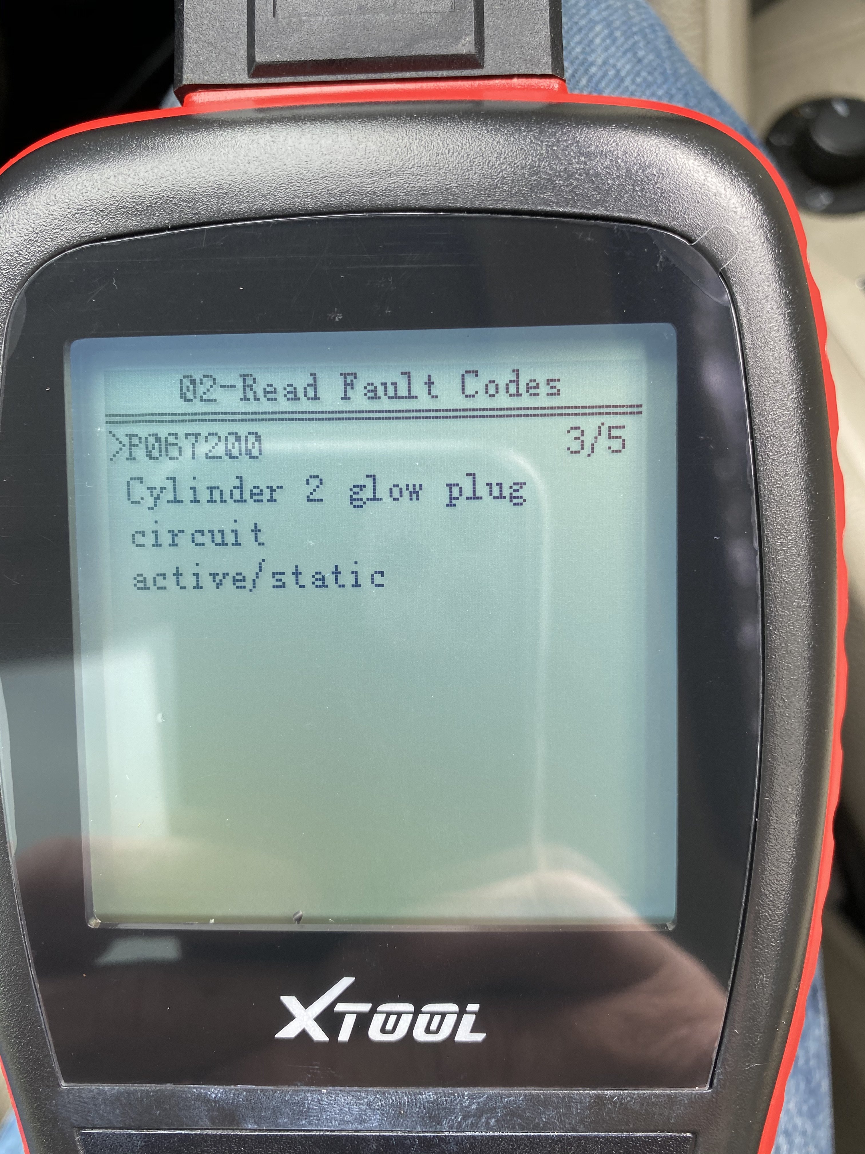

  3. Hi sorry if this has been asked before but what's a good fault code reader for a 2016 Skoda superb ??? I have seen some on Amazon.. Regards Terry
