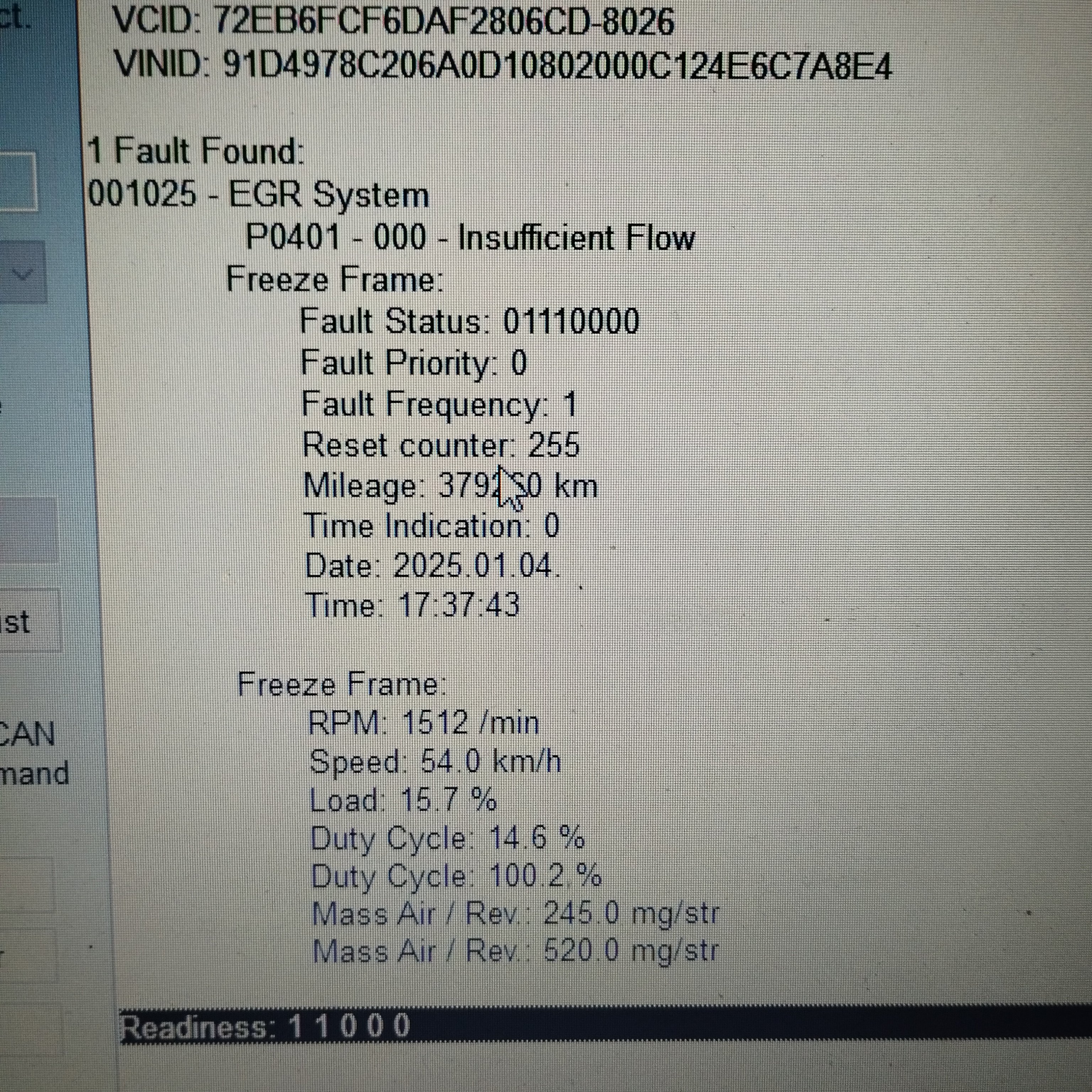

  8. Hey guys Any idea how to cure this code below 👇 car drives perfect, but when I try to over take on the motorway the car dies, I need to power off ignition and back on and boost comes back to overtake. Done a scan on vcds as attached, what I've tried is 1,Changed EGR valve, 2,EGR cooler delete (cooler still there just blocked the exhaust pipe with a blanket) 3,Mr muscle on turbo and freed up the actuator. 4, changed vacuum block 5, checked all vac hoses and blew them out with compressor. I'm fresh out of ideas, code keeps coming back, and after 1 or 2 days the MIL comes back on . I know of the other posts of the same code but can't seem to see anything to fix it.

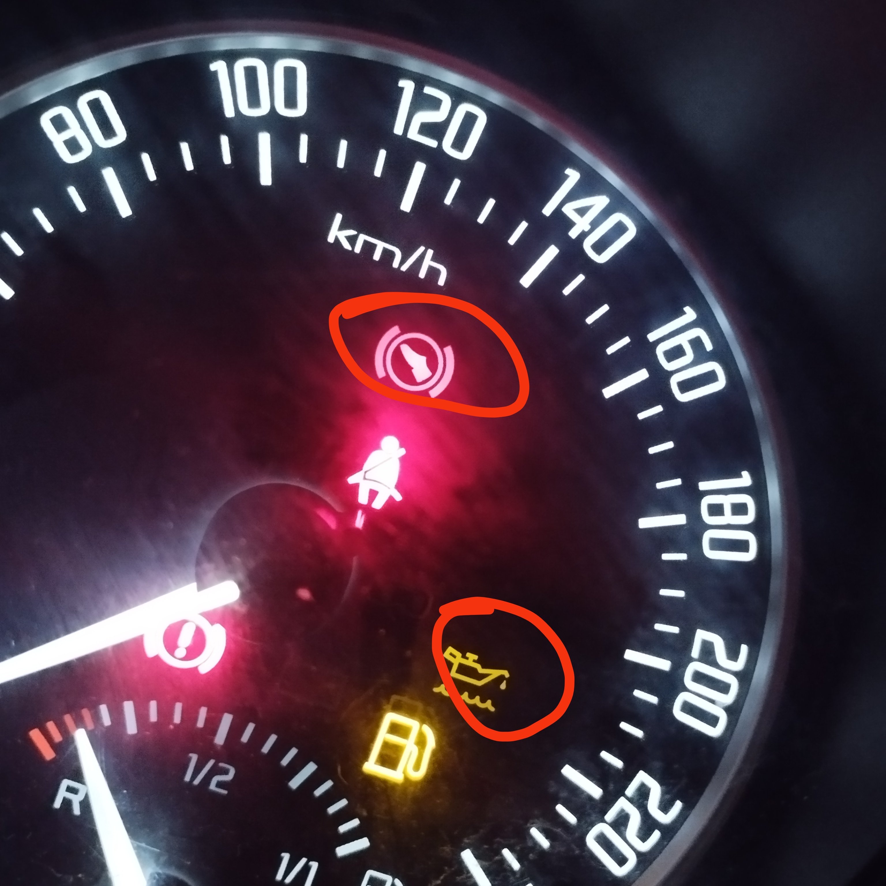

  9. Hey guys, back again (with better picture) drove it for the last few days but things seem to have got worse, The fuel light came on last night and now the oil light is on dim also, plus when I use the right indicator the cruise control symbol also flashes. I currently have the dash console removed and in beside my stove to try dry any damp that may be in there. Just wondering what else could it be? The red foot pedal one is on constantly, (dim mode) the oil light only came on with fuel light, and the cruise control only comes on with right indicator use. I used a vcds from a friend last week just wondering if it was a knock off device would it have f@@ked up my dash?

  12. Apologies, handbrake is operated by normal lever between Seats, Then above image is the not fully illuminated symbol, it's dim red light compared to the other red lights on the dash,
  13. Apologies I thought I uploaded a picture of it on with the seatbelt light on to show the difference in illumination, No it's been parked for about 3 weeks with the handbrake on, I drove it about 30 miles spin today and the light didn't go off, Handbrake, brakes etc all working good.
