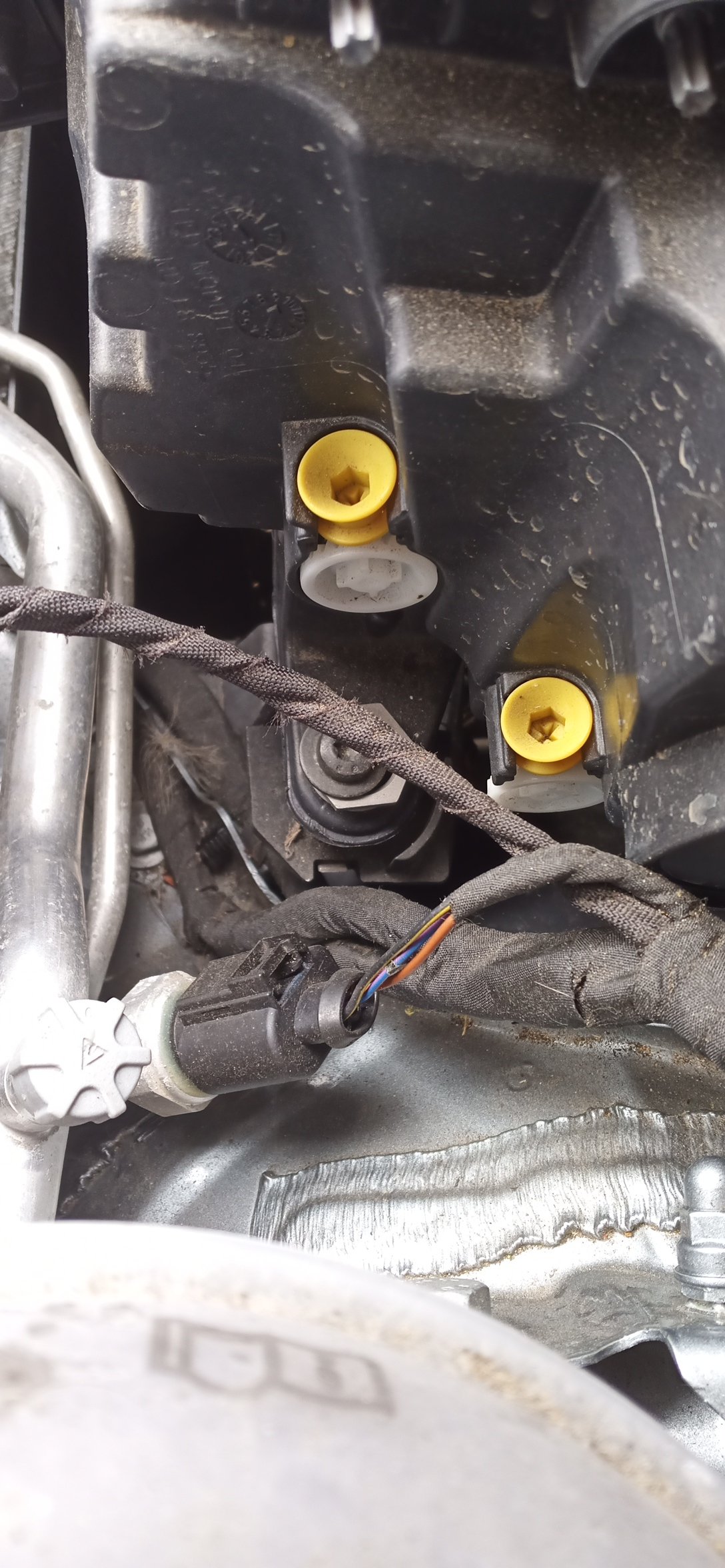

  3. For sportline and sussmb, pics of offside unit. Any idea which is up and down? Do the yellow bits have to come out before adjustment or are they just 'restrictors' or possibly the actual adjusters looking at the allen key shape? Thank you to winston for reminding us of the 'Harvey wallbanger'

  9. That would have been nice, but no. I see two yellow collared ?screws? on each unit. Are these what I need?
  10. Many thanks, K. I read somewhere that the levelling system has to be set up with specialist (and hence costly) equipment. A 'DIY' option would be very good. How can I see an image of the 'suspension arms' - I could not see anything obvious when I last looked? Is there a diagram/pic in any of the manuals carried on here?
