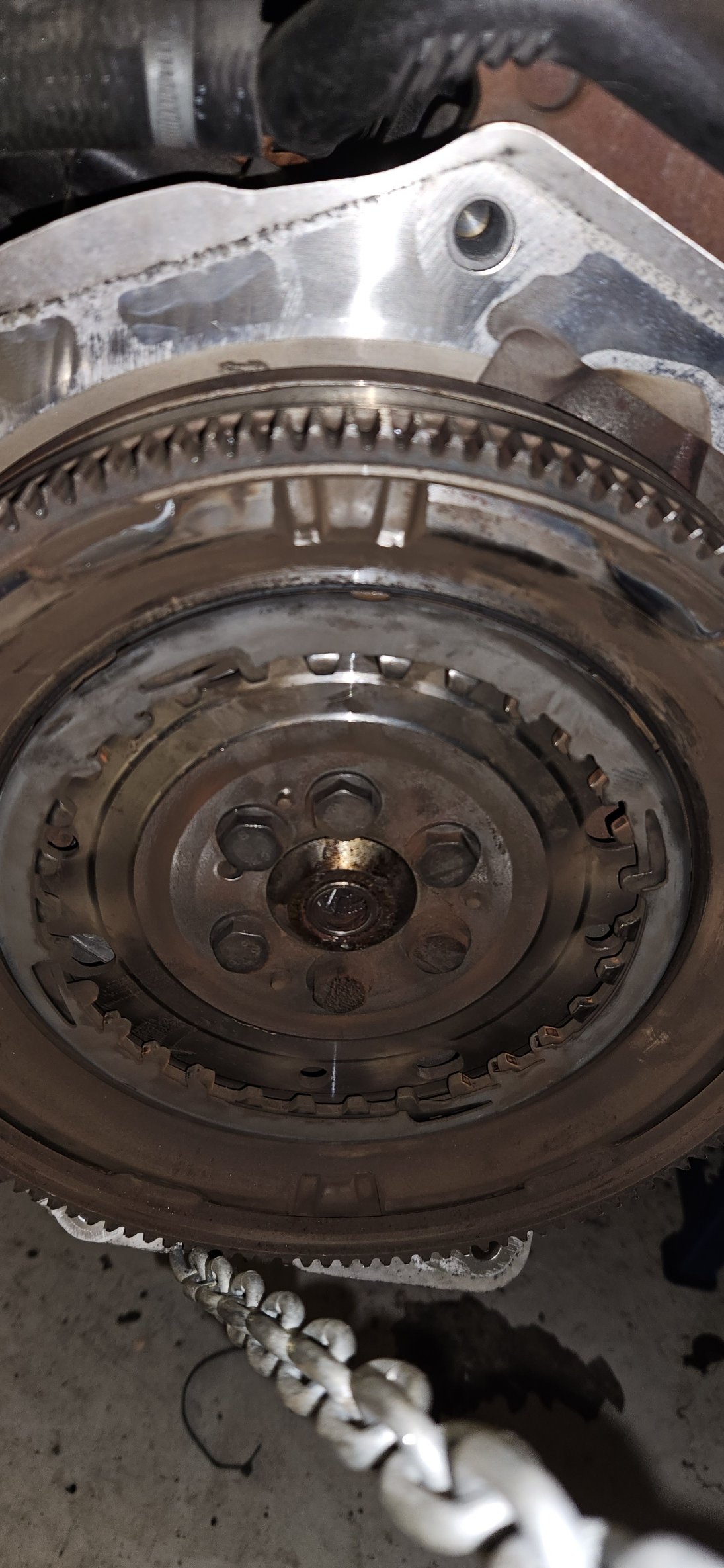

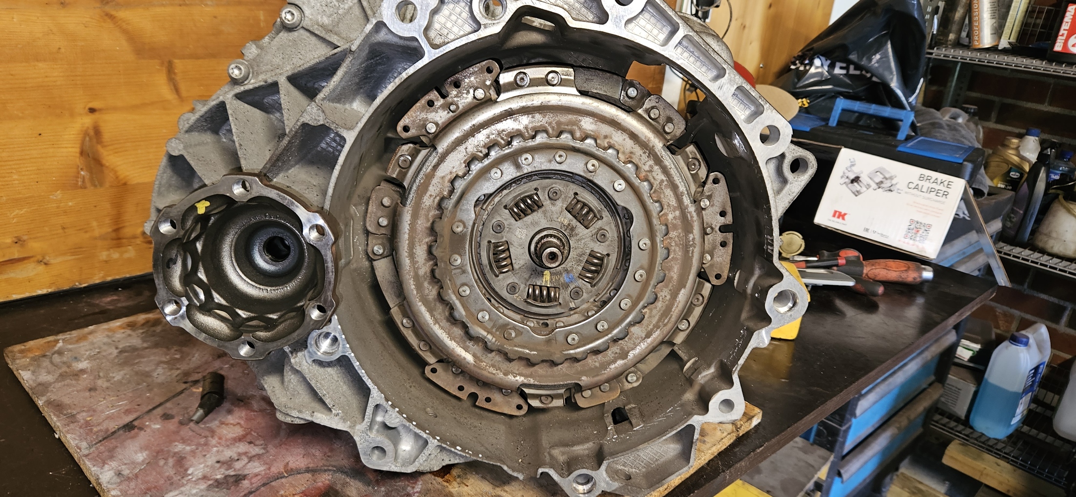

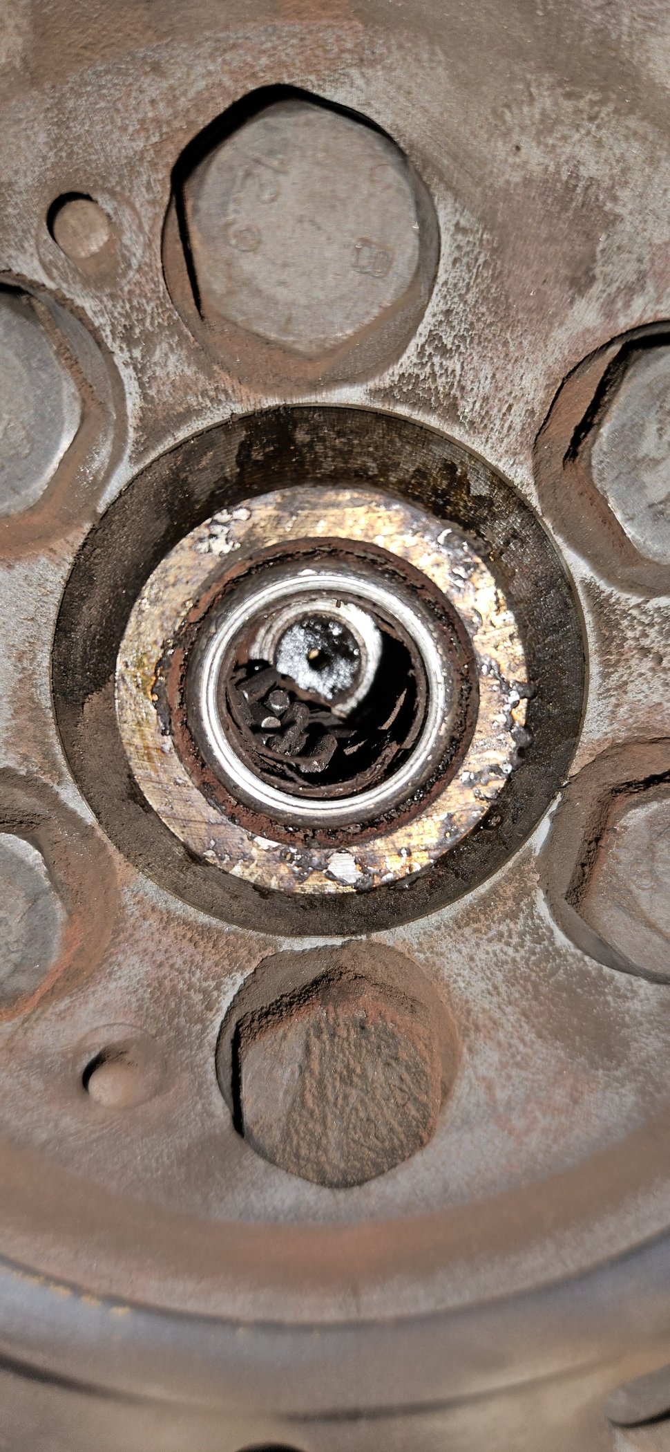

  1. So just want to add some more info for the future reference and users that might have the same issue. After dismantling the gearbox, it was observed that flywheel doesn't have much more (a bit more) movement compared to the new flywheel. However, doing detailed inspection, it was discovered that needle bearing inside the flywheel is totally worn out, and once flywheel was pulled out, bearing fell a part totally. Attached are the pictures. And this would explain the noise from the beginning, mechanical bearing squeaking noise. Part is ordered, and will be replaced and then everything to be assembled again. Flywheel will be changed when everything is opened already even it might not be required. I hope everything else will work as there were no other issues observed. I hope this might be a good guideline for others that might have similar issue.
