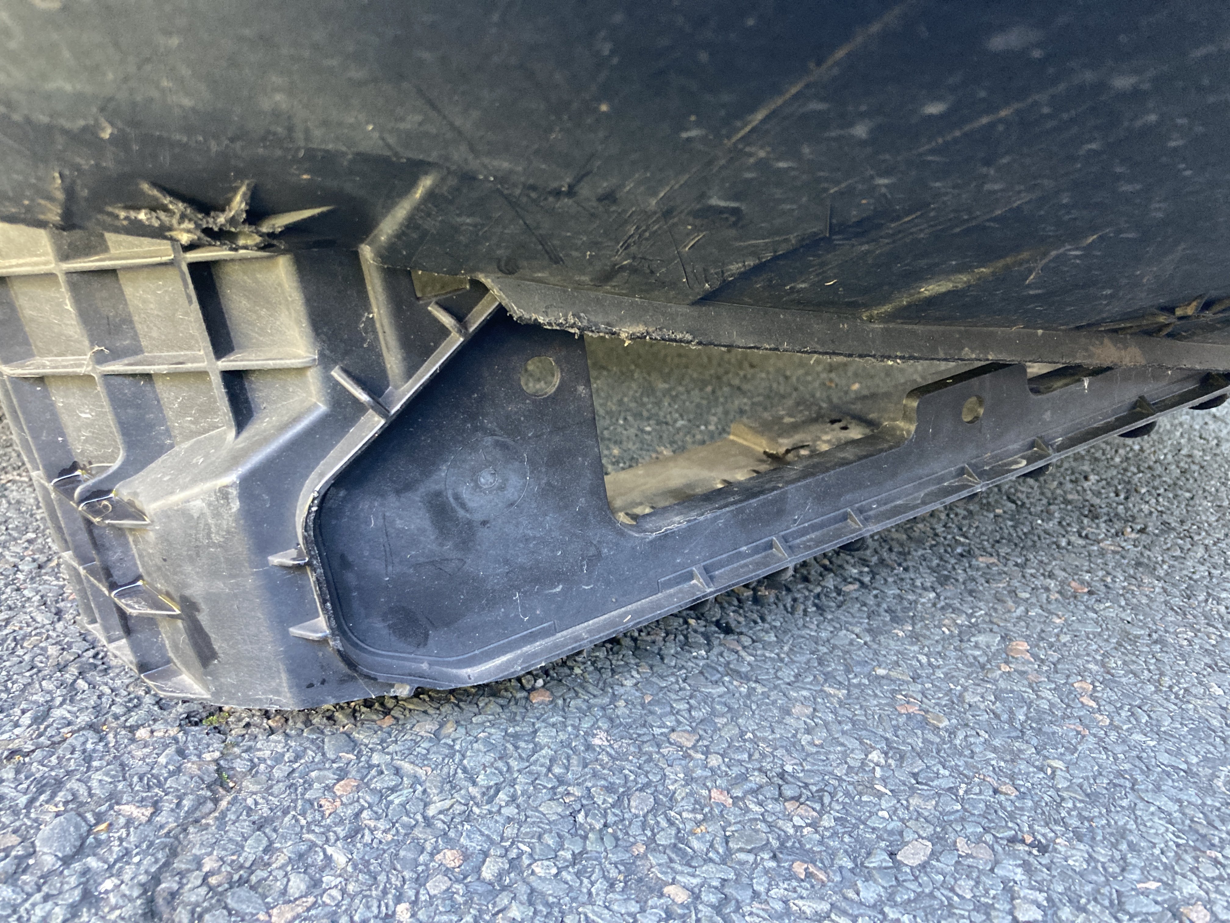

  2. That is an amazing site, but couldn't see this monster piece of plastic on there. I think it's part of the front panel that hinges when you maintain the engine, but there is no left side to clip it to. It looks like it fell clean through the noise filter plastic trim bit. The front bumper is split in much the same way as the rear bumper was when I bought it, but it's not something I considered looking at when I bought the car. I suspect the damage was done when the previous owner ran over the Skoda rep that sold the car to him 🤣

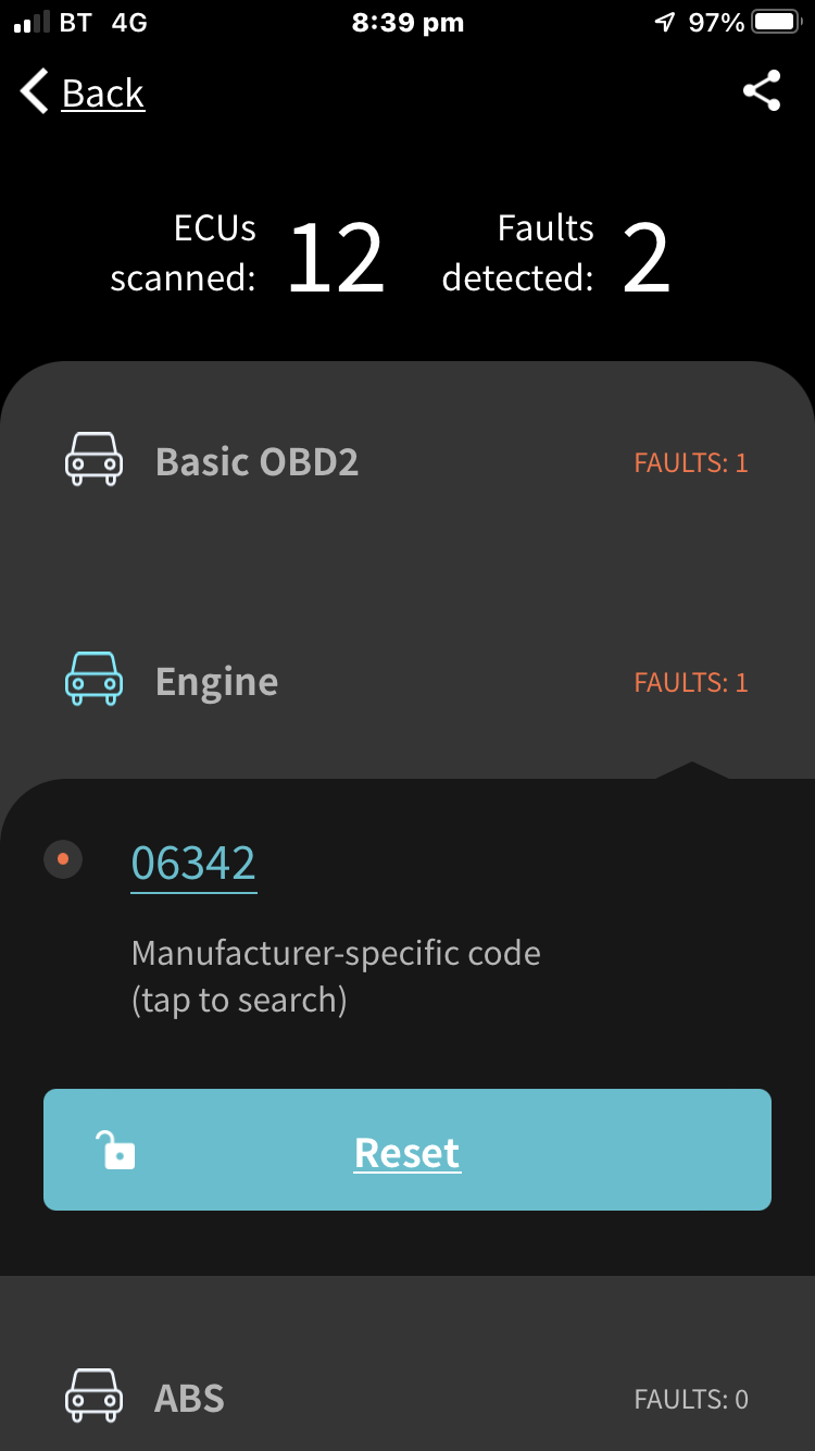

  3. Carista reported 06342 - Manufacturer specific code. Whatever that means?

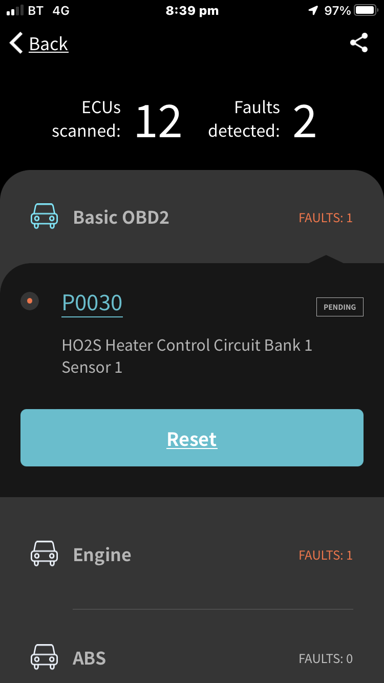

  4. Okay, got the car back so I could run diagnostics and two faults: P0030 (the garage must have read the code too quickly) comes up on basic ODB2 and 06342 comes up on Engine on my Carista. I reset them both and the check engine light went away but the codes are still showing up.

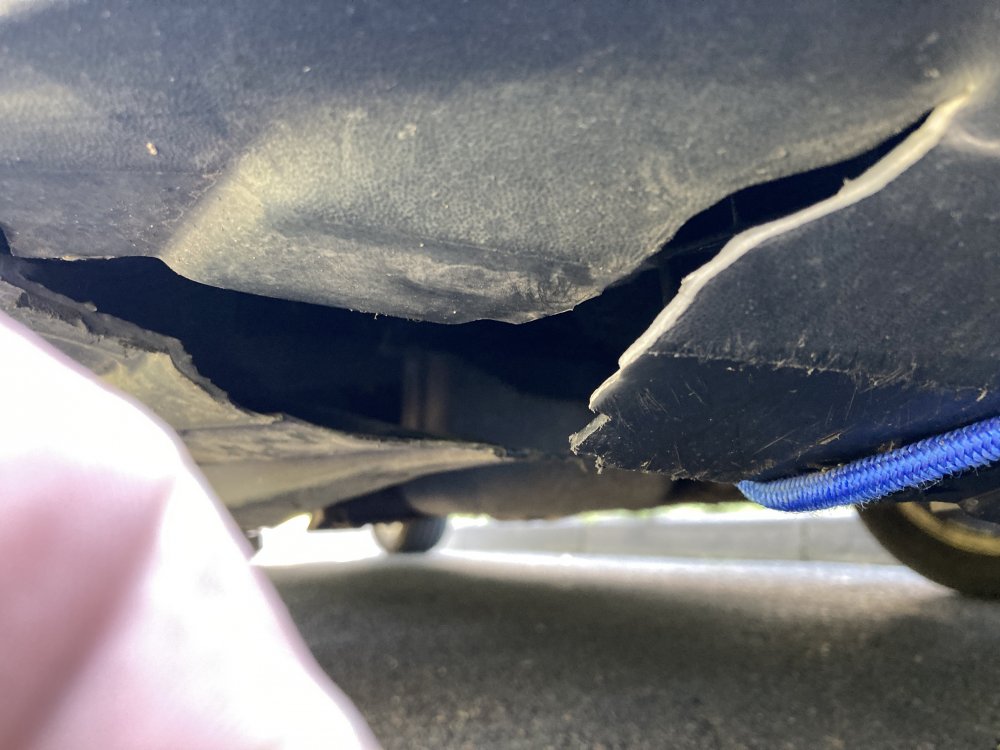

  6. Hi, I'm having a strange day. There was this noise that sounded like my roof bars had come loose, then I had a report from a cyclist that a piece of metal was hanging down under my car and when he passed me he said it was my exhaust. I pulled over and looked and couldn't see an errant exhaust pipe. I drove to my customer with this terrible noise from under the car and then noticed this plastic trim piece attached one side to the condenser had come away at the other end, but no obvious place for it to secure. I've shoved it up with a bungie cord until I can find out what to do next. So, what is this part's proper name and how does it secure to the condenser or to something else in the car? There is a hole in the plastic but no obvious place it attaches to. I'm suspecting something wasn't replaced after it's last service and it has vibrated loose. Best, John
