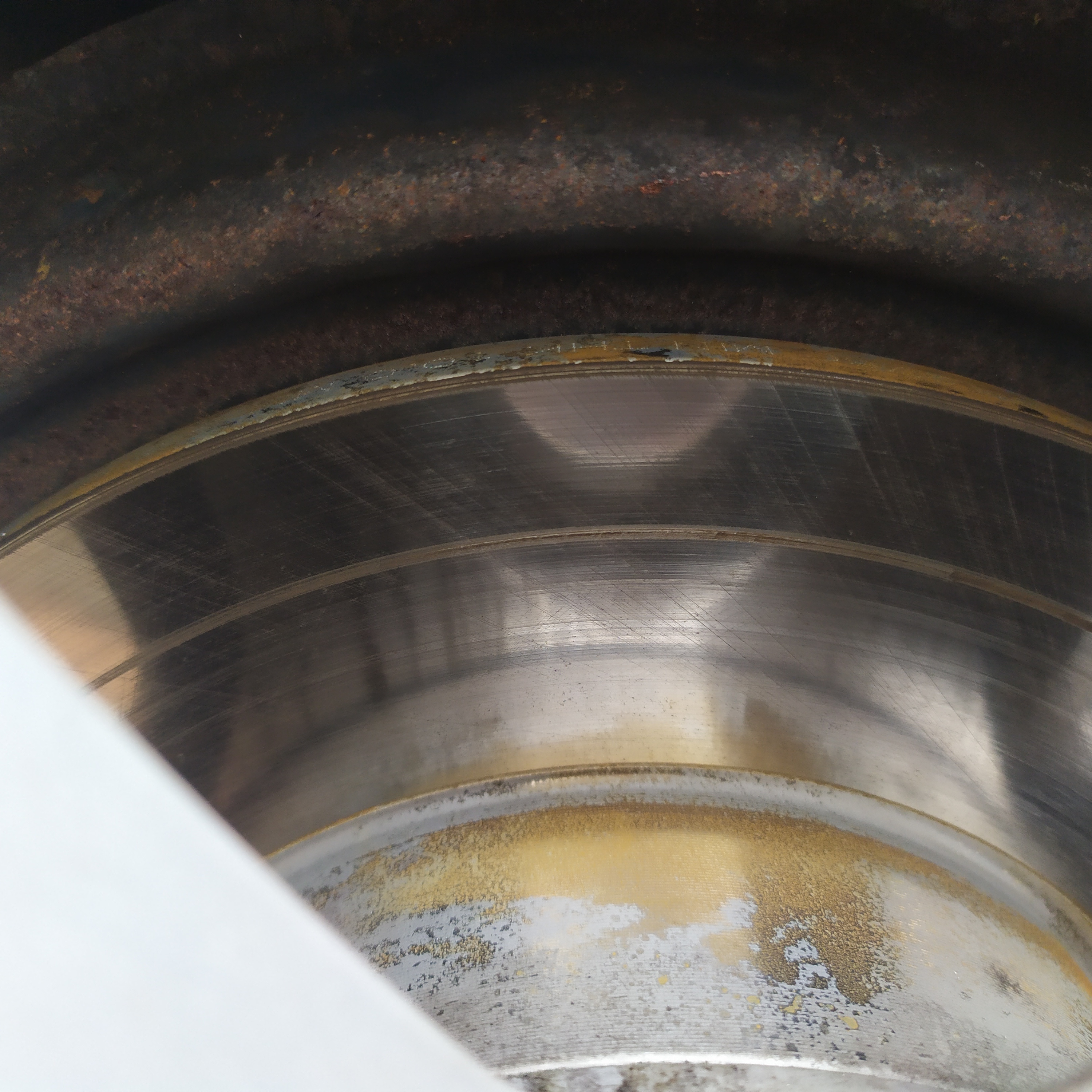

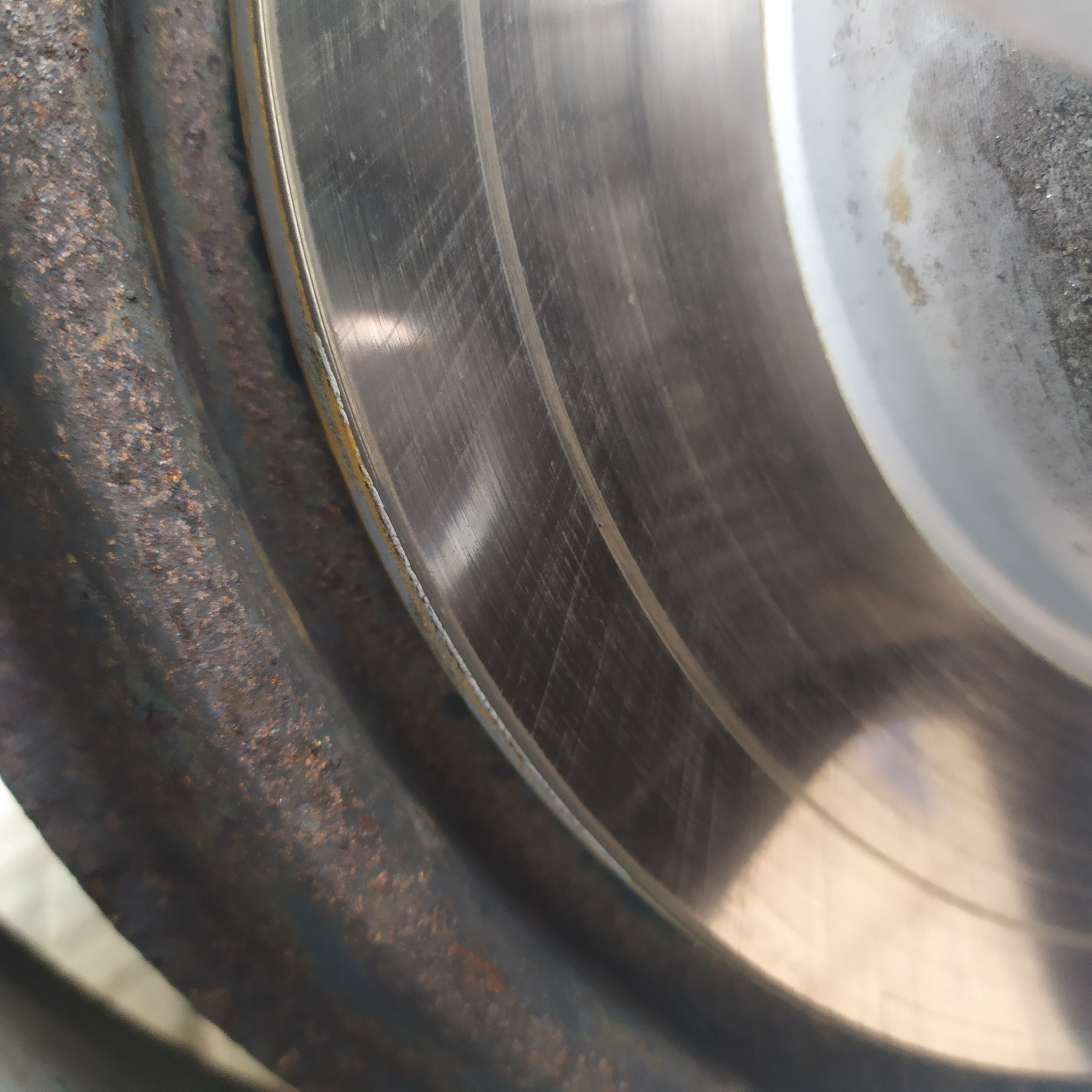

  5. Is it possible that binding can happen sometimes and other times is fine. , As when I lifted the car on jack, I was able to rotate the wheel fine?. What could be most likely causes?
  6. No noise. Wheel is not hot but disc is hot. .difficult to say if this disc is more hot then the three others . But Caliper a little hot on this wheel...
  7. I meant the groove on the pics on new disc is normal or due to a problem such as caliper sticking to the disc?
  8. I have now done more than 100k. Three discs have been smooth and even but since last 3 to 4 days, I have noticed a groove being carved on right rear driver side disc. pictures below. Is the caliper sometimes sticking?. I lifted the car up yesterday on the jack, wheel seems to be moving freely and also rollls on a slight grade.
