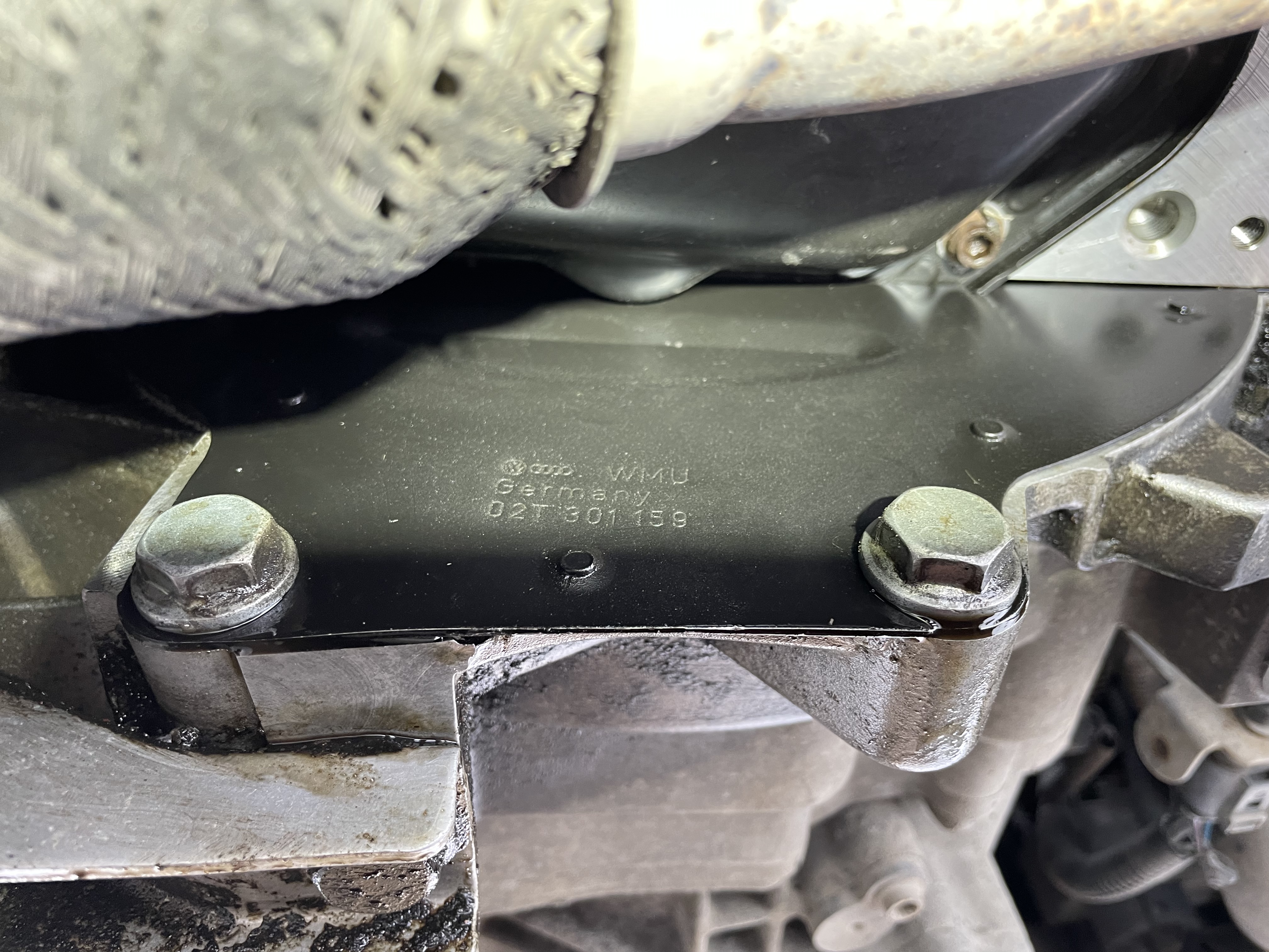

  2. Man, that’s a filthy breather. Upon inspecting the breather, it indeed seems like it’s the current culprit for the leak. Are the seals replaceable, or will just a cleaning do, or should I just order a new unit? Photo of the plate I mentioned:
  3. I'm from Finland, the English I picked up by being frantically interested in everything computer. I'll snap a photo of the plate while I'm under the car on saturday. It's a 2004 Fabia, I haven't been too bothered about the oil leak, as it's only been a drop or two after I park it, but the yearly inspection rules changed recently and now you get a fail if they see even a drop of leakage. And the smell isn't nice either, as it tends to leak right on top of the exhaust. Not its only problem by far, it has a slight knock/tick sound as well, which I suspect is a valve, but it seems to take it in stride so I haven't worried about it too much. I actually had been thinking of buying the Haynes manual, but as the description on their website is vague if they cover this engine or not, I haven't yet bought it. Any idea if it does?
  4. The engine indeed has a steel sump, and has a manual transmission. The 45nm bots still are there, but they only hold a thin, separate metal plate in place to cover the opening, for which I imagine 45nm is more than sufficient. I'll check the leak more closely during the weekend, and see if I'll order a new sump, and perhaps the breather as well, depending on the findings. Thanks everyone for the help so far!
