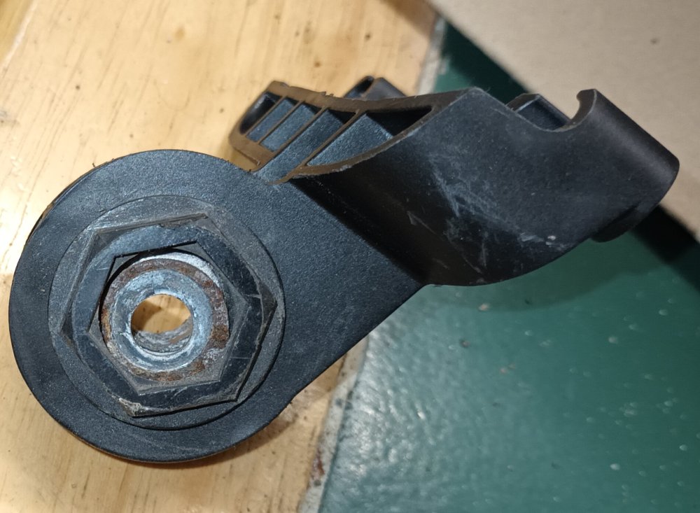

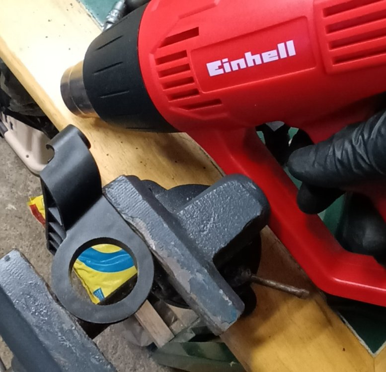

  2. I've just completed the job, many thanks for the instruction. Before screwing the plastic insert into the troublesome front side bracket, I used a heat gun to warm up and "soften" the plastic where the insert screws into. It wound in very easy and didn't break.

  4. Hi, I've just bought some genuine brackets on eBay. I couldn't find a seller that supplied the brackets with the self tapping screws, I've had to order those online separately - Torx self tapping 4.2 x 16 from BoltBase.
