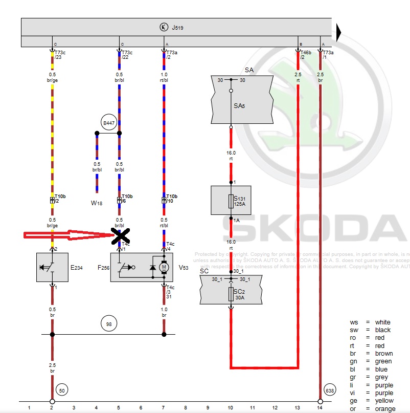

  1. Yes! Anyway, after much dismantling, my partner has sorted it. There was a complete break in the cable from pin 22 of the body control module to the boot latch, it had broken behind the boot wiring grommit, really strange the break was really clean like it had been cut. For anyone with a similar issue, it's the blue & brown cable, and it should have power at pin 1 of the 4 pin plug into the boot latch. My partner dismantled the nearside boot trim to first check for power at the 10 pin multiplug behind there. (Both cables into the boot light have power, there is a diode on the light).

  3. Thanks both. We've ruled out the boot light, it works when removed and tried via a power pack. We don't think it's the earth as it appears to be common with other components that are working. Can't rule out wire, but not straightforward to test. @AG Falco I unlock the whole car with a single press of the bottom button, and then open boot by hand. Central locking is working - including unlocking the boot, there is still power to that part of the latch. Interior lights are still working. Side lights, top rear brake light, everything else is still working. It's just the boot light and the electrics telling the car the boot is open.

  5. I have a problem with the boot electrics. If I return to the car and unlock with keyfob and then open only the boot and change footwear, whatever, for a couple of minutes, the car isn't recognising the boot is opening and it is locking the car again and arming the alarm. We have confirmed the car isn't recognising the boot is open on the driver display. Also the boot light isn't working. We have replaced the whole boot latch that incorporates the switch and it hasn't solved the problem. Does anyone know which fuse it is? It isn't listed in the manual. Or any other suggestions? Thanks
