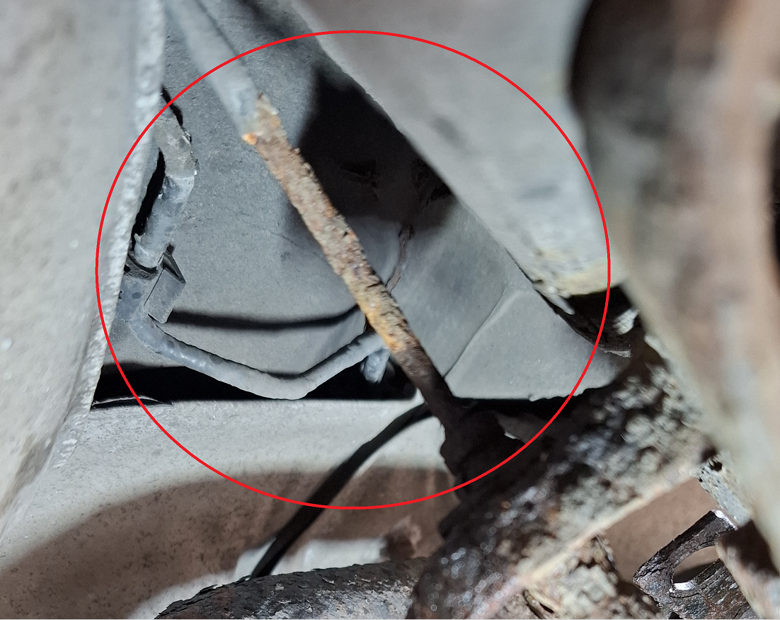

Alasdair, that's the general direction I'm heading in. Did you manage to do the job on a driveway on axle stands? I'm finding that I'm struggling to manoevre under the car, and also struggling to get the pipes free enough to be able to make a cut. It disappears up behind the fuel tank heat shield and there are 2 clips up there. It did occur to me to just cut it under the rear passenger seat area and just put a rather longer run of new pipe in. I've got the old pipe section off the back plate on the near side. The replacement part from ECP has a flexi hose piece at the piston end which took me a bit to figure out, meaning that I'm re-using the flexi piece where the rear axle pivots. Bleeding - I've had a go at bleeding, still got the main run of pipe that I need to repair but wanted to get the car mobile again. I've been at the rear nearside, so figured bleeding shouldn't be that hard. But I can't get a pedal. Even though I've only interfered with one brake at the moment, and I've got no leaks, will I have have to bleed all 4? Starting with the offside rear? Try as I might I'm nowhere at the moment. I know I'll only have to do it again anyway. Thanks. Nathan.

Thanks Mike. I had wondered about releasing enough of the pipe run to make cutting the end cleanly off possible and then figure out how to join a piece of new soft copper pipe to it to complete the run again. I'll dig into that later tonight when I'm back indoors. Mine's an '03 car. It's no so much the mileage (175k) as it is the time on the road that's done the damage. Really don't want to have to get another car this year, and want to run this one out to 2027, by which time I'll have had it a decade.

Hello readers, Addressing MOT advisories ahead of this year's test and it's the offside/nearside rear brake pipe corroded problem. I thought that was just a case of buying the new pipes from ECP and then getting after it for a weekend on the drive. That's this weekend. However, with the brake side piece of the rear left pipe removed, what I now see is in the image as I go about taking the remaining little piece of rubber link pipe out. It's pretty bad corrosion on the car side pipe run. Bad enough for me to wonder whether trying to undo the 11mm nut (soaking with WD40 at the moment) to get the rubber pipe section off might actually just twist the end of the pipe off. Has anyone been in this situation and remedied it? It looks like getting the entire pipe run out is pretty major surgery tbh. There's a lot to dismantle. Add in the corrosion I can see where the sub-frame/axle mounts to the car (another advisory) and things might be looking terminal. I really don't want to be thinking about scrapping because the car runs like a Swiss watch, but I can't go about replacing the brake side piece of pipe and connecting it up to something so corroded on the car side, only for it to then fail on the bit I've not replaced. The car side is actually worse than the bit I've taken off. Seems to be a bit of a 'mare. Anyone got any advice? Thanks for reading. Nathan (Horwich).
