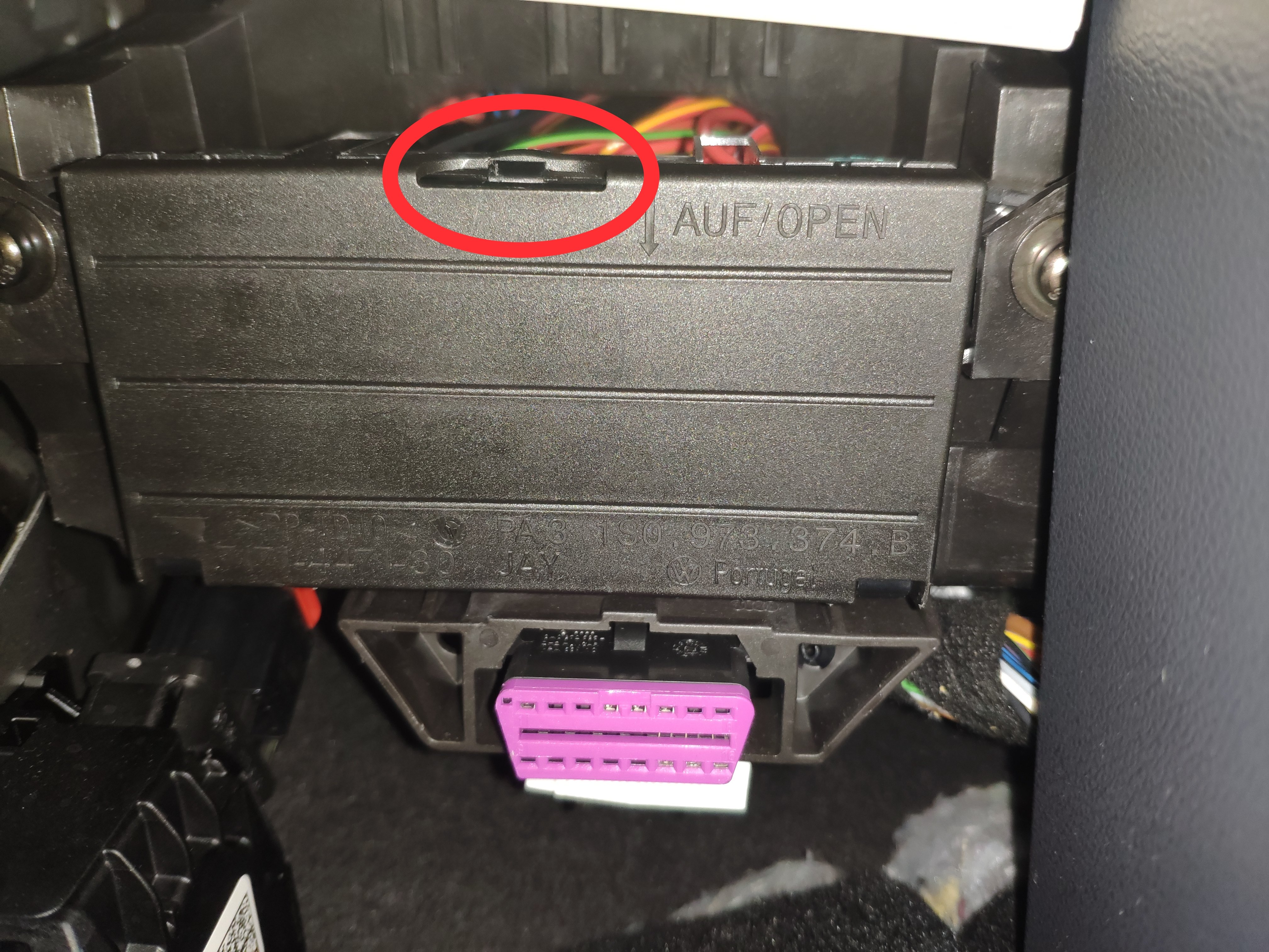

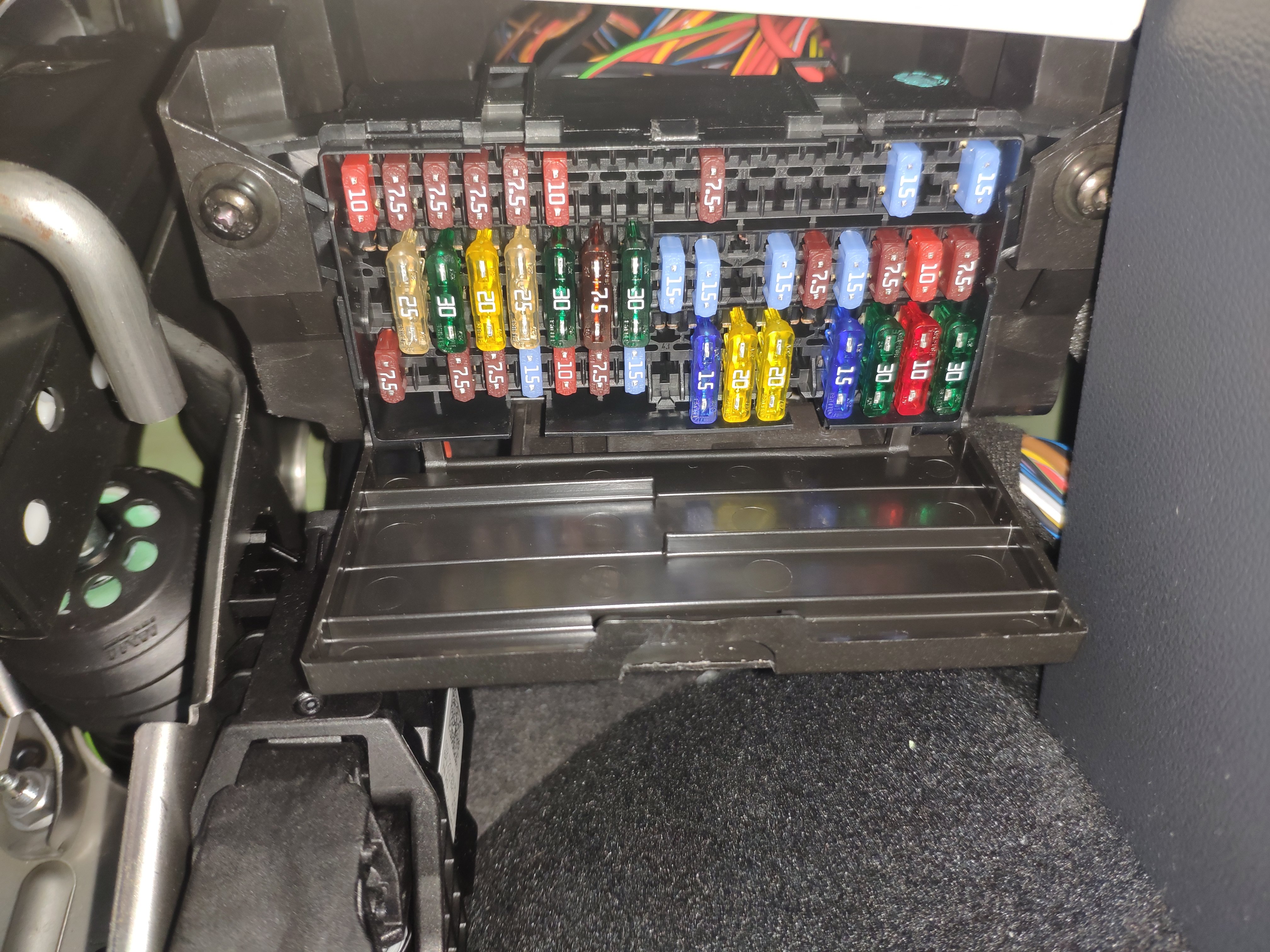

  1. Hi guys, this topic make me interested in how to get into a dashboard fuse box if I will ever need it to. So I look at it and made some pictures for others to show how to open. You will need small flat screwdriver to unlock securing tab located on top in the middle. When you manage this, than lid will open down and can be removed completely. After that you can remove white bracket clip for fuses removal, located on bottom behind fuse box. Access to this box is pretty terrible, so I wish you good luck. I managed to open and surprisingly it looks like almost half of fuses are missing. For example no. 47 witch is air blower for air conditioning/heating is not there, like many others. Does anyone know why is that and can some of you check on yours and post picture to compare? I have 2017 SE-L, so there may be some differences between trims

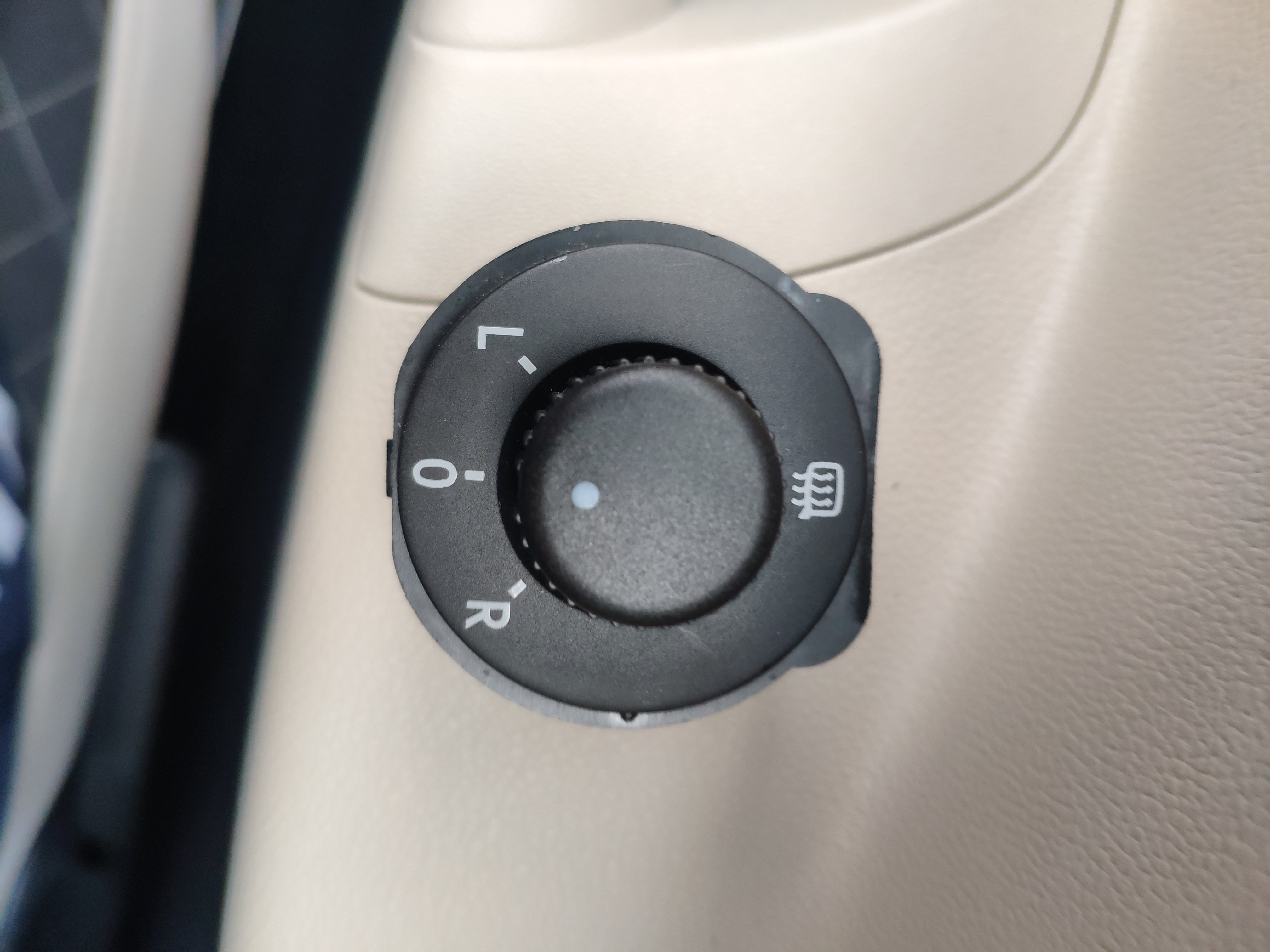

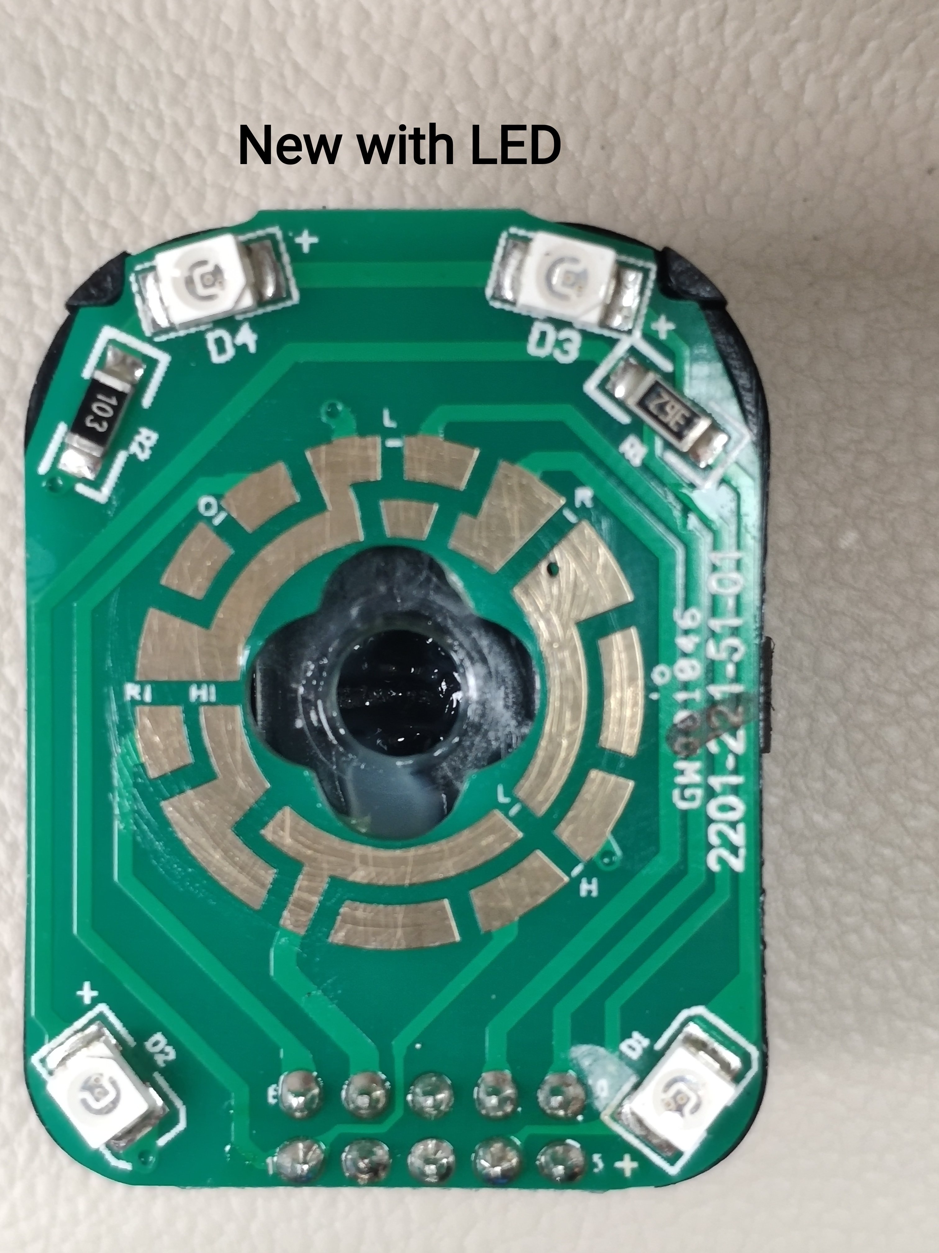

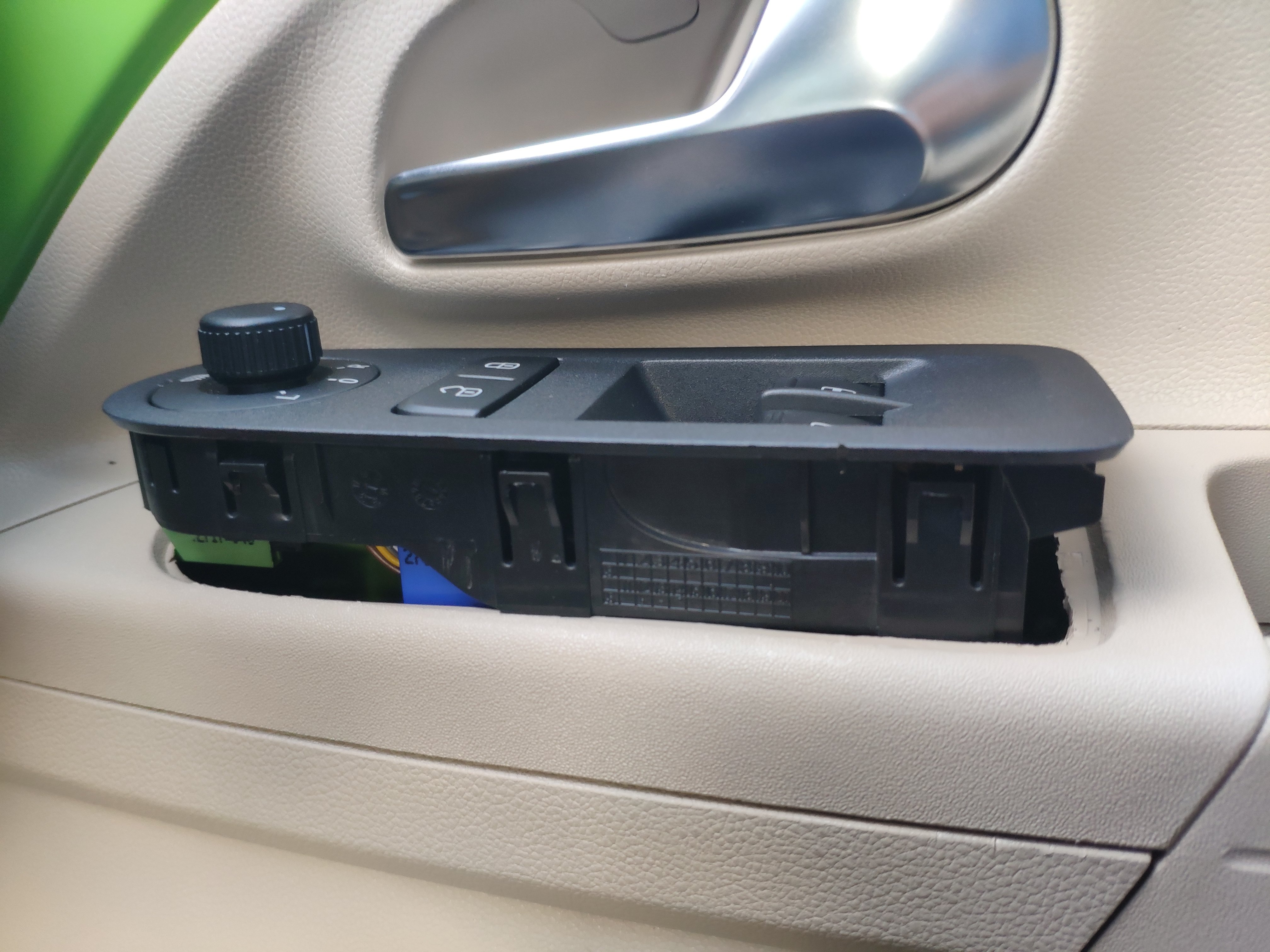

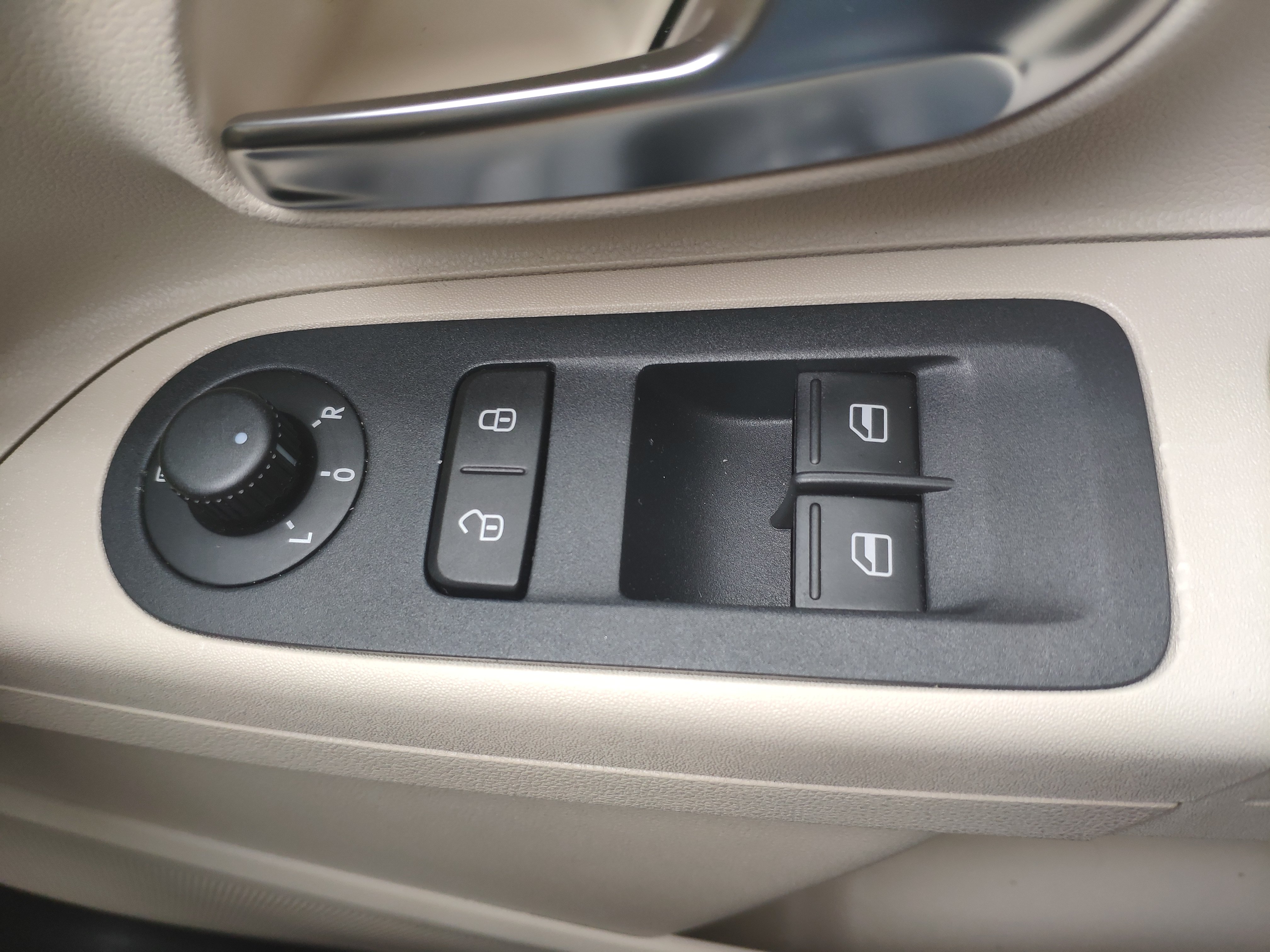

  2. I did try to plug it in today but LED didn't work, so I'm giving up on these. I don't know if it's just faulty or cheap Chinese item. Most likely it's me, not good enough, to make it work as I'm not an electrician 😉
