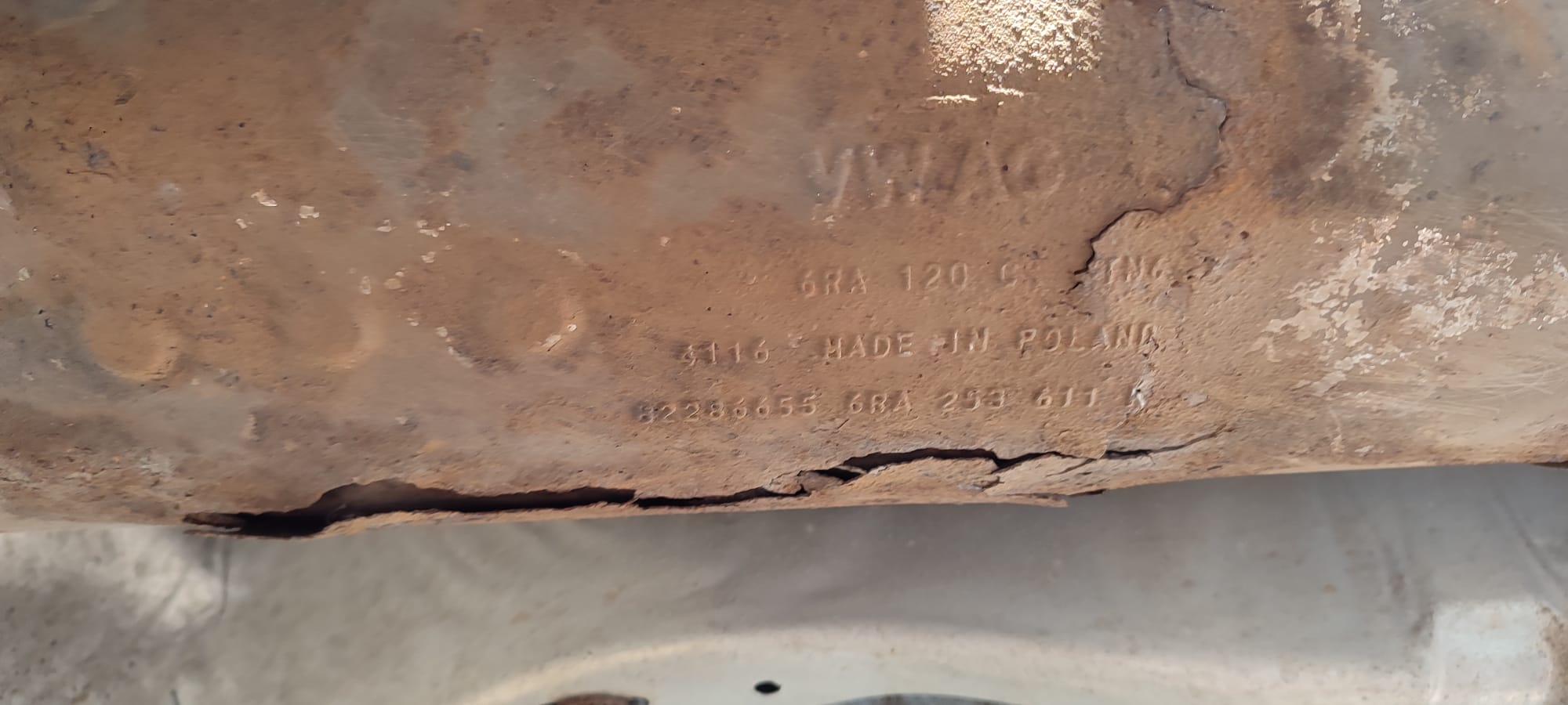

  2. Just had a chat with the local skoda dealers and they've told me the part number is 6RA 253 609 AA, so now need to find it
  3. Managed to get a pic of the numbers, looks like a K but no A before it? any ideas.

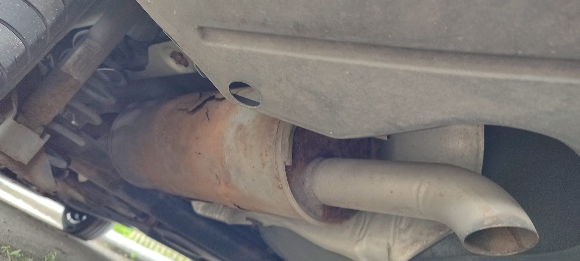

  4. This is the version of my rapid 66kw CJZC, https://www.car.info/en-se/skoda/rapid/rapid-12-tsi-m5-2016-24190184/specs And by pops, it sounds like popping when the car is running so leaking exhaust from the holes in it and not just from the tip.

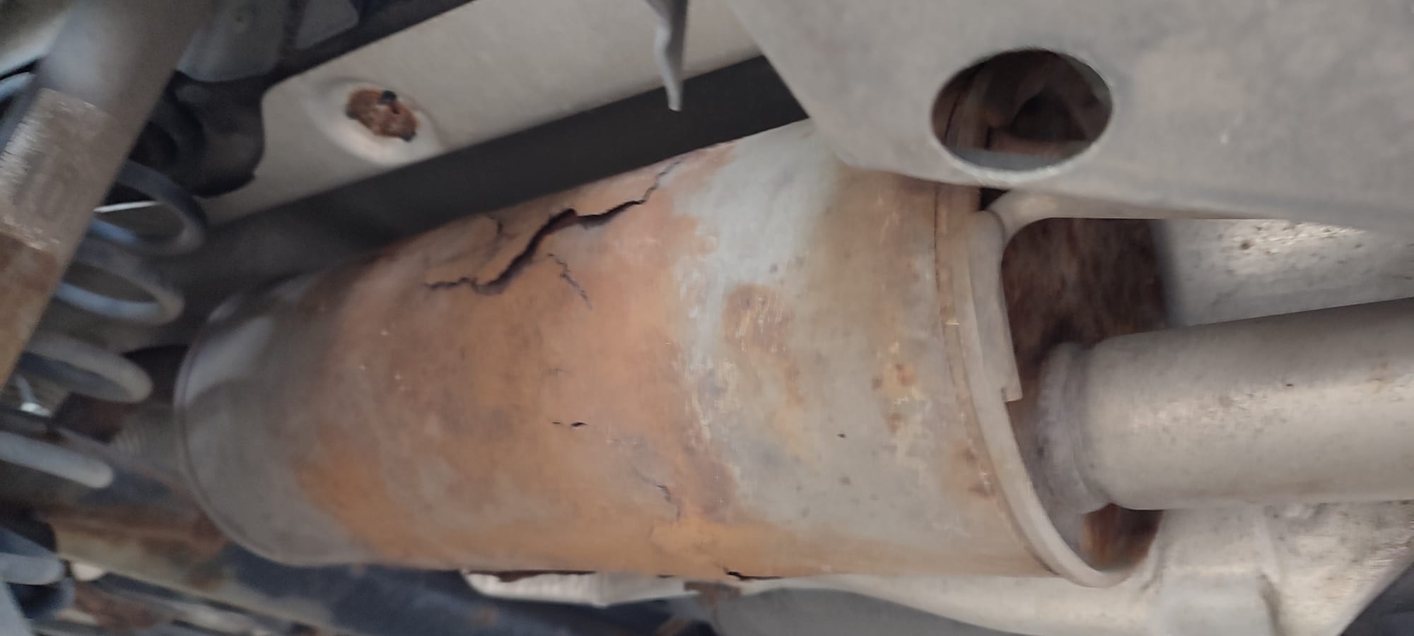

  5. Yeah there's more damage on the bottom and the other side and it pops when the car is running.
