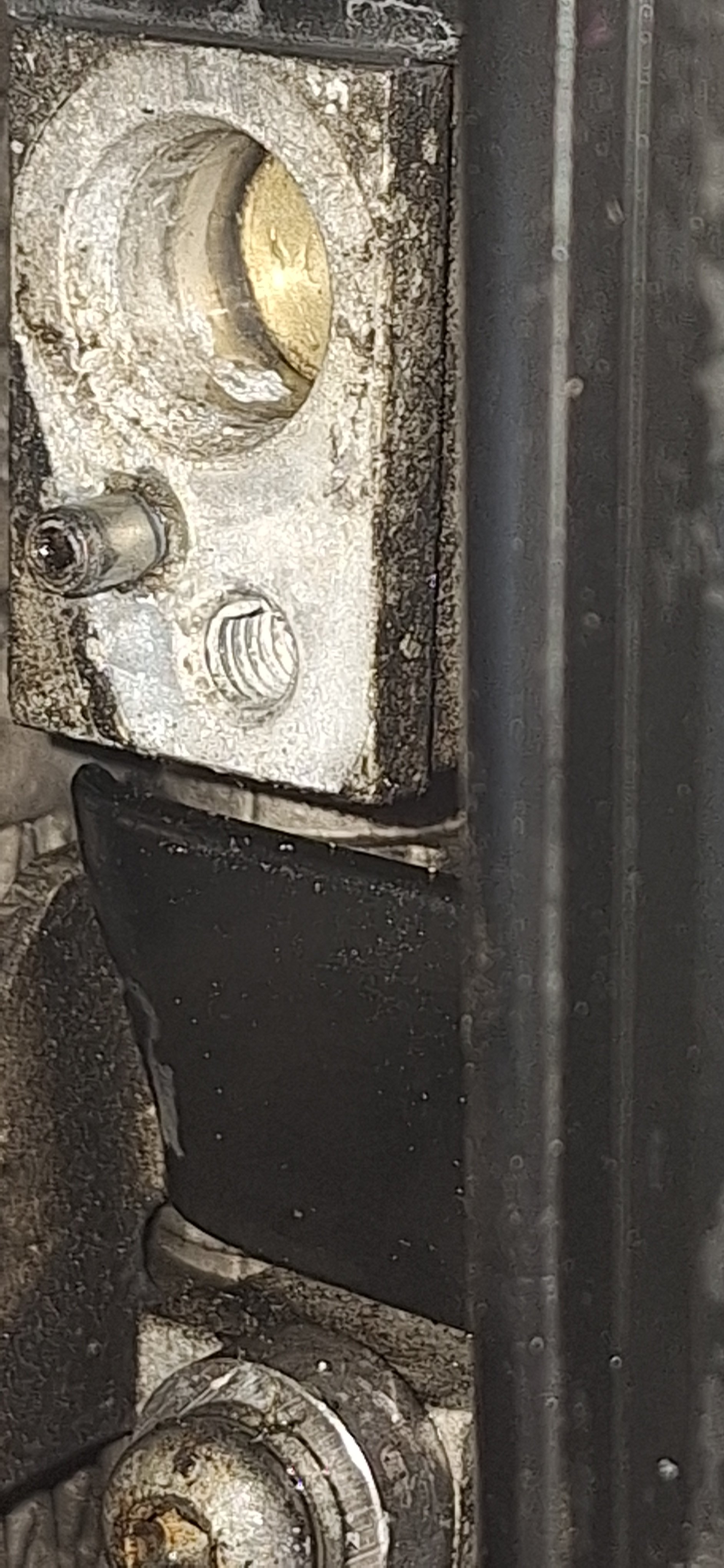

  4. The garage who gassed it I worked for in the past so I got it at trade rate but still much more expensive than the older gas in the last car they did. I seem to buy cars with air con faults

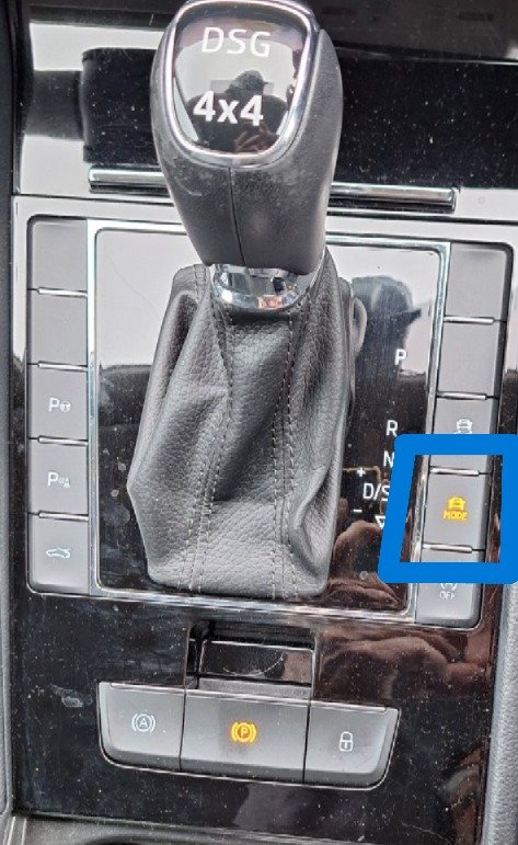

  7. Old topic but link not working anybody got a up to date link for the TSB ?
  8. Thank you. Its in eco ATM I will try Normal next time I go out in it
