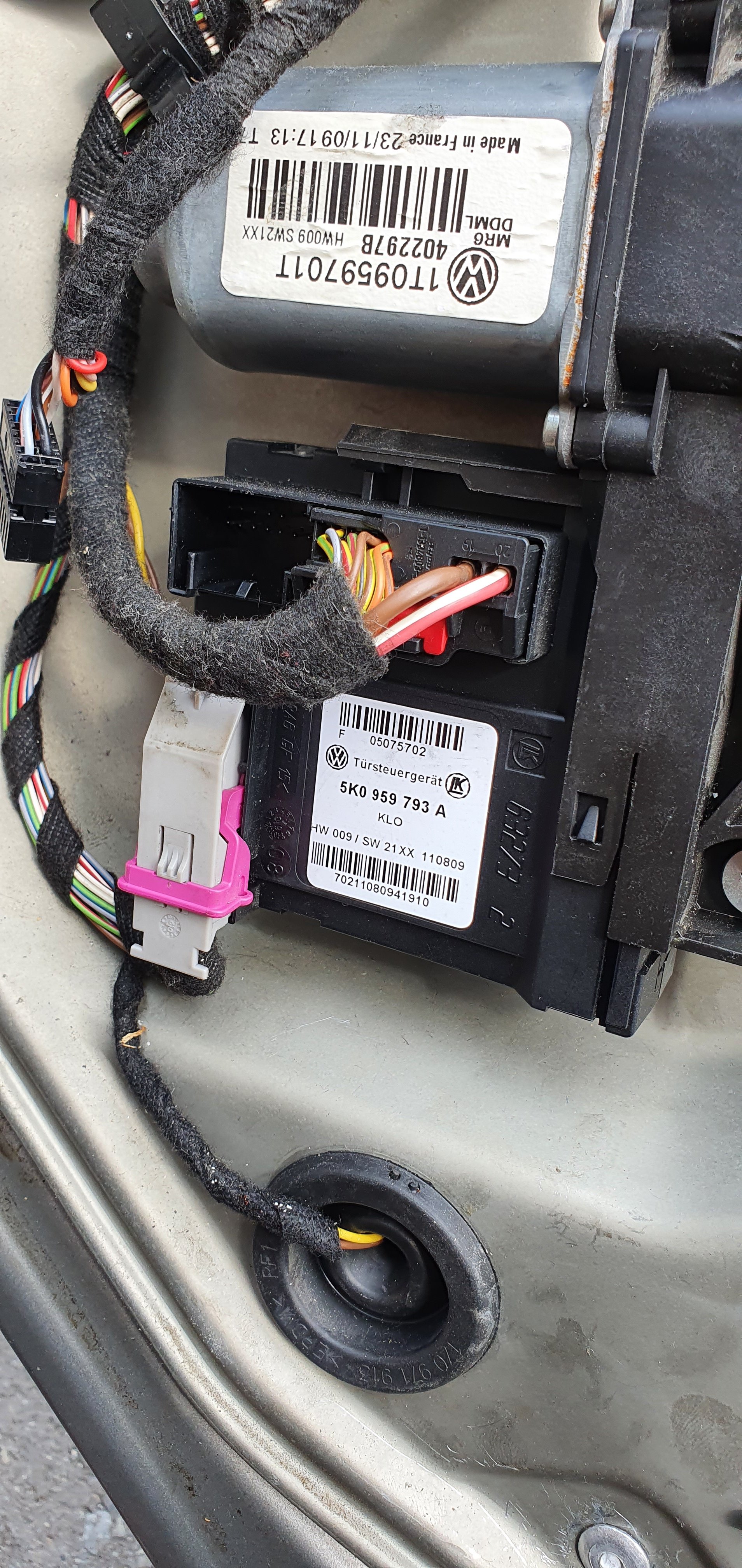

  2. Hello. I already retroffited folding mirror with puddle lights for o2 facelift, everything works fine, only the puddle light from driver door doesnt work if the mirrors are folded. On the passager works. I have a friend who can edit eeprom but he dont know what need to modify. The picture is for door passager.
