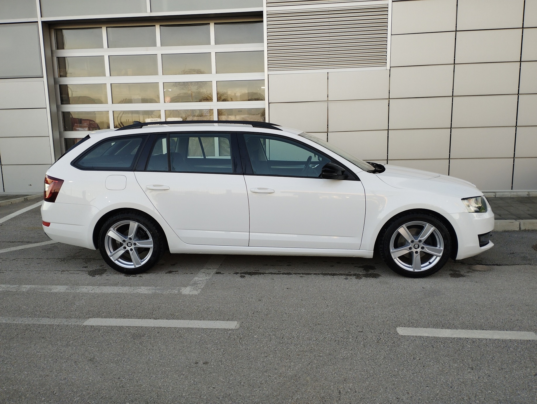

  1. Good evening. Roof rails for SW/Combi can be retrofitted. You need 4 metal supports for rails (5E9817905, 5E9817906, 5E9817421, 5E9817422) and a way to bond them to roof side support, since they are spot welded to roof strengthening profile from the factory. Also of course you need roof rails, and a lot of interior bits dismantling ... I've done it, but i used metal bonding glue and sealant for supports. The tricky part is drilling through the roof of the car; at least the first hole. I've done it by myself, and don't know of any other attempt personally, i've found a few topics on drive2.com with other one or two examples of retrofit. But it can be done.
