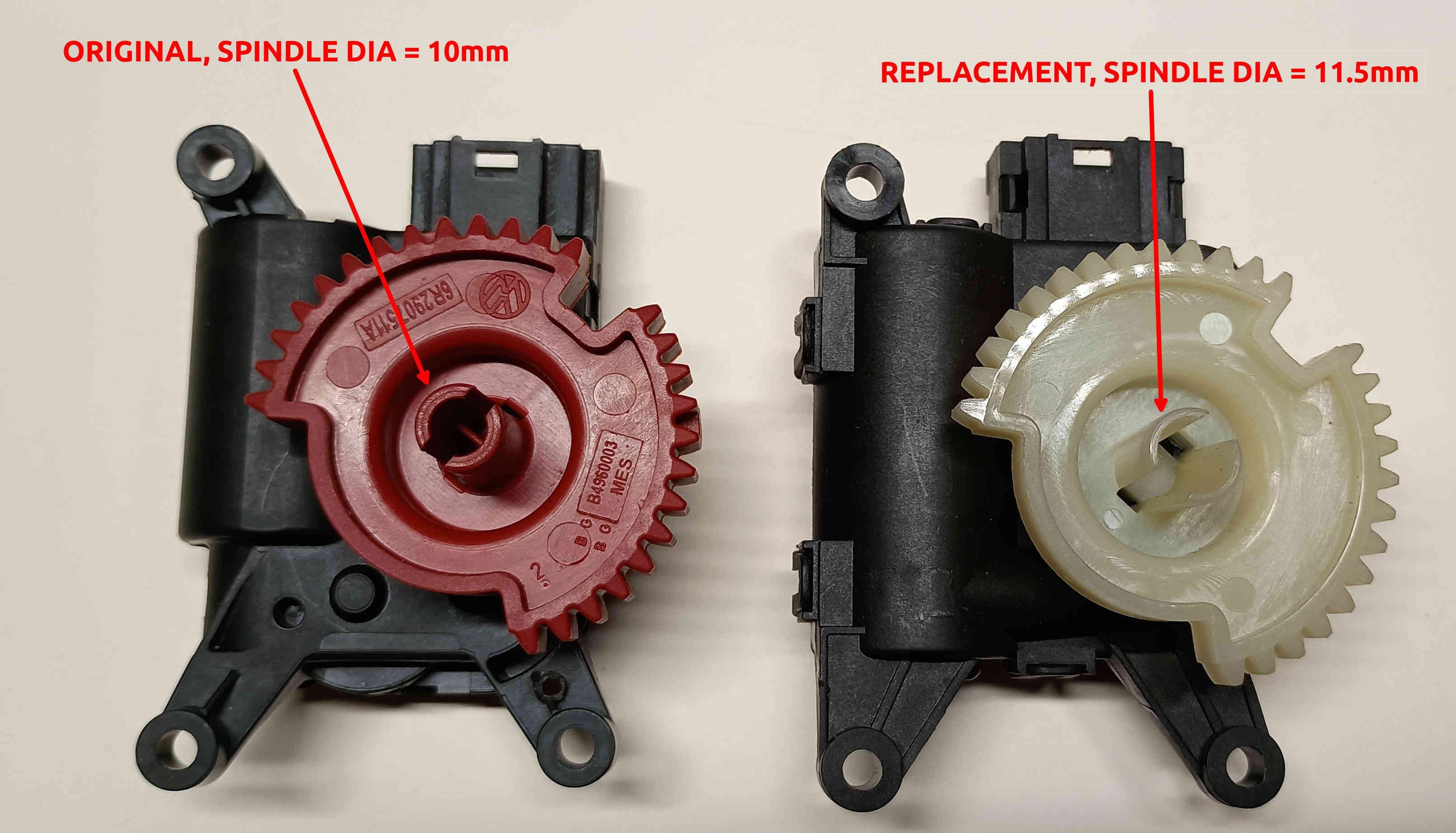

  1. That's all very well, but then you won't be able to test the operation of the motor before reassembly. And getting it back in is so fiddly that you really want to make sure it's working before doing so.
  2. Follow-up... Decided to give it one last go, and tried AGFalco's cable tie fix to reuse the original motor. This time it did go back in, so my guess is that it was the slightly too large spindle on the cheap replacement that was preventing it locating. I don't think the cog wheels are perfectly aligned as there's a single quiet "thud" as it operates. But the whole setup is so fiddly to get at that I doubt taking it out again and trying to relocate things is likely to be successful. In any case, recirculation appears to be working, as the fan gets noticably louder when in recirculation mode. For anyone else attempting to fix this issue, be wary of cheap 3rd party motors. Probably best to use AGFalco's cable-tie method. Remains to be seen how long it lasts, of course.
  3. The flaps are opened/closed by other cog wheels that engage with the cog wheel on the motor. The "spindle" I'm referring to is just the axle of the cog wheel. It certainly doesn't operate the recirculation flaps. PS. I don't have climate control. The heating/aircon in my Fabia is manual.
  4. I don't think the spindle is there to drive anything. The cog wheel moves the recirculation flaps. Can't think what else needs to be driven. I opened up the replacement motor and it's a completely different design inside, so the cog wheel can't be swapped over. I'm pretty much done with this. I can live with a car that has no working recirculation.
  5. Thanks for your comments. Although the motor casing is slightly different, the three locating lugs are in the right place to fit the cradle. As far as I can tell the only part of the motor that touches the rest of the car is the cog wheel, so the casing shape being slightly different shouldn't be relevant. The thing I'm interested about is if anyone knows whether the spindle needs to go into a locating hole. As I said, I think I can feel such a hole, but have no idea if it's for the cog wheel spindle.
  6. The new motor arrived today. I tested it before attempting installation and it worked. But then the fun started. Well, it wasn't fun. After about 2 hours of struggle, I gave up. Getting the damn thing back in place was impossible for me. You can't really see what's going on and have to try and do it by feel. Then I spotted something. The spindle on the new motor is a bit wider than the original: I *think* I could feel some kind of locating hole which might possibly be where the spindle should go. Is it possible that the slightly bigger spindle was preventing the motor being able to be seated in place?
