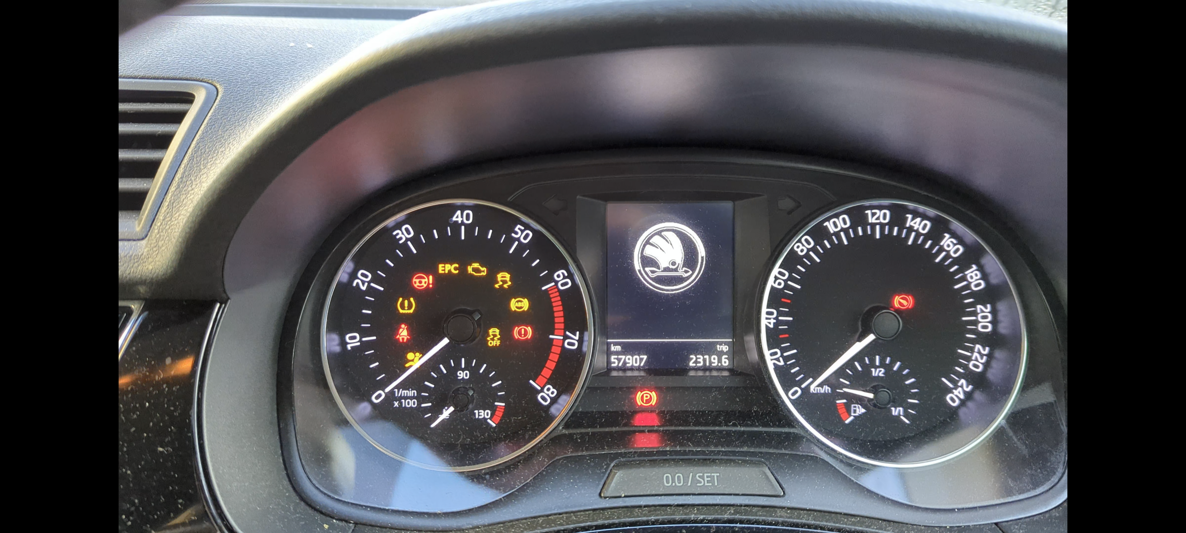

  6. Thanks for all of the suggestions/info. Latest update is I checked the oil level this morning after letting the engine get up to operating temp and then giving it 5 mins after turning off before checking. Oil level was just over half-way on the marked section A (see pics). According to the manual the oil needs to be topped up if it drops below the A section, so it wasn't below that area but it wasn't at the top either. I've also attached a pic of the lights after turning ignition on. They all go out either after a few seconds or after engine is switched on. I drove to the other mechanic this morning and noticed that when I got to 50km/h, I couldn't hear the noise anymore. It's noticeable at idle to 30km then drops off. The car seems to drive completely fine and I wouldn't know there was any issue but for the noise. I have a slim glimmer of hope all is not lost, the mechanic said that it'll be a few days before they get to work on it but his initial thoughts were it's not the bearings as he said that bearing knocking is usually more a metallic sounding knocking. To me, mine sounds more like something hitting off plastic but what do I know! I'll update when I hear from the mechanic next 🤞
