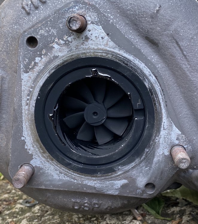

  6. I have a hardpipe kit with silicones all over including the air box to TIP (only because original one no longer fitted.) I left it a while to see what would happen, mainly if the issue got worse or reoccurred. Surprise surprise it came back in full force, bad idle and all! I didn’t want to pull the injectors off myself within the correct tool so decided to try and get in into a local garage that could but had to wait over a week. So I pulled the turbo off to check it over and sure enough there was oil all swirled about. Shame as turbo hasn’t even been fitted a year, I guess it was a dud but it was sat around too long to be under warranty now. Once it’s running again I can see how the idle goes but I suspect it was turbo related as well.
