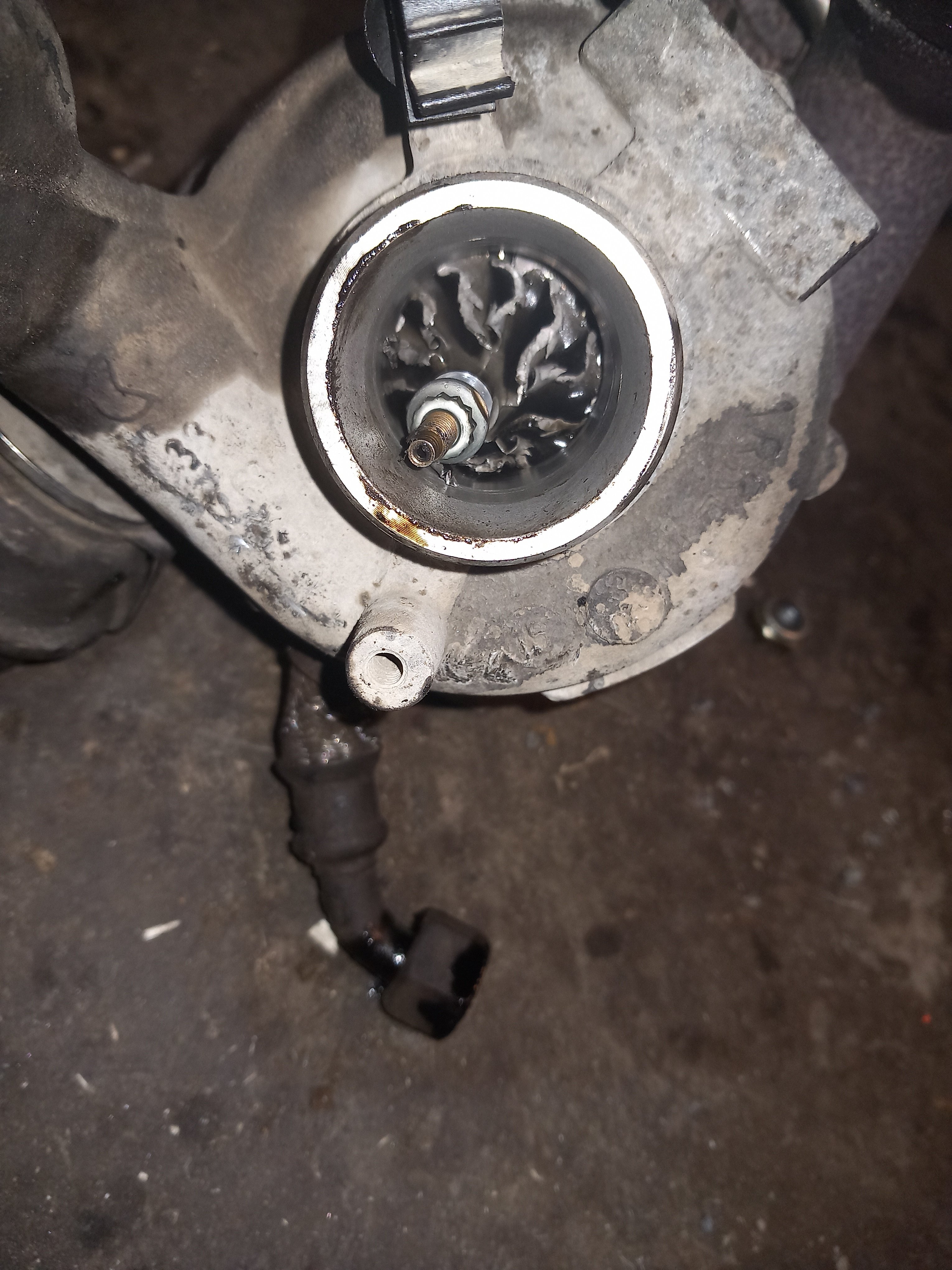

Hi again Today was my day for the dreadded job and oh boy! I got the Turbo out, installing the other one tomorrow. i did pretty much the same as Jakubini. I removed the right wheel and drive shaft. I didnt remove the battery tray or the engine mount, on my car, i guess since i have no DPF it wasnt really needed to pull the engine forward any. My biggest problem was someone apperently had the intake out at some point and the unbrako /six points for one of the oil pipe return was rounded off, so no way in hell to get them out easily, so instead i had to remove the entire cooler thingy or whatever it is that covers the intake bolts. Once i got that knucklebusting job done, it was fairly straight forward removing the exhaust manifold thankfully and got the turbo out. Broke the oil feed line, no way of getting it lose from the nut,the pipe itself twisted around, so i ended up cutting the pipe to get the nut off. Used 7 hours total including a few breaks and im guessing at least 3 or 4 of them was spent on messing around with the intake. There was a LOT of oil on both sides of the intercooler in the hoses/pipes, however the intercooler itself looks fairly clean as far as i can see. Going to try flush it where it sits with break cleaner tomorrow and see what comes out. Heres a picture of my turbo, and theres no bearing left.

Good job man, thats great to hear. Did u flush ur intercooler? if so im intrested to know how u did it and what u used to flush it with
