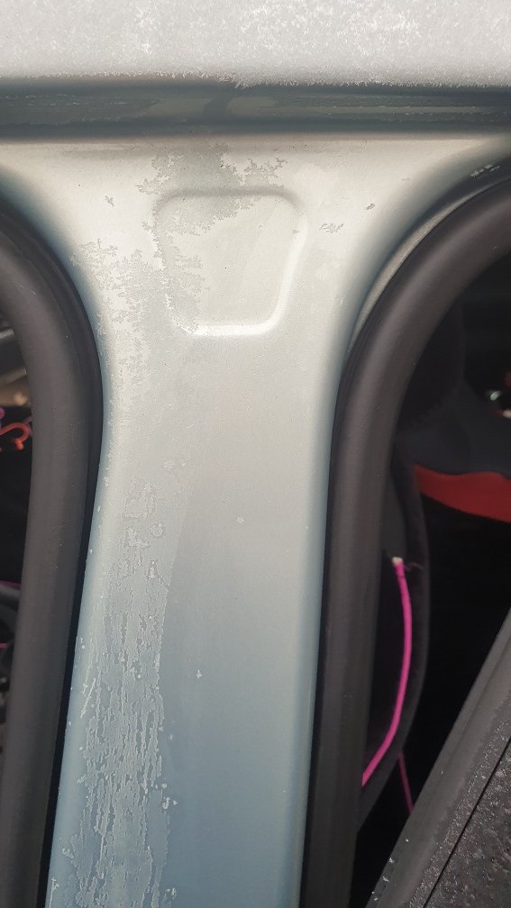

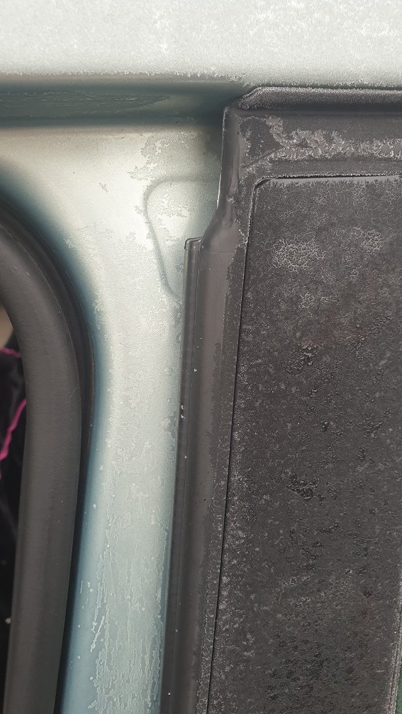

Water in spare wheel compartment / light bulb warning / roof door

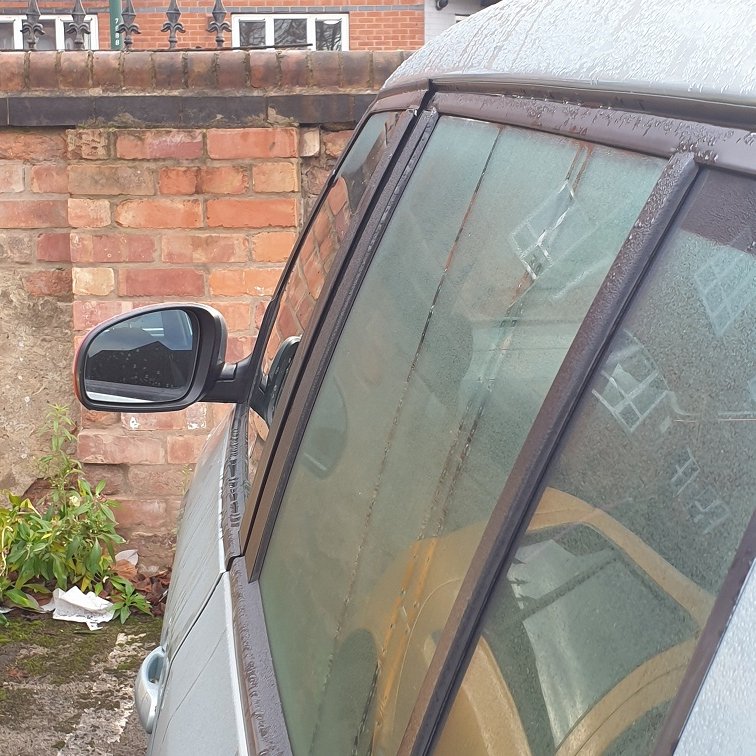

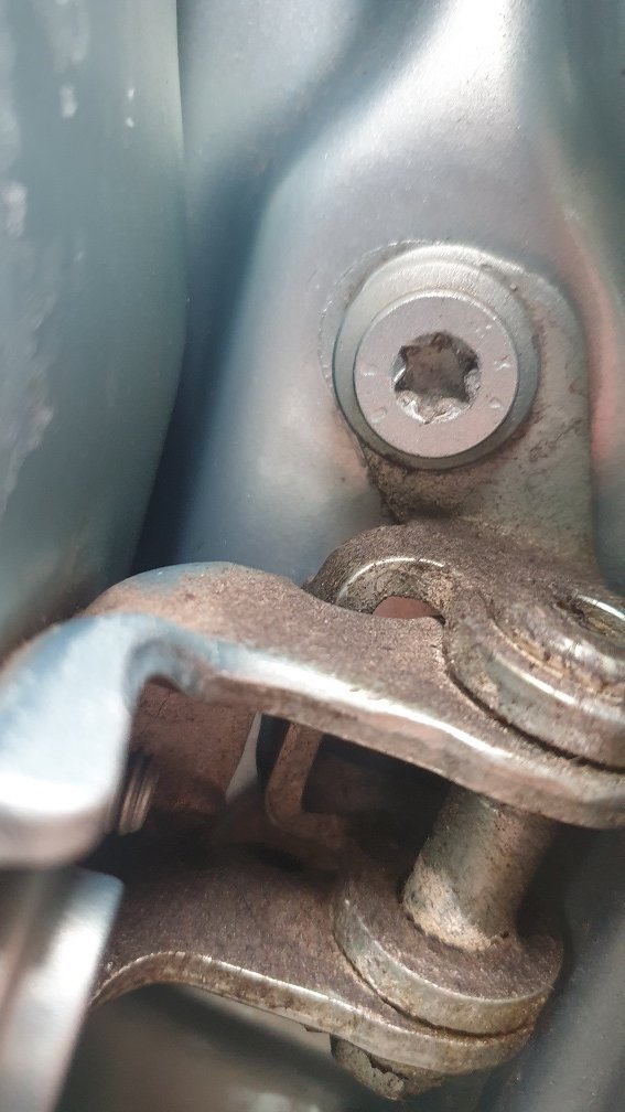

Photos: A cold morning helped me look to see if there is any moisture leaking through the door seals. All looked good except this corner, in front of the offending door: Here you can see hinge has some signs of sliding, in the direction which means the door is pushed further in. This is the top hinge. The bottom hinge has no mark that I could see, but while the top of the door (window) is pushed in, the bottom of the door sticks out a bit. I thought I took a photo of how it looks now, but clearly I havne't. So might come back with a photo.

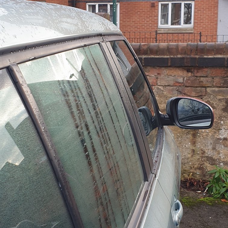

Okay so a bit of a catch up. May upload photos but here's a run down. The near side rear door is off. The other three are true. In the pictures it shows you how it seems to be pushed further in. The hinges bolts on that door are clearly tampered with, and there seems to be a bit of a "slide" marks in positioning at the hinge. The roof seal of the rear door looks much shorter only becasue it's pressed in. The seal is squeezed under the roof. I've loosened the bolts and tried positioning it better, and retightened. It is slightly imporved but still not perfect. I don't know if there is an art to getting this right. I can get the top to align, but the bottom sticks out. If I open the door, I can move it in an out on the hinge further, but when closed, which is the position I need to tighten the bolts, it's about fitted as much as I can push it in near the bottom, or out near the top. I have no one who trusts me enough to go into the trunk of a car. haha. But anyway, I might do what the video in the other post did and undo the rear bumper and check those channels. Silicone sealant, then? In other news, I've replaced the fan blower resistor so I can have the fan blowing on 1, 2 and 3 (healps clear the windshield without the noise of 4), and lo and behold, Start/Stop suddenly works?!!! I'm guessing something to do with the system resetting due to having the battery disconnected, possibly. But the light bulb dash light is still there.

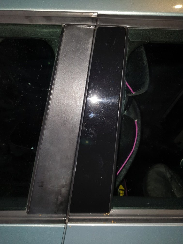

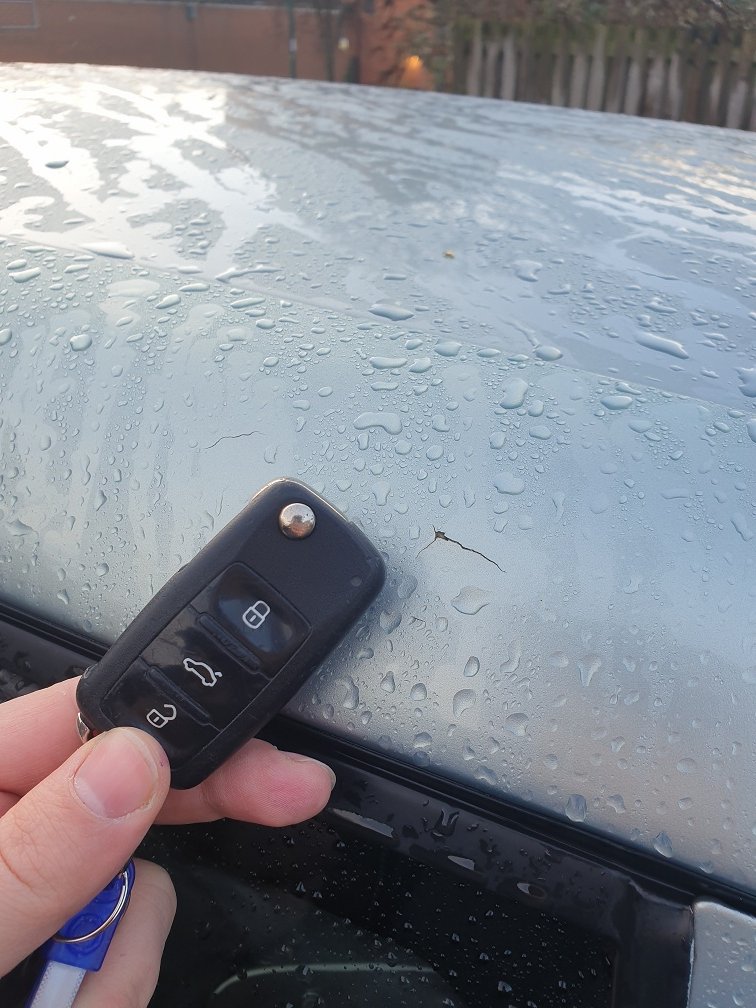

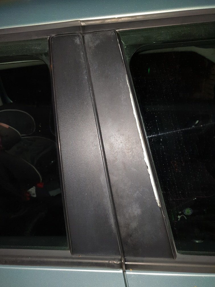

First off, a quick thank you to everyoen who helped me in my first thread. Second, my 2011 Fabia Greenline II 1.2 TDI CR still has a couple issues I've discovered while doing the maintenance relating to the previous topic. First small problem: there is a light bulb warning light on the dashboard that's always on, but all light bulbs I've found in the car, outside, inside, and in the boot, seem to be ok. There are no codes. Any ideas? Second, The car has had S-Structrual Damage category in its history, marked as "damage to roof" but I could only find a small crack to what might just be paint on the roof, or is that the metal sheet? But then there is an issue I dicovered later. The left side rear door seal dosn't seem to fit just right, and one window frame column is actually different (polished finish as opopsed to matte finish compared to other right side door. I missed it at first, but using the flash light at night made it appear quite clearly.) so maybe the door is off, or the roof is. And when it rained, I checked under the boot, where the spare wheel is, and surely there was a bit of water accumulating in the corner. There are no signs inside the car of water leak having caused any marks in the past, and so far there is no rust that I can see. But I don't want either of these two things to happen, and surely the car mists a lot inside. A. Lot. So, I'll attach photos of the damage I found, and ask your opinion. Is it the roof, door or the column? And what should I do? Replace the door? not worry about it? Is the crack on the roof just paint or metal? Any insight helps.
