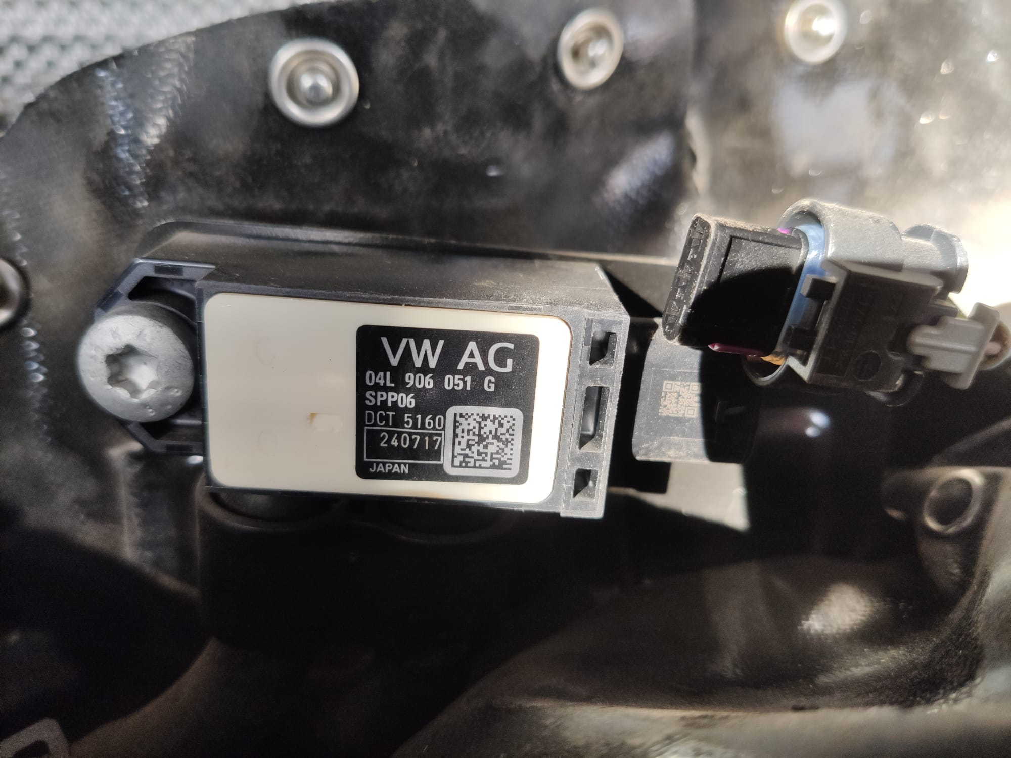

  1. changed the sensor, error is gone. particle filter soot mass measured is 4.5g and soot mass calculated is 22g. should i force a regen ? if yes what type, standing or while driving ?
  2. is Low pressure EGR differential sensor adaptation (that is the one I have in obdeleven) same as the one in my error? Sorry for so many replays.

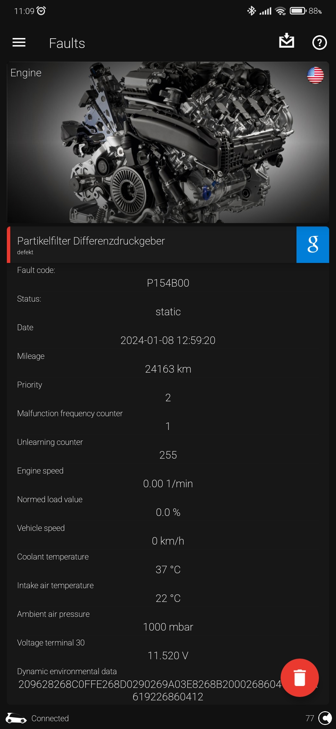

  3. For VCDS I found some instructions on how to do it but for obdeleven are outdated and I don't have those. Can this be done in manual way?
  4. I laso had exhaust gas recirculation B control (stuck closed) but is gone for now.
  5. Hello guys. This summer I had one itermittent P2626 fault code of bank 1 sensor 1 and this P154B00 parktikelfilter differenzdruckgeber. I erased these faults with obdeleven but now only P154B00 is showing. Having a boy with autism I really need the car and I can't leave it to a service for who knows how long and I'm good with tools. The car is from 2017, new, strange that I have these errors for a car sitting in my garage. I already ordered the sensor but after changing it, I have to do recalibration in obdeleven right? And after that force a dpf regen? Any insight about this error ?
