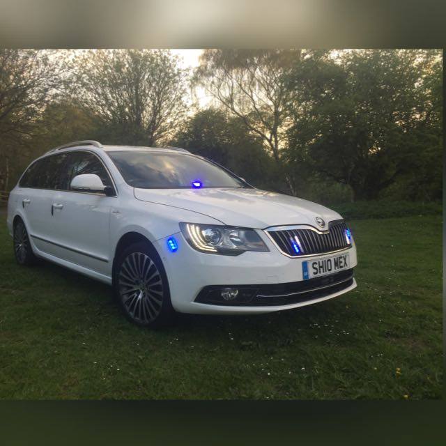

  3. This is my headlight which is different to the one linked would it still be the same issue?
