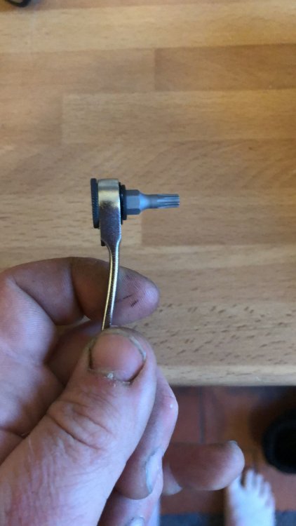

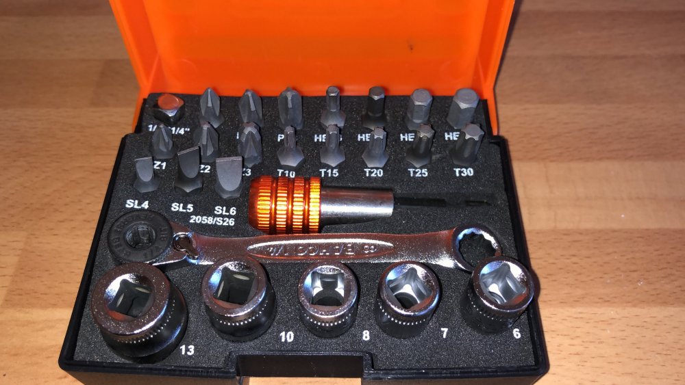

A mate recommended me one of these kits: Bahco BAH2058S26 . This is literally a LIFESAVER for this job! I cannot recommend it enough. Without it, I doubt I'd of been able to get mine fixed. It's also wothwhile ordering some spare T30 Torx bits and 4mm allen key bits, as you will need to "adjust" them as below.

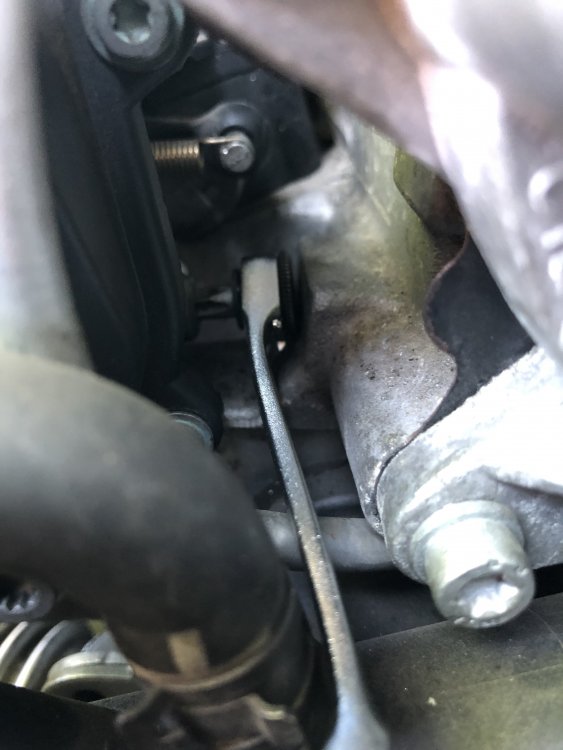

Once the kit arrived, the bits were still too long to fit down the back of my engine. So I took an angle grinder to them and made them stupidly stubby. They're still usable afterwards, but they do end up tiny. So grind them down to fit, its a fair bit you need to remove. You can see in the photo with a bit in the tool, thats the normal length, and in the one with it down the back of the engine how much I had shortened it.

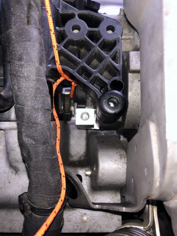

Grab yourself a bit of string / cord / cable tie. Make a loop in the end of it and feed it between the manifold and the motor from below. Use a pair of needle nose pliers to grab it behind the motor and feed it on the actuator arm. Now, put a finger behind the actuator arm, push it as far forward as you can, then pull on the string forward to get it as far as possible forward (towards front of car). Then tie it off to something out the way. (I used a coolant return metal pipe on the front of the engine).
Now grab your tiny Bahco tool and your ground down T30 bit. You can fit it between the motor and the engine from the side where the air box was. Its a fiddle, but not impossible. Ratchet away and give yourself more thread than you think on the bolt. I just wound it until my tool bottom out on the engine.
Feed your repair bracket in from below (manifold to motor gap at front). Feed it through so the hook mount points almost up to the sky, so you can slide the bracket in sideways to where it needs to sit. This is extremely fiddly, time consuming, upsetting and finger burning if your engines been running! I'd give yourself atleast an hour or two to get it sat right.
I didn't manage to take any photos of this as I was fixing it by myself with all this COVID stuff going on, but the bracket needs to fit as close to the motor as you can get it. According to the instructions X8R give you online, they say the bracket should sit flush to it and be upright along the square edge. And whilst you're doing this, you can't see what you're doing, and you'll be going "Yeah right". The best way to do this is get the hook over the bolt you've un-wound, then you've got a bit of security that the brackets somewhere near where it needs to be. Grab your 4mm allen key bit and loosen off the hex bolt which mounts the mount bit to the repair bracket. This helps you be able to manipulate the bracket better.
the bracket needs to be straight upright. It locates onto a casting on the motor, which helpfully you can't actually see. An camera phone is actually really helpful as you can get an idea of what you need to do. When the brackets in place (or where you think it needs to be), start doing up the T30 bolt whilst keeping your fingers on the bracket from the front to keep it upright. This is a fiddle, and mine took 10+ times to actually be in the right place. IF you feel the bracket "twist" as you do it up, it's probably not quite right.

Release your bit of string, and if it's like mine, it'll stay right forward. Give it a gentle push towards the engine to help set it.
