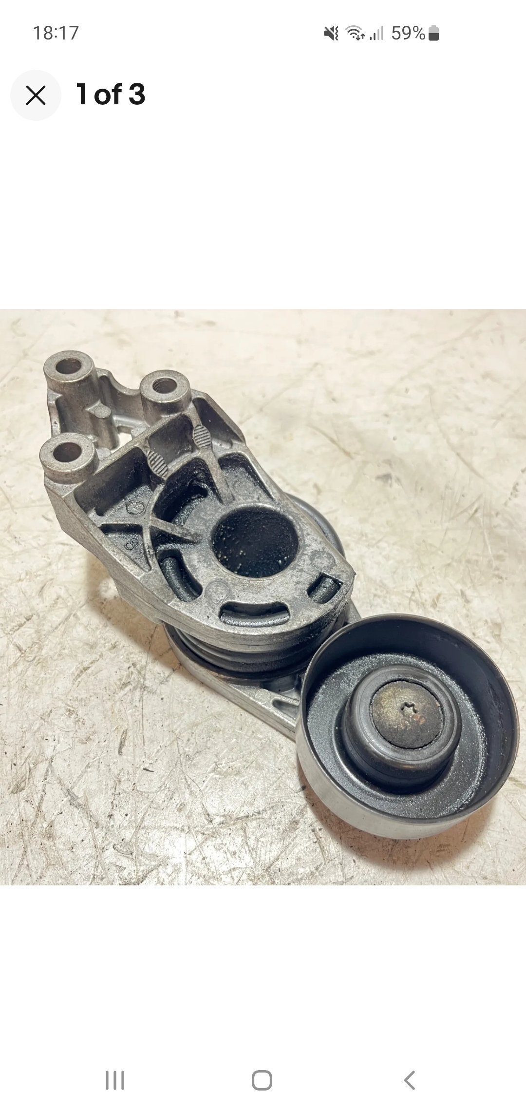

  1. Hi I've got 2 questions for you knowledgable lot. Question 1, I've got a 1.4pd that's just clocked 100k and there is a quiet squeaking at idle after start up and I think it's the aux tensioner roller. I squirted some wd 40 on the centre of the pulley and the squeak went away. Having looked at the tensioner assembly it looks ike the pulley will come off by removing a torx bolt - see picture attached. Does anyone know if the pulley is available as a seperate part or maybe even I could just replace the bearings in the puley? 2nd question, any recommendations for a good quality rear silencer, mine was given an advisory in January on the MOT. Thanks
