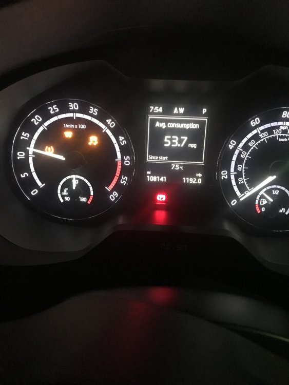

  7. It does that now and again it usually sits at 75 it done it just before after 50 miles I tried to restart car usually goes this time it stayed and engine light was on aswell I’m going to garage now see what they say thanks

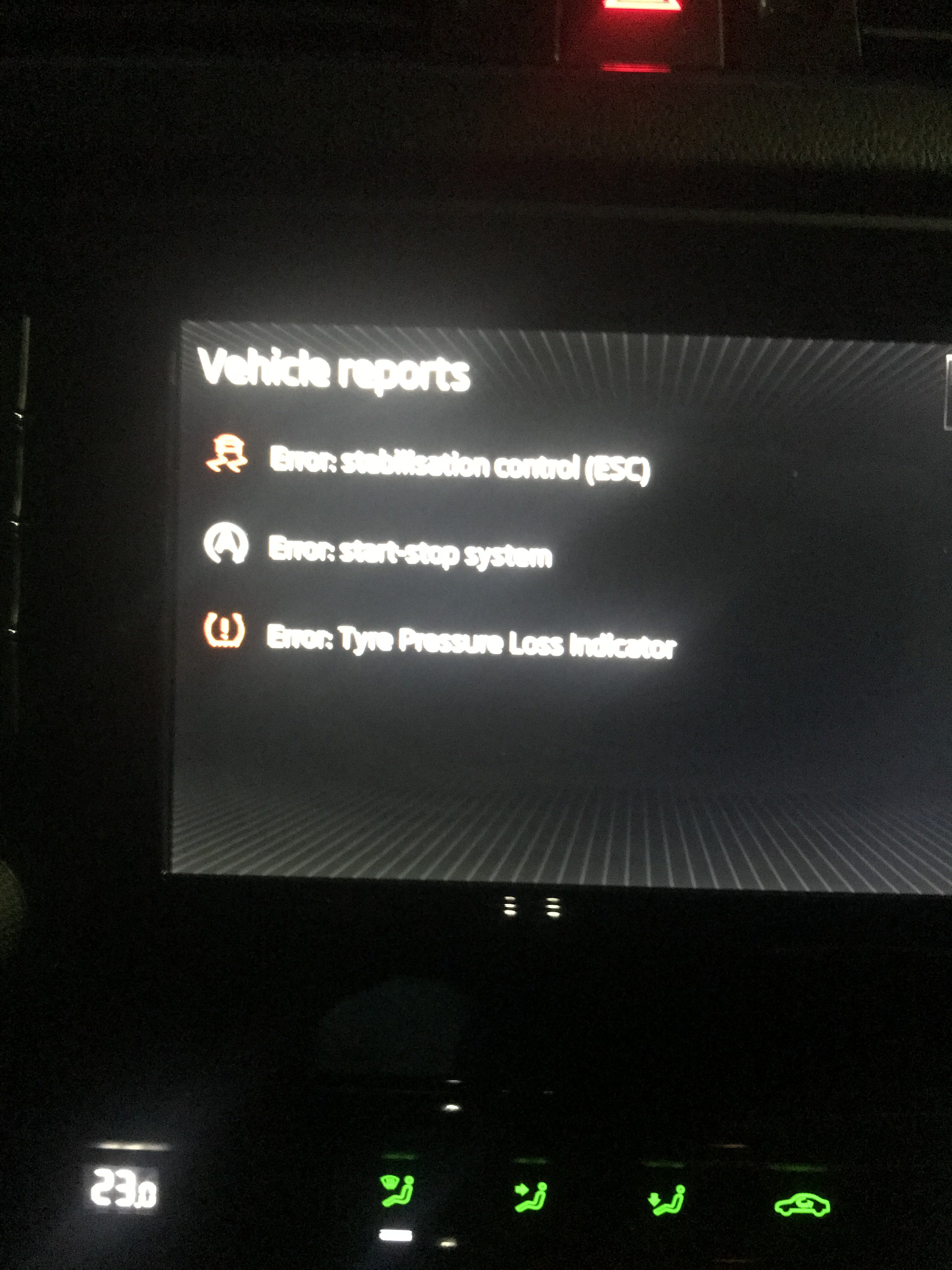

  9. Had this car for 6 weeks put new stop start battery on.when it rained I get a esc message on dash no stop start and tyre sensor not detected and glow plug light all flashing had service today and keeps happening mechanic said it was to do with service there all connected will a tyre sensor cause this and why would the glow plug light flash thanks
  10. Halfords been installed new 096 agm battery runs perfect now charger unplugged also only fault I found is p173400 it seems to be a micro switch not sure I do 500 to 1000 miles a week so I’ll check after every shift so far so good

  12. 096 agm battery from Halfords fitted tomorrow they can check codes car had no power when I bought it should of realised battery was put on new it’s a banner 72 ah not for stop start hopefully that’s the problem also probably has a drain to be flat
