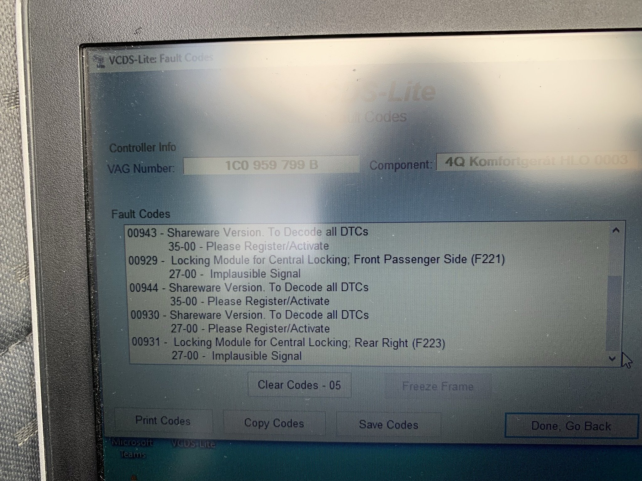

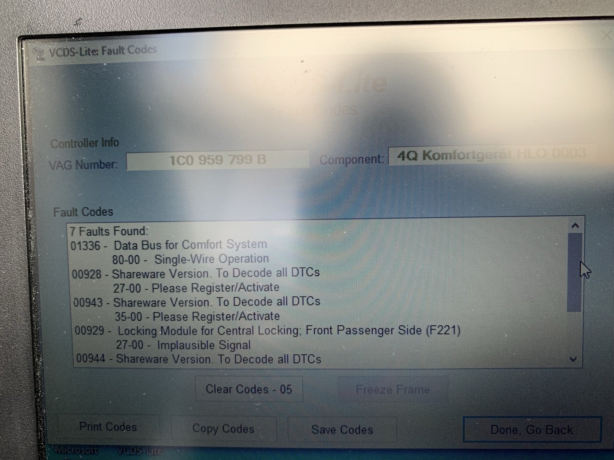

  1. It looks like the three door locks are in emergency locked postion and they are not released. Any idea? Driver door wires are checked, no broken wires. Sombody said may be one of the three door lock is faulty or the wire, contacts going to them are faulty. But how can we found it? There are no more fault codes in the door lock system, that I had before: 01336 80-00 Single-wire operation, 00929 - 27-00 Implausible Signal - Front passenger side (F221), Rear right (F223),
